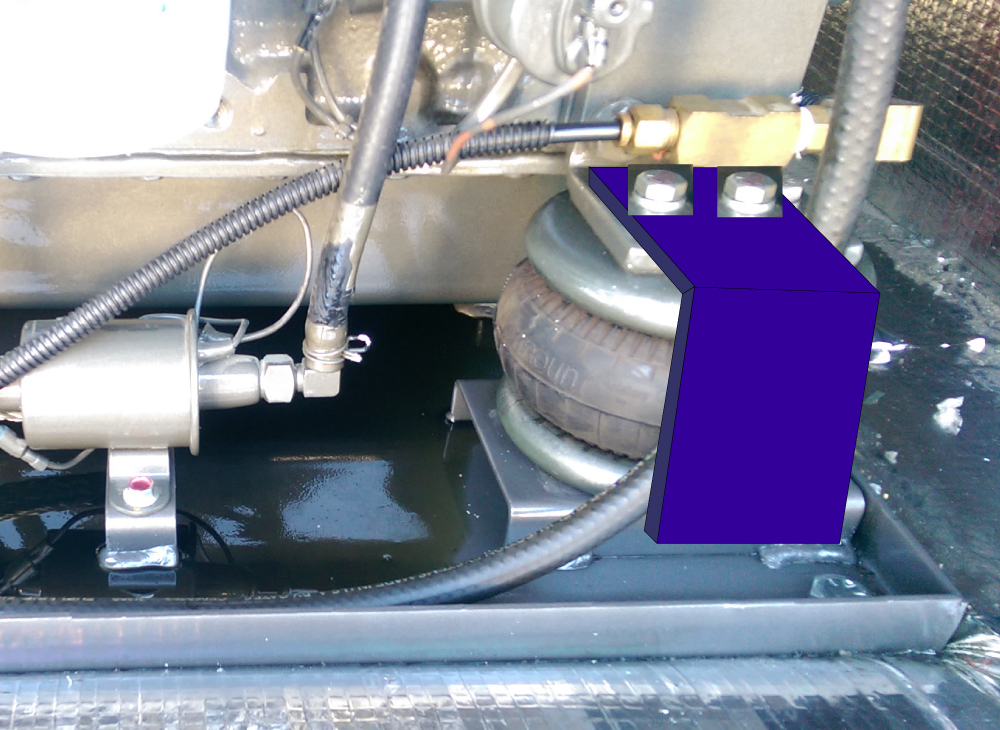

RE: First newbee mistake w/ generator on SpongeBob - GregOConnor - 10-30-2014 13:15 Dave, how about 4 of these fail legs. [attachment=1441] RE: First newbee mistake w/ generator on SpongeBob - davidbrady - 10-30-2014 20:05 (10-30-2014 13:15)GregOConnor Wrote: Dave, how about 4 of these fail legs. Clever Greg, I like the way you think! I'll check to see what kind of room I have available. I defintely don't ever want this to happen again. It could have been a catastrophic loss of lubricant, saved only by the oil pressure cutoff switch - if it's working, and even then who knows if the shutdown is quick enough!

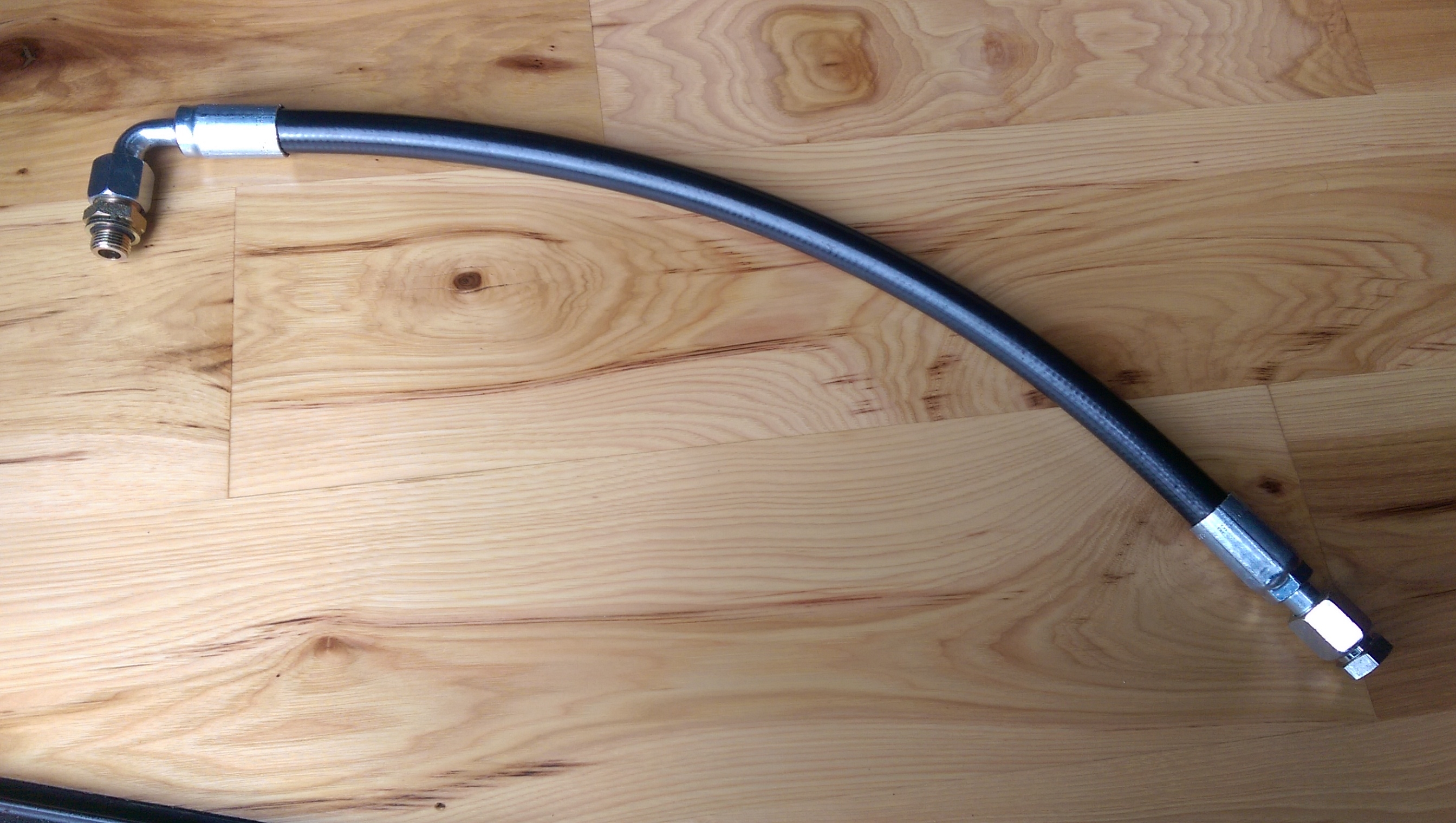

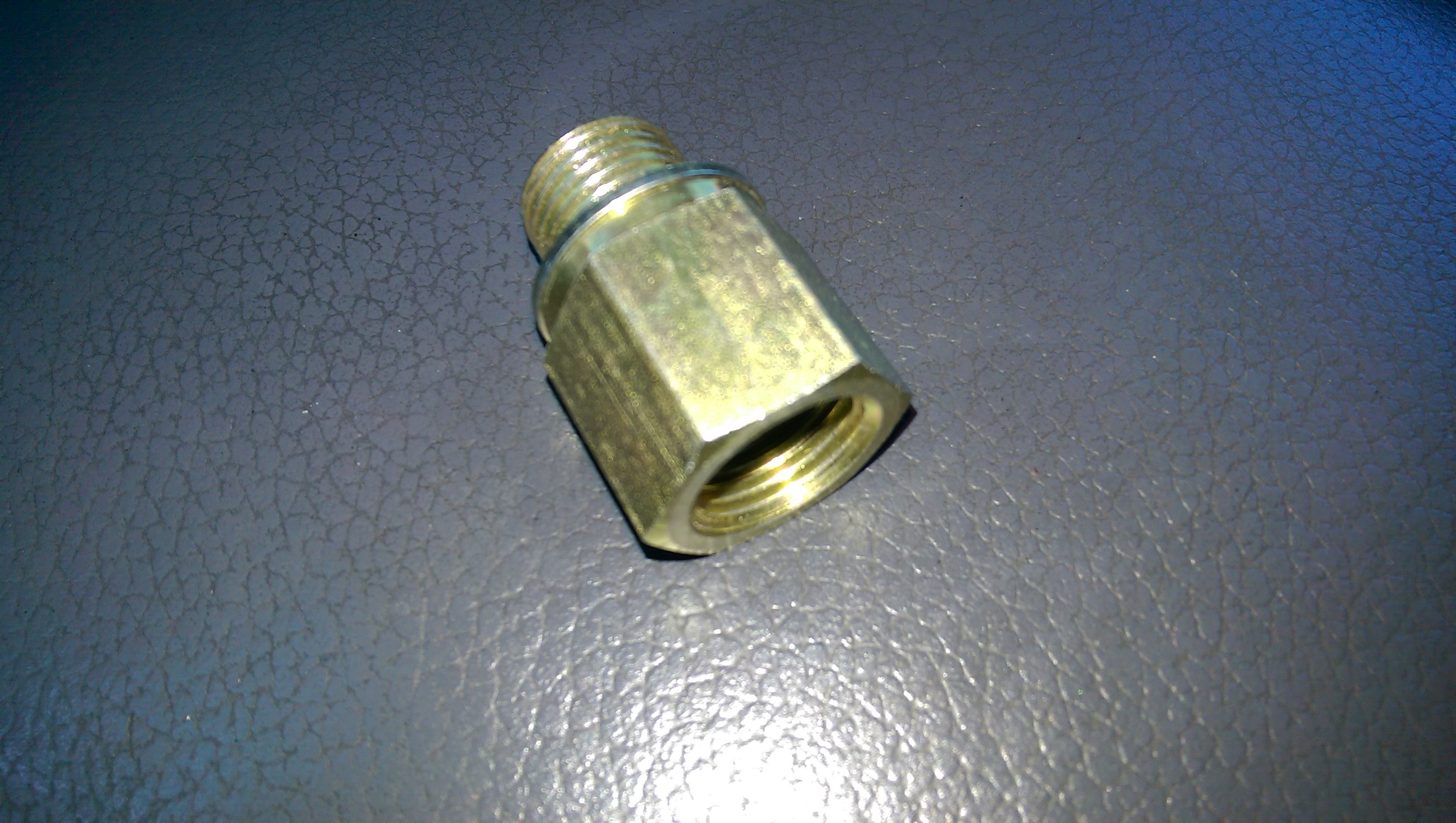

RE: First newbee mistake w/ generator on SpongeBob - davidbrady - 11-07-2014 17:23 A little digging turned up this M16x1.5 (male) to 3/8 NPT (female) adapter. I'm in business again. ![]() [attachment=1463] RE: First newbee mistake w/ generator on SpongeBob - GregOConnor - 11-11-2014 13:24 Many Bobcat tractors have a length of rubber hose threaded into the pan. On the other end of the hose is a cap. If you use a male to male adaptor you can attach a larger I d hose . My 863 tractors have steel pipe attached to the pan and that works better for flo because the pipe stays warm while draining. The hose is long enough to use for draining oil from the pan RE: First newbee mistake w/ generator on SpongeBob - davidbrady - 11-13-2014 15:24 Thanks for the suggestion Greg. I had a hose made up today. 16mmx1.5 straight fitting on one side, 37 deg JIC plug on the other, and a section of 3000 psi hydraulic hose for extra toughness. I like this approach the best. ![]() [attachment=1472] RE: First newbee mistake w/ generator on SpongeBob - GregOConnor - 11-14-2014 13:40 cool. I have a 60" skid steer, Mustang model that I modified from new to fit a 49" opening. I beat the heck out of this machine and bounce it off the rear tires to turn. One issue that happens is a hose suspended off a motor control port has a 90deg solid bend (like your pan connection) the hose weight spins the jic lose since it is orientated lefty-loosy and the rubber length is a long heavy suspension pulling down when the tractor hits all fours. If you can orientate the 90 deg hang to be righty-tighty (ASME term?) it may be a good practice. or support the weight of the rubber hose. leaks in the hydraulic hoses are usually hoses coming lose from rebound energy left in the rubber when a hose twist during that last wrench turn. |
