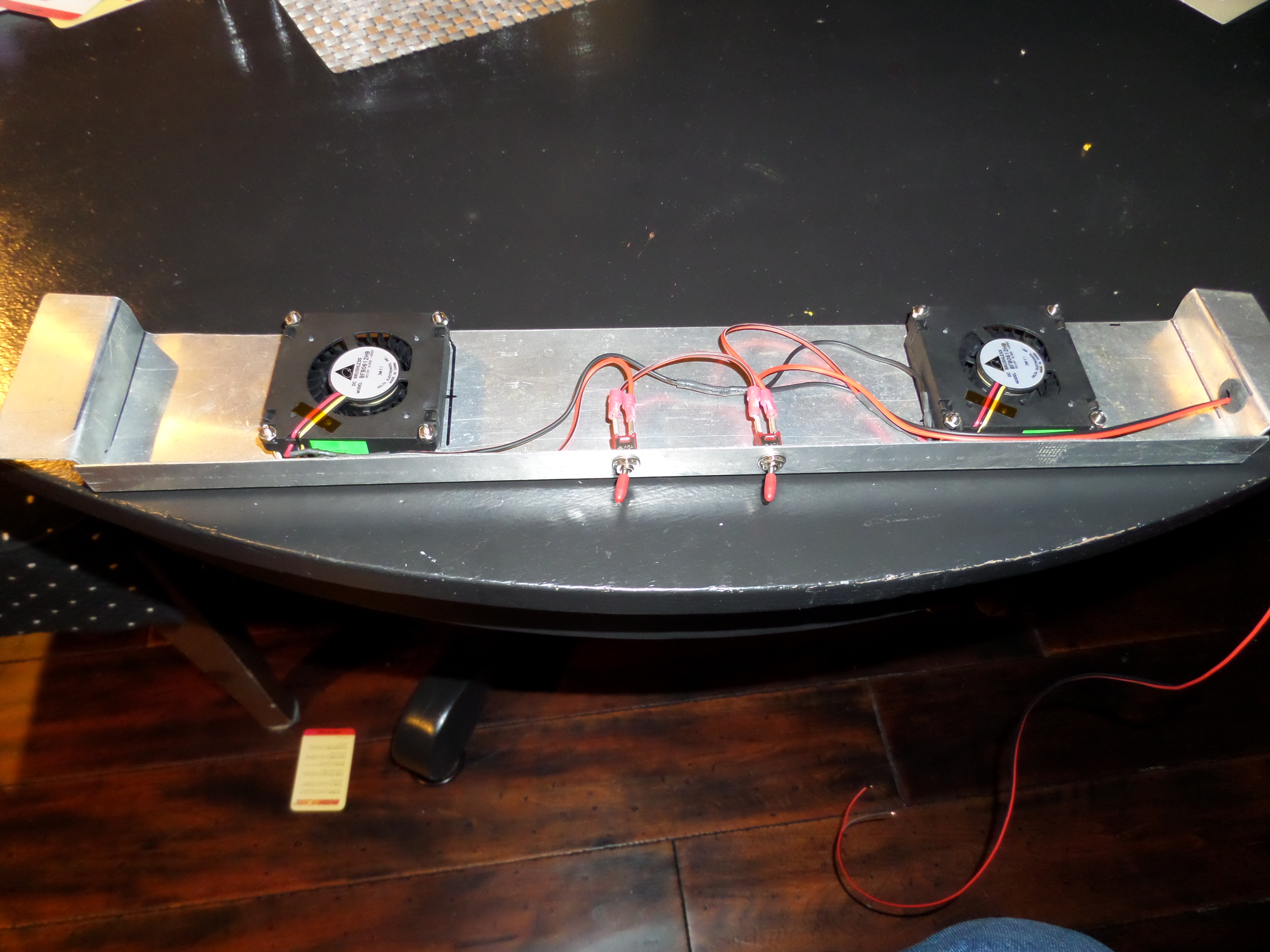

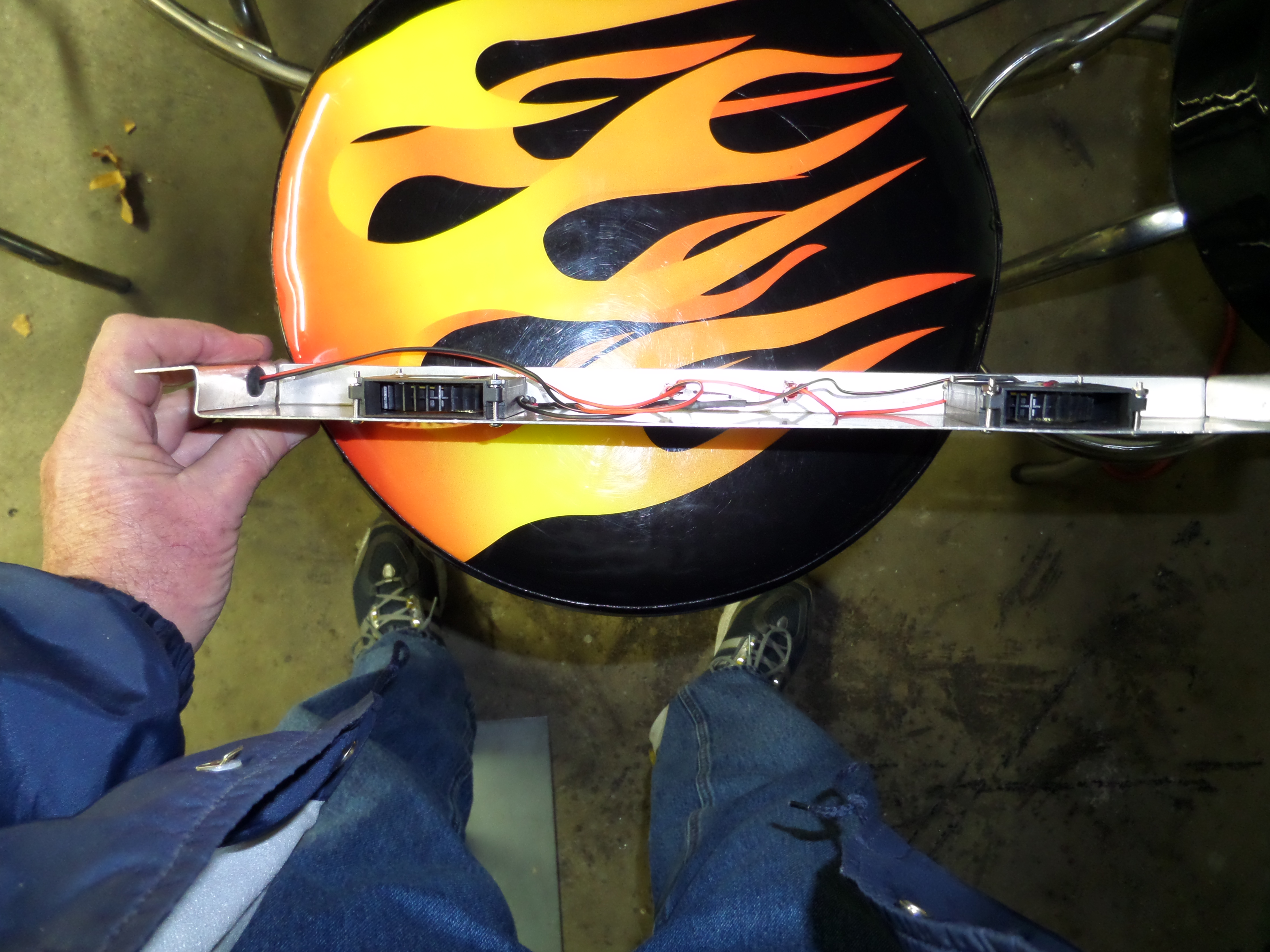

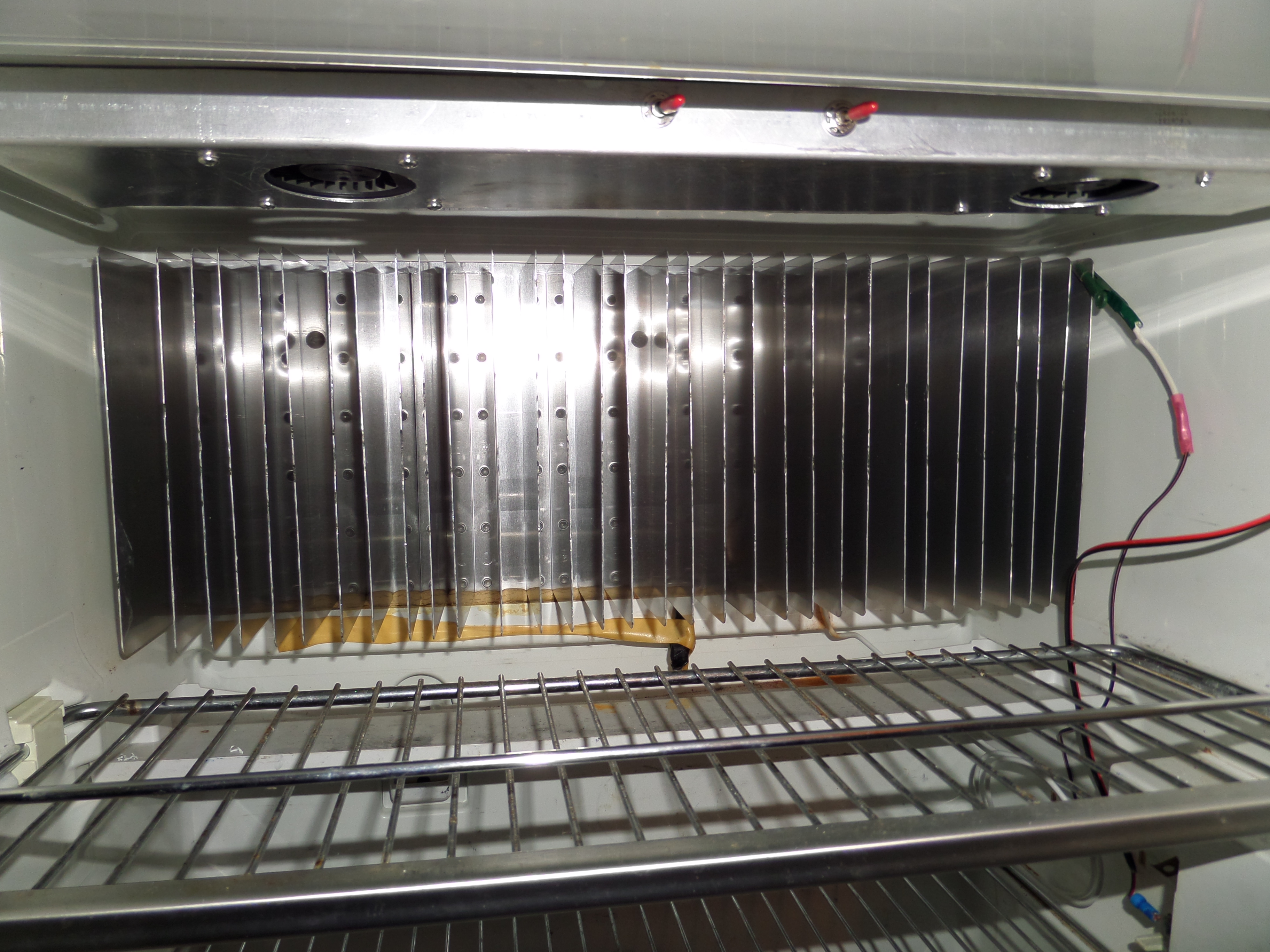

Frig. Internal Cooling Circulating - csprenger - 12-21-2013 03:46 Over the years I've purchased many different Frig. Internal Air Circulation Units ...12V, battery, etc...and ALL have stopped working. As we all know, circulating air WITHIN the frig. is a good thing to maintain cooling throughout the frig. compartment. Well, the two fan unit I purchased a couple years ago gave up. Today, I decided I can build an internal air circulating unit, hopefully better than what's on the market, and hopefully last a lot longer. Attached are a few photos of the unit I built this evening. The two fans move much more air than the dual fan that just died. The unit will be mounted at the top inside of the frig. and wired into the 12V power at the frig. light. The switchable (switches) allow both fans to run, one or none, depending on cooling need. Patent pending...hahaha. The Keg is just beyond the flame stools. Stop in for a beer, or two. RE: Frig. Internal Cooling Circulating - ernie ekberg - 12-21-2013 09:21 nice, Curt I was wondering what the flames were till I enlarged the photos RE: Frig. Internal Cooling Circulating - mikebulriss - 12-21-2013 12:16 (12-21-2013 09:21)ernie ekberg Wrote: nice, Curt Yeah, don't feel bad Ernie, I kept thinking "is that a flamed toilet seat cover?" until I enlarged the photos. LOL. Nice job Curt! RE: Frig. Internal Cooling Circulating - Arcticdude - 12-21-2013 13:28 Looks great! Will that get mounted over the cooling fins inside? RE: Frig. Internal Cooling Circulating - csprenger - 12-21-2013 16:14 [attachment=1119][attachment=1120] (12-21-2013 13:28)Arcticdude Wrote: Looks great! Will that get mounted over the cooling fins inside? Mounted on the ceiling, blowing toward the cooling fins. RE: Frig. Internal Cooling Circulating - patticake - 12-21-2013 21:08 That is an excellent idea, thanks. RE: Frig. Internal Cooling Circulating - Arcticdude - 12-21-2013 22:15 Looks pro! |
