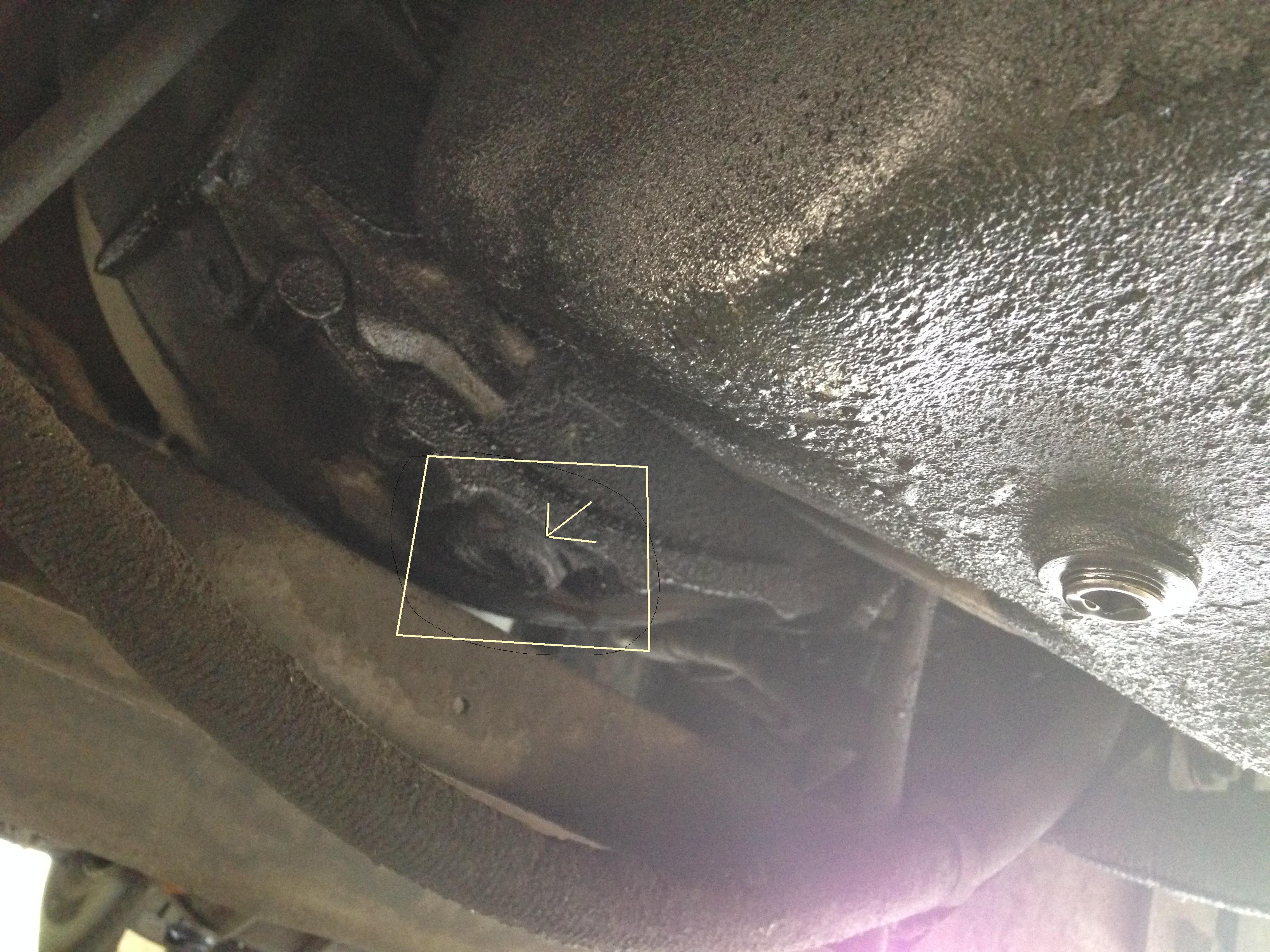

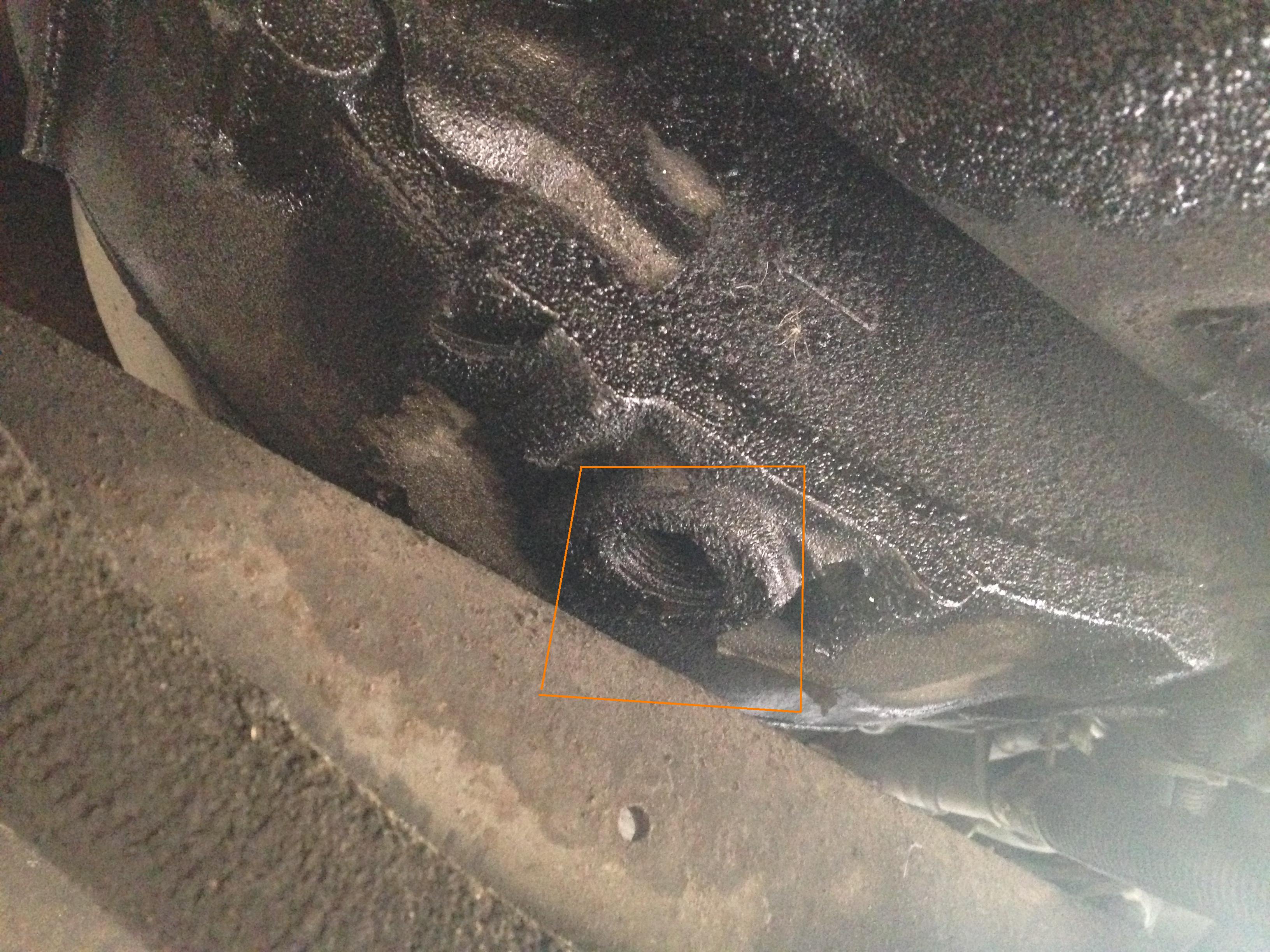

Is this a problem? - Gregg - 05-07-2014 14:52 Out getting dirty today and noticed a treaded hole with no plug. Looks like its been out for a while? 8V92 just in front of oil drain [attachment=1261][attachment=1262] RE: Is this a problem? - ernie ekberg - 05-07-2014 19:28 that's a new one on me RE: Is this a problem? - oldmansax - 05-07-2014 20:33 Is that on the bell housing? It's hard to tell in the pic but if so, that's the drain in case the input seal or crank seal leaks. It's threaded so you can route the drain somewhere else if you want. TOM RE: Is this a problem? - Gregg - 05-07-2014 22:56 (05-07-2014 20:33)oldmansax Wrote: Is that on the bell housing? It's hard to tell in the pic but if so, that's the drain in case the input seal or crank seal leaks. It's threaded so you can route the drain somewhere else if you want. Yes, I believe that is called the bell housing. So it's not a problem. Thank for help! Gregg |
