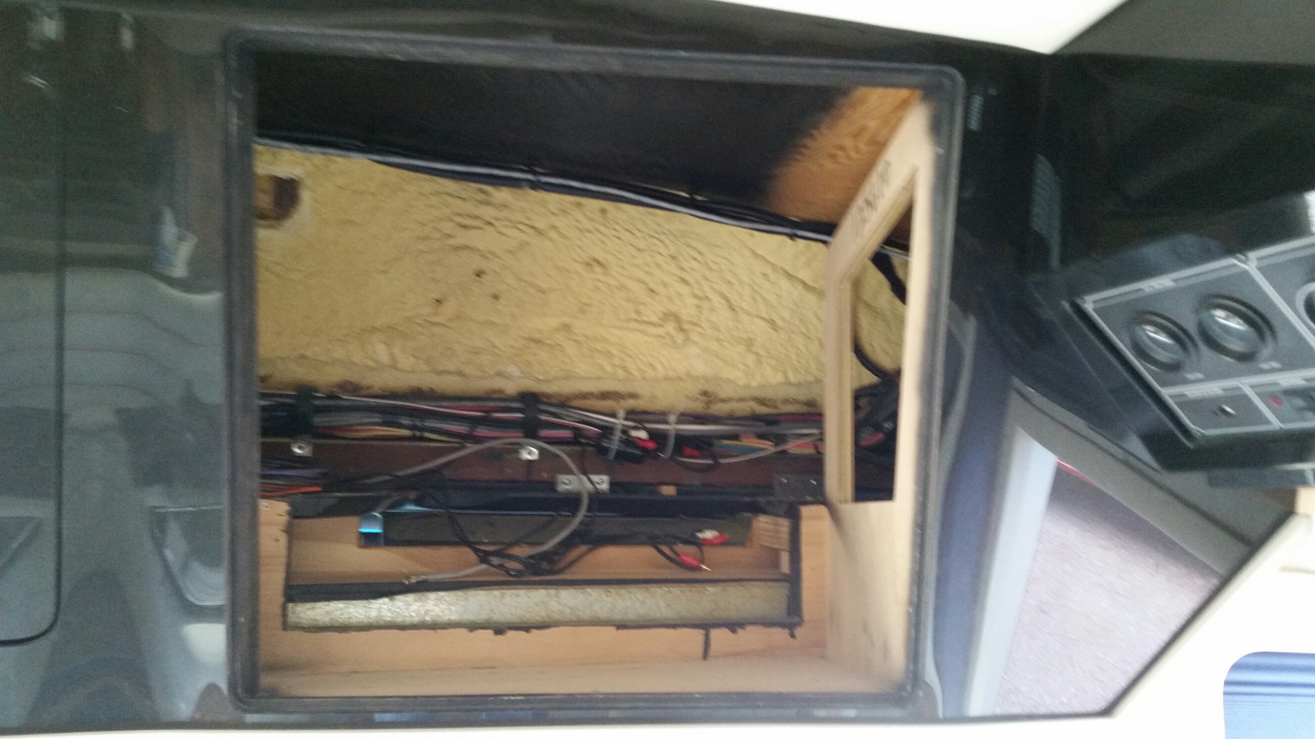

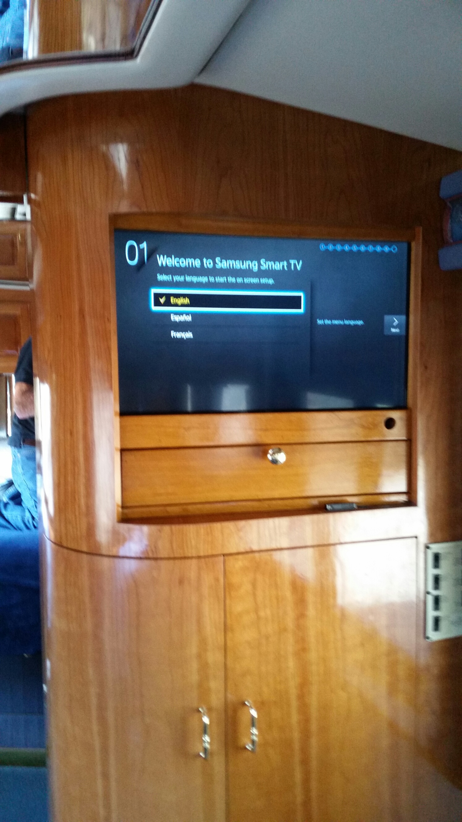

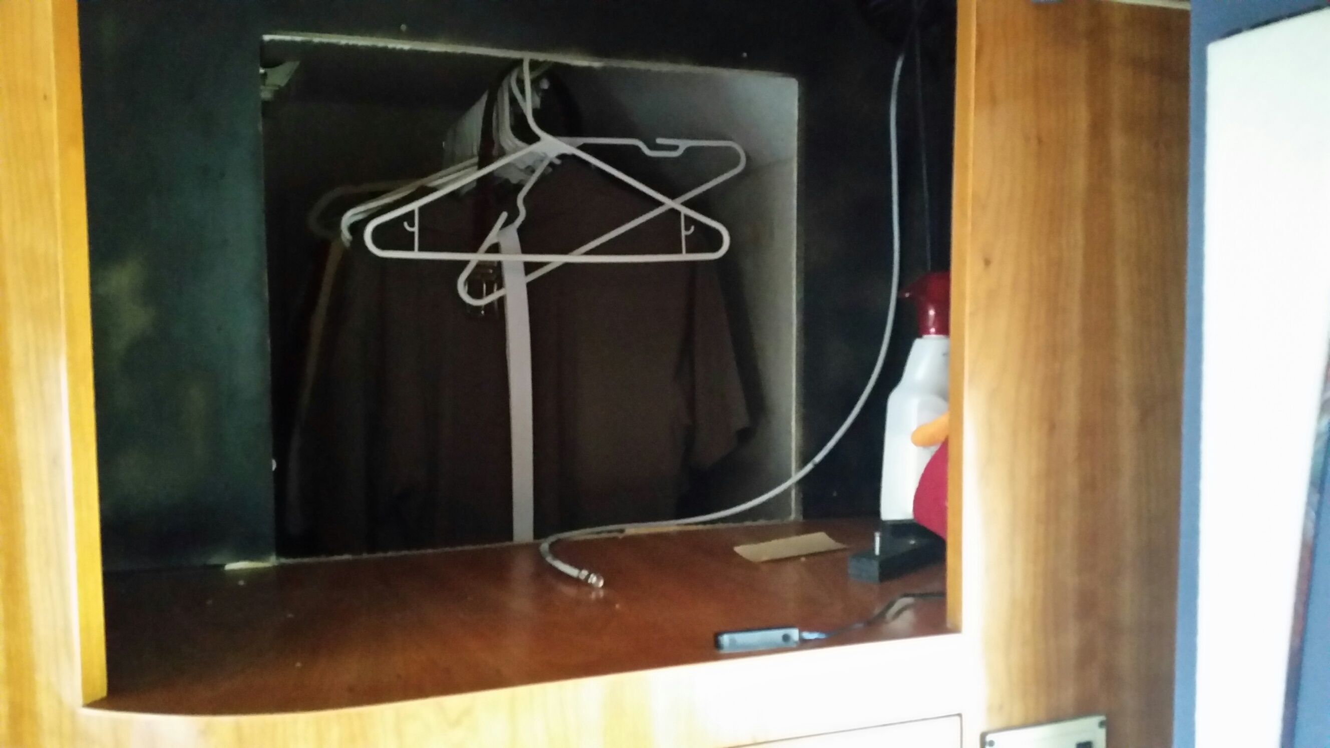

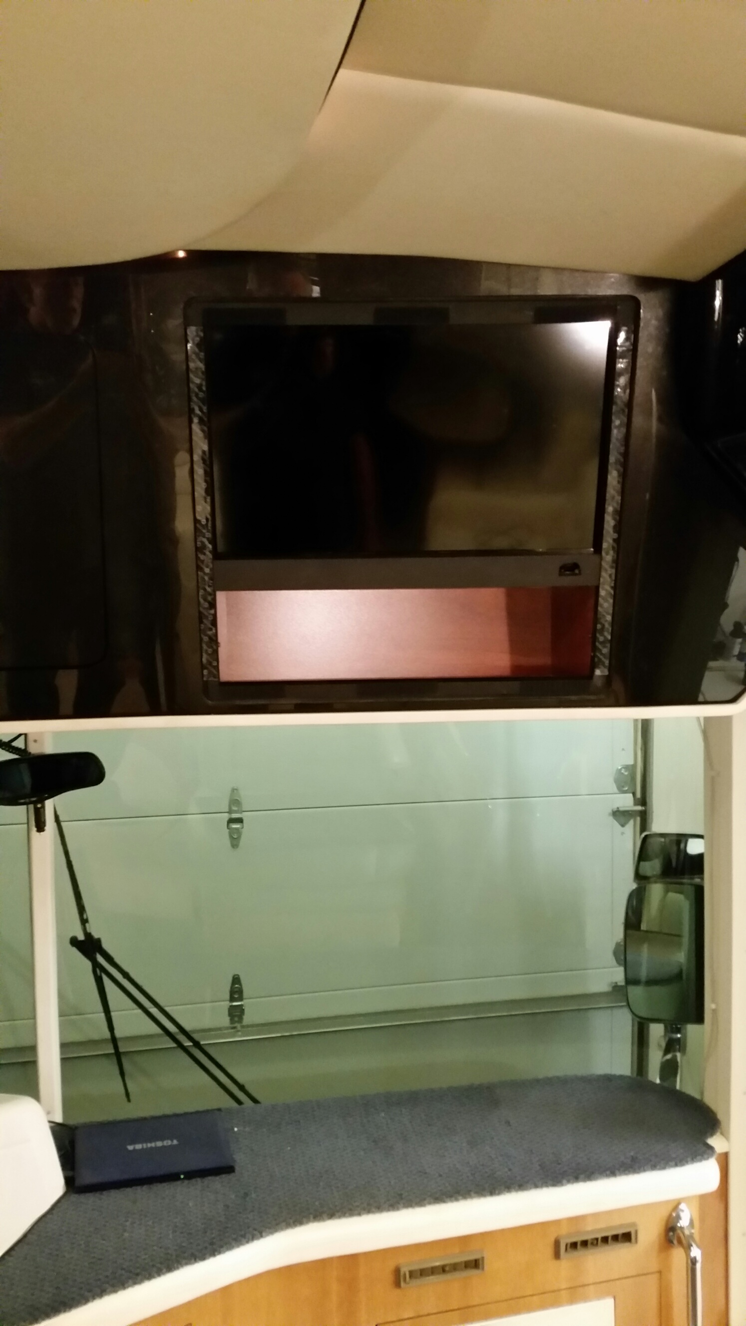

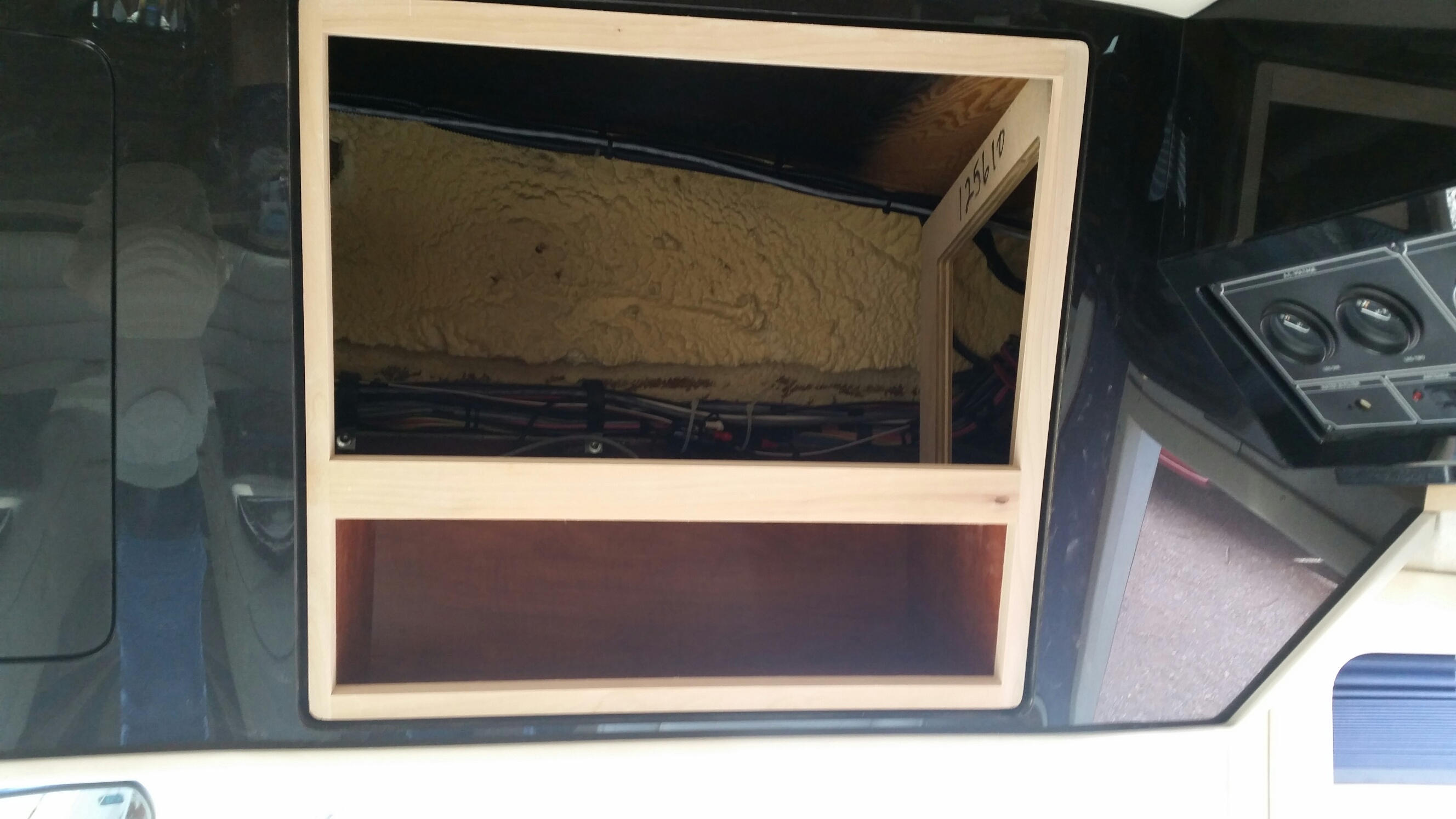

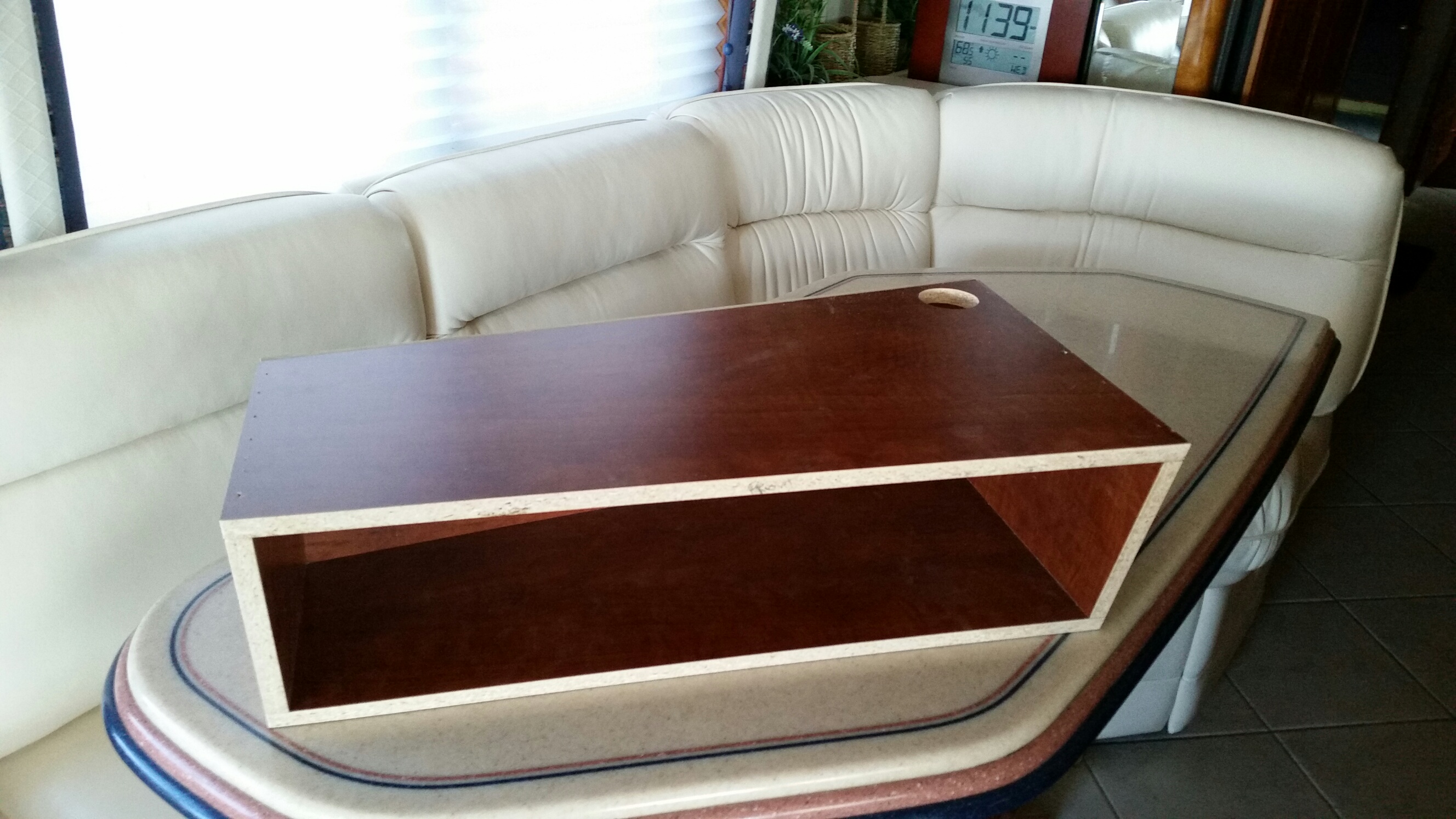

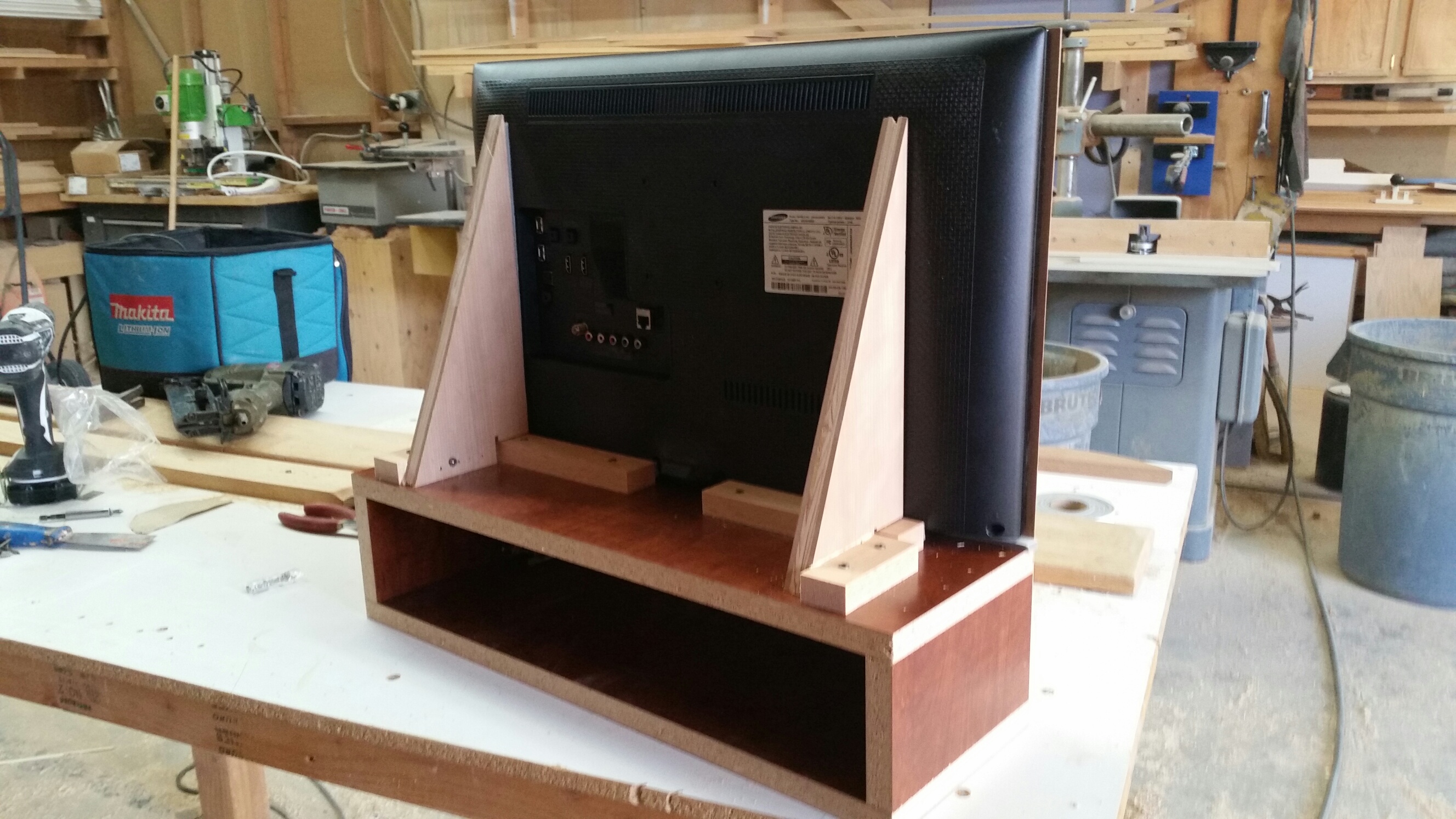

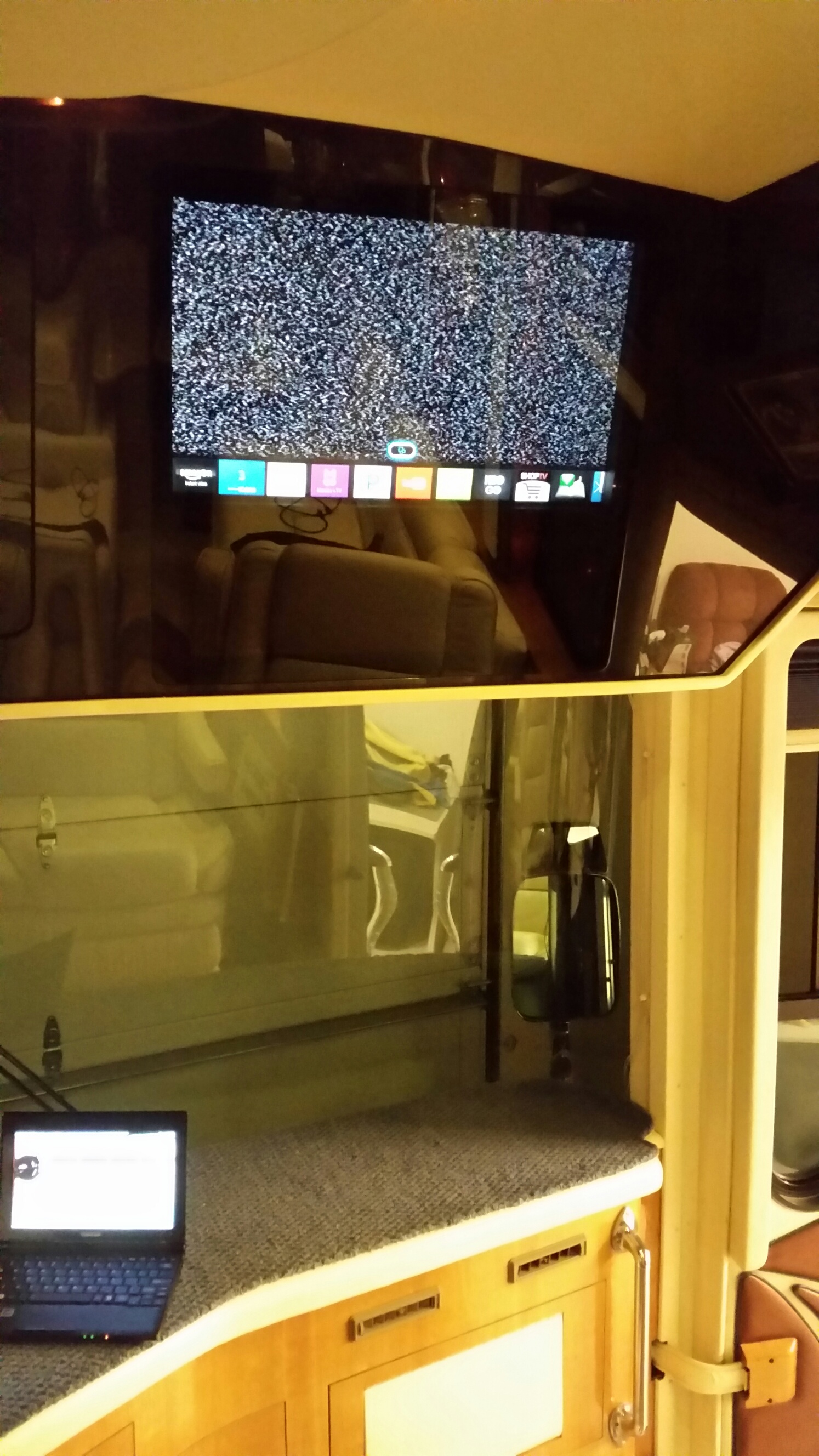

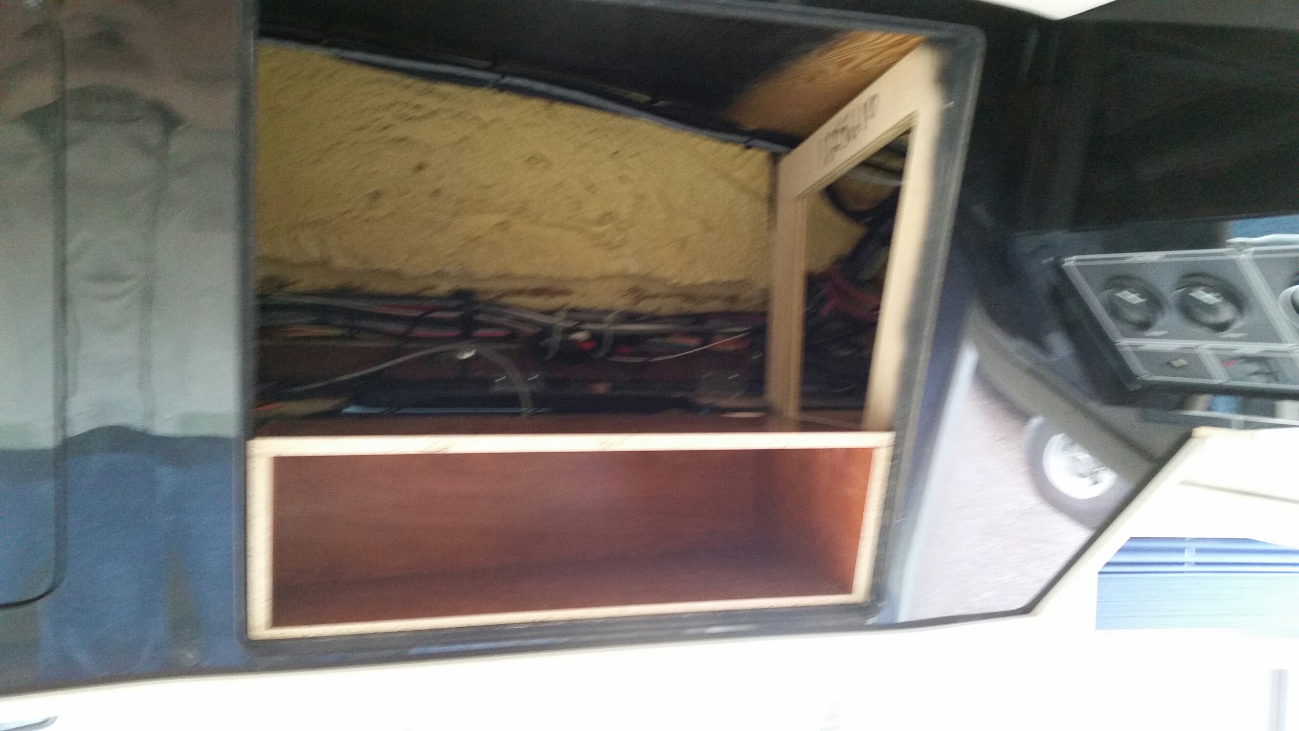

I’ve been thinking about upgrading my salon and bedroom TV(s) for a while now but I didn’t want to hang a big oversized flat screen on the interior of my bus. I already have a 42” HD flat screen in my second curbside bay. Further, I wanted to utilize the compartments that housed the original ProScan 21” CRT type TV(s) that BB installed when the bus was new. The trick was to find the largest snug fitting ones that would fit in the existing compartments. After much measuring and searching, I found the (2) Samsung 24” Smart LED TV(s) that just fit perfectly on Amazon. They are model # UN24H4500. The additional 3” in the screen size is proportionally perfect and fits the size of the rooms nicely.
If you’re looking to upgrade your old tube type TVs using the existing TV compartments, you may want to consider the model mentioned above. The pics below will show you the steps we took to install them.
Pics #1 thru 4 are of the bedroom upgrade
Pics # 5 thru 10 are of the salon upgrade

Wow Chuck! Looks like a factory install! Very impressive wood shop too. Thanks for sharing your upgrade. Smile
RE: Television Upgrade In My LXi - GregOConnor - 01-11-2015 04:36
Nice job. I like the wood finish on the bedroom case. Front TV looks factory

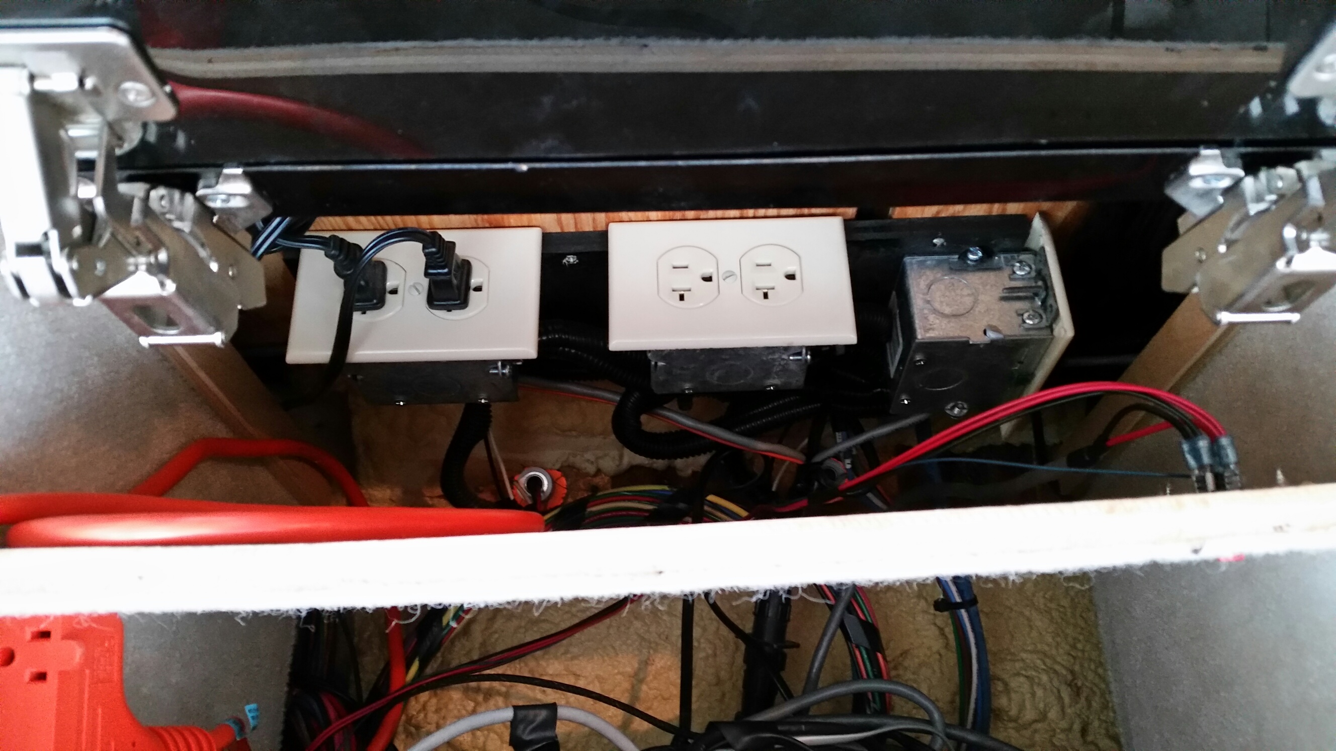

One of the problems with replacing the Audio & Video components while doing an update is finding where they are plugged in. Here’s another bit of information that may be helpful to others who intend to update their audio & video components. The 120vac outlets that power everything are hidden behind the ceiling of the center compartment. Remove two screws in the rear panel and remove it, then the ceiling panel will slide toward the back of the compartment and down. See Pic.
