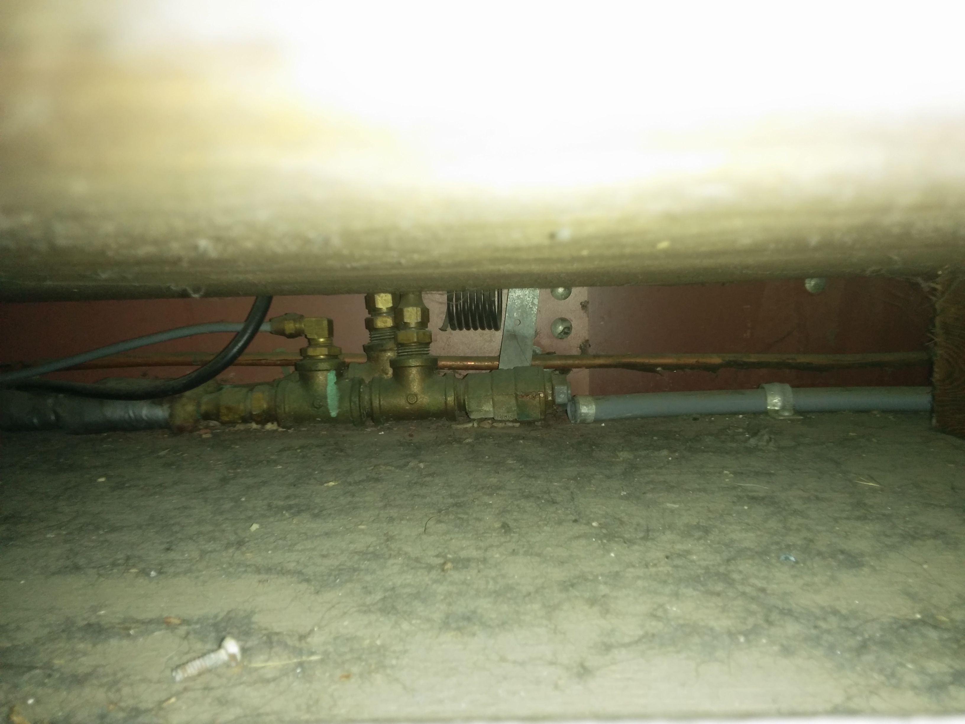

Heat? '86 PT_40 - pauleburgess - 01-11-2016 14:30 I bought the bus when it was still 100F out. I know there are something like 9 heaters, but I can't seem to make any of them work. I've got 3x Cruisairs (2 of them even work)-- these are A/C only, correct? These are controlled by 3 knob panels-- Off/Start/Run; Fan Speed; Temperature Next I've got two thermostats in the bathroom, overhead, and one on the dinette back wall, and one in the bedroom. These should control the propane heaters, right? The fan should at least come on if I tell it to, right (I'd like to make sure it blows before I feed it propane.) I've got an electric heater under the sofa (as well as engine water heat, and propane) that doesn't do anything when I turn the knob. There are also two switches (high/low, on/off) mounted next to the engine water heat. The electric in the bedroom doesn't even have a knob anymore. I am set to Summer because of this under the kitchen sink--[attachment=1931] and not being certain what would happen from that pipe if I flipped it to winter.. (note for the curious, my ice maker is located tailward from the kitchen, in the pantry area. This hose heads towards the sofa. I don't know of anything that would use water forward of the sink, other than the heater) Anyone want to give some guidance on where to start on ANY of these? RE: Heat? '86 PT_40 - mikebulriss - 01-12-2016 19:33 Paul, I can't believe that no one has responded to this list of questions yet, so let me try to start it off. Steve or Ernie, feel free to jump in here. (01-11-2016 14:30)pauleburgess Wrote: I've got 3x Cruisairs (2 of them even work)-- these are A/C only, correct? YES. The cruiseairs work very well for cooling only and I miss them and prefer them over the roof AC units. Good luck, RE: Heat? '86 PT_40 - ernie ekberg - 01-12-2016 19:46 I just saw this thread. You covered it well Mike. RE: Heat? '86 PT_40 - Itchintogo - 01-12-2016 20:58 Like a Boss!!! You covered it. The only thing I see missing is the 3 rocker switches up by the drivers seat have to be turned on for the Cruise Airs to operate. They supply the main power. The cruise airs won't come on simply by turning the rheostats to "start". The rockers switches are generally the same type of switch as the light switches. By the way, always use the start function on the rheostats and don't go directly to run. The same for shutting things off. Repeat back to start and let run for a few minutes then off. Other than that the thermostat in the bathroom on mine was for an electric heater, not propane. There should be 3 thermostats for the furnaces mine were in the bedroom and one in the salon area with galley stat right beside it. I like Ernie, did not see this thread either until this afternoon. I was logged in this morning. Paul do you have the history on the bus? It may be familiar to me. Mileage etc? RE: Heat? '86 PT_40 - pauleburgess - 01-13-2016 14:04 Thank you all so much for the information. I'll give it a shot again this weekend. I've got three overhead toggles for the Cruiseairs, which do work. The middle one blows the breaker, and we believe it's a seized compressor. I will work through this list and see what I can make happen. Fortunately, it's not too cold here in Houston, nor do I have to live in it. The gas detector might have been my issue-- the monitor panel was without power when I was trying to get the heat on. It seems my "electronic filter" is either not getting power, or is not putting out power. I have the Blue box with records from the original owner (name escapes me.) Ben Watkins had it (jus wanderful) from 1993(32k) to 2001(165k). It was for sale in March 2011 at 186kmiles by Terry Blaire in the FMCA BlueBird Chapter Newsletter, and then again in December 2011 by Erik Rakita (with wrong generator information, and suddenly only 86k miles) and then to me in Vegas in 10/2015 with X95k miles (I am suspecting X=2), at 5600 hours. It was at Quartzite in 2014. The interior living room was factory customized to have a 1978 "XV"-style table/desk and no installed chairs rather than smaller desk with two chairs, which makes the pictures pretty unique. It also has a roof mounted 5-panel solar array, since there are no roof-top air's, but that was from the last owner. RE: Heat? '86 PT_40 - Itchintogo - 01-14-2016 06:44 Interesting pedigree! It is not the bus I thought it might be. RE: Heat? '86 PT_40 - pauleburgess - 01-18-2016 12:56 It looks like my under-sofa heat doesn't follow any of this. After a few hours of getting nothing, I pulled it out. As I was pulling it out, in the process shaking it, it came on... briefly. Opened it up, and quickly saw why it wasn't coming on. Black wire of 110V was melted, broken-- the wire nut that held it also melted. Shaking it around made it make contact with the other half of itself. With all HVAC related breakers off and switches over driver off--- I asked my wife to vacuum it out and wipe down some of the dust with a wet rag, while I got the electrical kit to figure out how to splice in new wire. For some reason, I reached in just before the wet rag showed up, and I got a nice tingle off that black wire. What? Breaker is off! Yet 110VAC still present. It seems that it is not an original wiring job, and is tied into the front receptacles breaker. Lessons: Don't trust any breaker box labels. There's 30 years of rewiring here. Always probe with the multimeter. No wires from thermostat come to the box, and I don't suspect the thermostat is running a relay for this one. The rheostat in the heater seems to turn it on/off and sets temperature pretty well. Any idea about the power to the thermostat? is it 24VAC from a hidden transformer somewhere (where?)? I know I won't get any voltage by probing across the leads in the thermostat-- I've got to find connection to the common somewhere (can I use chassis ground for that?) Next weekend -- bedroom and bathroom electric heat. |
