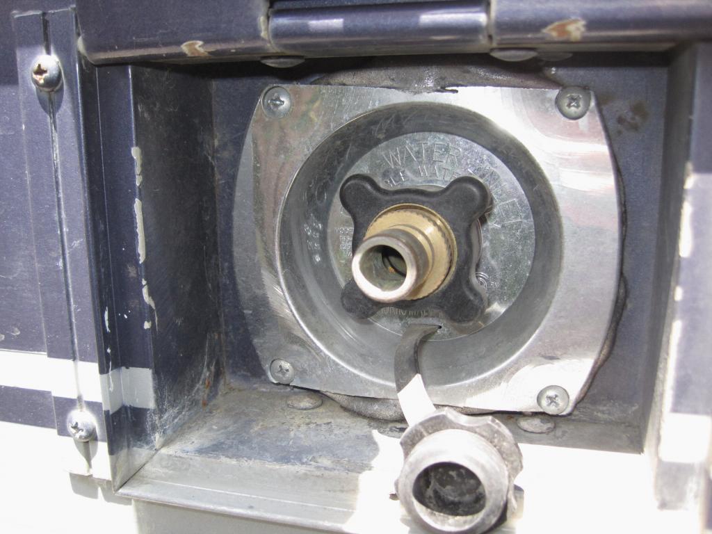

CHECK VALVE WB-40 - Jamie - 07-16-2012 06:39 HI ALL I wanted to know if anyone knows where I can get the check valve on a 1990 wb40 water fill ??where you hook up the hose thanks all help is appreciated Jamie Brandt 1990 wb40 Florida email JamieJBrandt@... CHECK VALVE WB-40 - Bob Griesel - 07-16-2012 06:47 I never did find a replacement for the OEM in my '84 FC. Ended up adapting one off the shelf from Camping World. Bob Griesel '84 FC31 WLII WA On 7/16/12 11:39 AM, "Jamie" > HI ALL > I wanted to know if anyone knows where I can get the check valve on a 1990 > wb40 water fill ??where you hook up the hose > thanks > all help is appreciated > Jamie Brandt > 1990 wb40 > Florida > email JamieJBrandt@... > > > > > ------------------------------------ > > Yahoo! Groups Links > > > CHECK VALVE WB-40 - Don Bradner - 07-16-2012 08:34 I replaced mine with a Shurflo unit. The old one was working fine, but it was 40 psi, and I wanted to bring it up to the pressure the water pump puts out. Shurflo makes theirs in more than one pressure, and I chose to go to 65 psi. I had to modify in two ways. First was to cut out some of the opening after the old one was removed. Second was to cut off some of the new one at top and bottom (it is a plastic housing) to fit in the chamber. It has been working fine for a couple of years now. Picture here: http://www.arcatapet.net/travel/bluebirds/shurflo.jpg I use brass quick-connects on the fill hose. Example of place to buy: http://www.adventurerv.net/shurflo-pressure-regulated-water-fill-chrome-p-1960.h\ tml Don Bradner 90 PT40 "Blue Thunder" My location: http://www.bbirdmaps.com/user2.cfm?user=1 On 7/16/2012 at 6:39 PM Jamie wrote: >HI ALL >I wanted to know if anyone knows where I can get the check valve on a 1990 >wb40 water fill ??where you hook up the hose >thanks >all help is appreciated >Jamie Brandt >1990 wb40 >Florida >email JamieJBrandt@... > > > > >------------------------------------ > >Yahoo! Groups Links > > > CHECK VALVE WB-40 - Markus Meyer - 07-16-2012 08:37
Last summer I updated the water input on the bus. Mine was leaking, so I took the whole plastic unit out. Replaced with a non-regulator version on the bus which was brass and metal, then bought brass pressure regulators which I screw onto the hose I am filling with, and quick disconnects as well. Works like a charm. Bought my stuff at Tweety's:
I had to modify in two ways. First was to cut out some of the opening after the old one was removed. Second was to cut off some of the new one at top and bottom (it is a plastic housing) to fit in the chamber. It has been working fine for a couple of years now. Picture here: http://www.arcatapet.net/travel/bluebirds/shurflo.jpg I use brass quick-connects on the fill hose. Example of place to buy: http://www.adventurerv.net/shurflo-pressure-regulated-water-fill-chrome-p-1960.html Don Bradner 90 PT40 "Blue Thunder" My location: http://www.bbirdmaps.com/user2.cfm?user=1 On 7/16/2012 at 6:39 PM Jamie wrote: >HI ALL >I wanted to know if anyone knows where I can get the check valve on a 1990 >wb40 water fill ??where you hook up the hose >thanks >all help is appreciated >Jamie Brandt >1990 wb40 >Florida >email "JamieJBrandt%40yahoo.com" > > > > >------------------------------------ > >Yahoo! Groups Links > > > |
