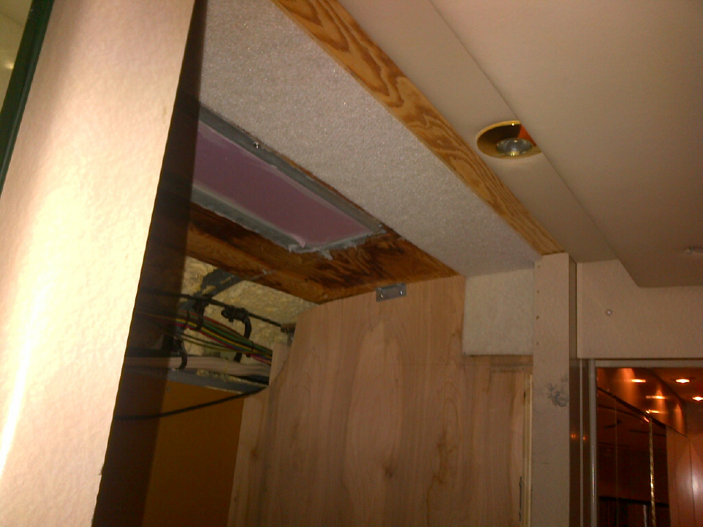

Happy to take detailed measurements, but if yours is like mine (on passenger side just beyond dinet with drawer under and small space above) the drawer and current reefer space equal 73.5 "X 32" X 28.25". What I didn't measure was the small cabinet and the depth of the A/C relief.
David,
Here is a better view of the top cabinet removed. İmage I

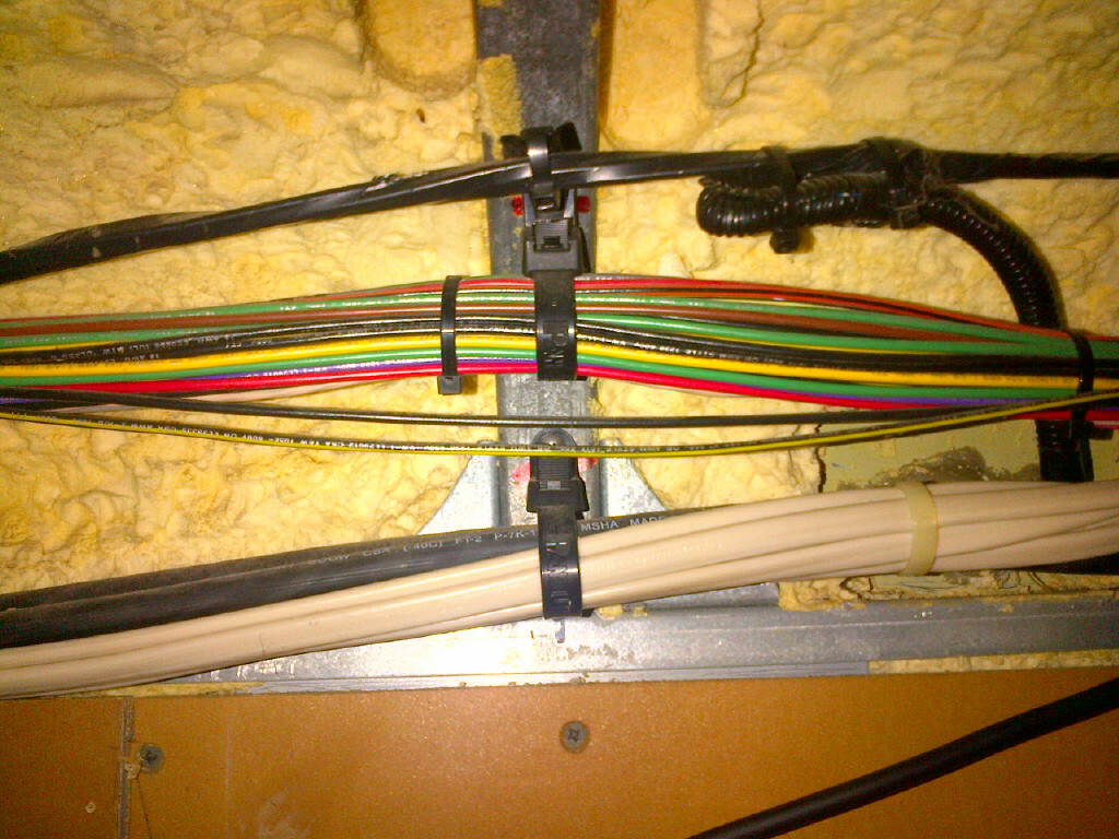

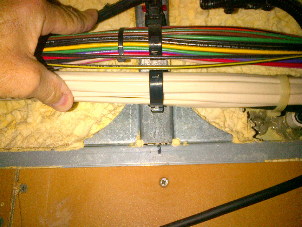

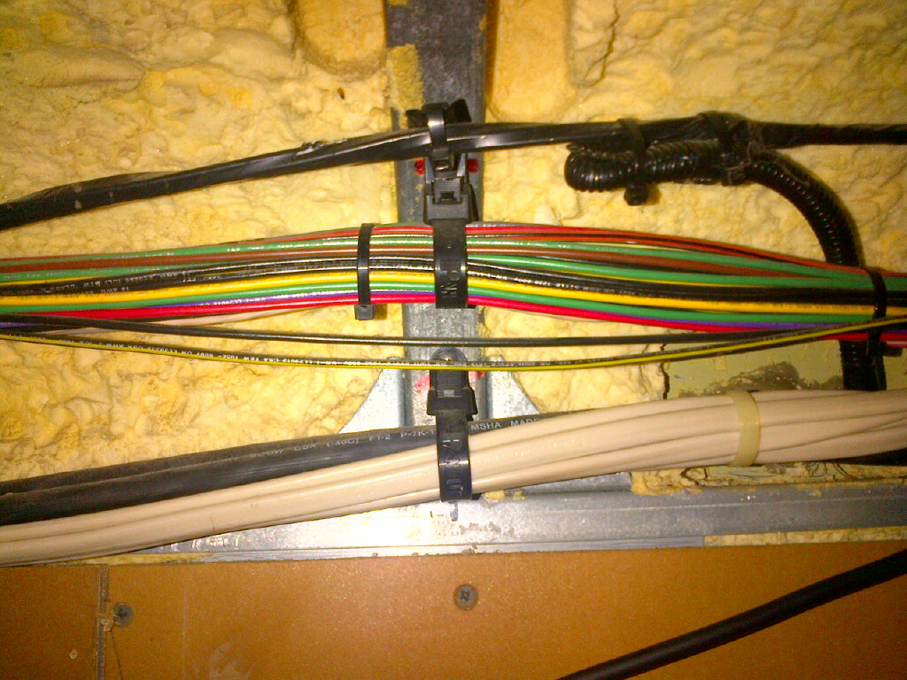

am assuming your AC/roof drop panel is similar. My bottom drawer measures 10" high X 32.5" wide (this is staying for my application). The entire box above the drawer (so add the drawer height back if you want) is 68" to the A/C panel or 70" to the roof. These measurements are with the top little cabinet removed. As you will see by these photos, the bracketry for my non-slide equipped (limited edition) coach is pretty straight forward and adds no further stand-off from the wall. I may elect to ties those wire bundles up higher. İmage İmage Does this look like yours?
