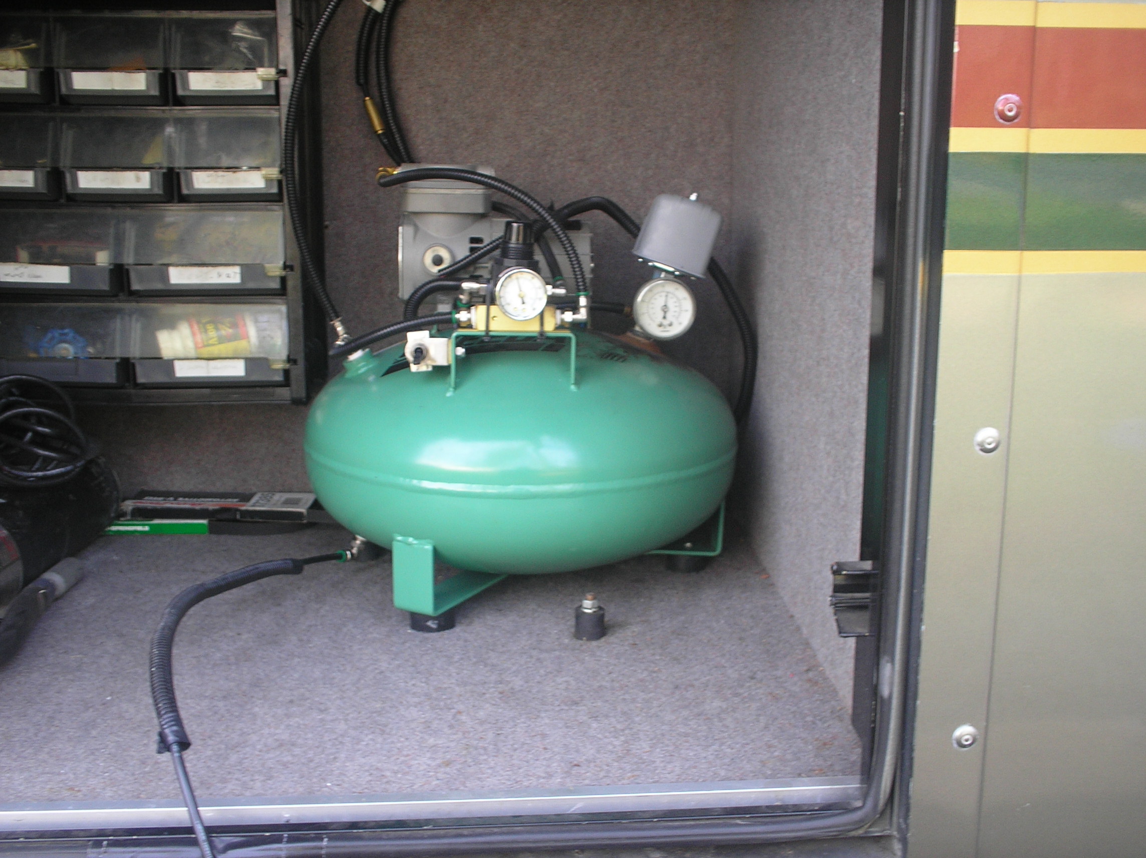

Also, the way bb mounted the tank, it was bolted to the floor and mashed down where one could not get to the drain valve. To solve that problem, unbolted it where I can move it a little and put in a drain extention. I can now drain the tank from time to time. Tommy Rountree, AKA RetDA Still a Newbie 1994 WB |
