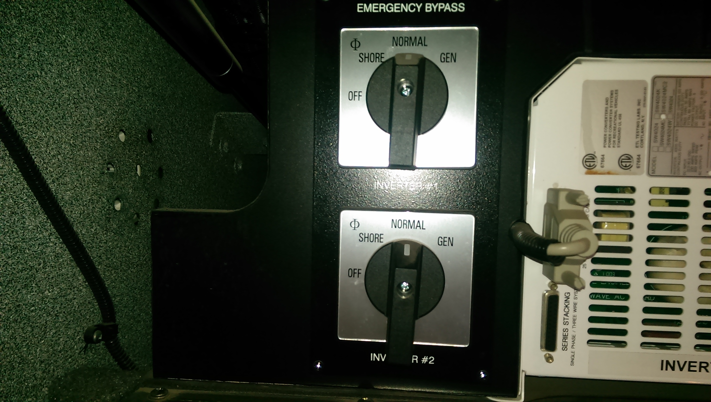

(10-13-2014 14:14)Arcticdude Wrote:  So what happens to SB (SpongeBob) if an inverter fails? Do they have a default of passing shore or genny thru so you're not stuck without power?
Hi John,
SB's got twin inverter bypass switches:
Also, the power management system overlays onto the Square D circuit panel box and doesn't need to be functional to still enjoy the coach. If the system fails, I can very easily reach into the panel to disconnect each breakers' motor drive. It's as as simple as fiddling a small plastic push button latch on each CB. With the CB's internal motors disengaged the breaker box looks like any other and the fancy remote control with power management can spin its wheels forever with no effect.
