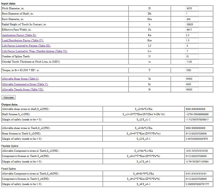

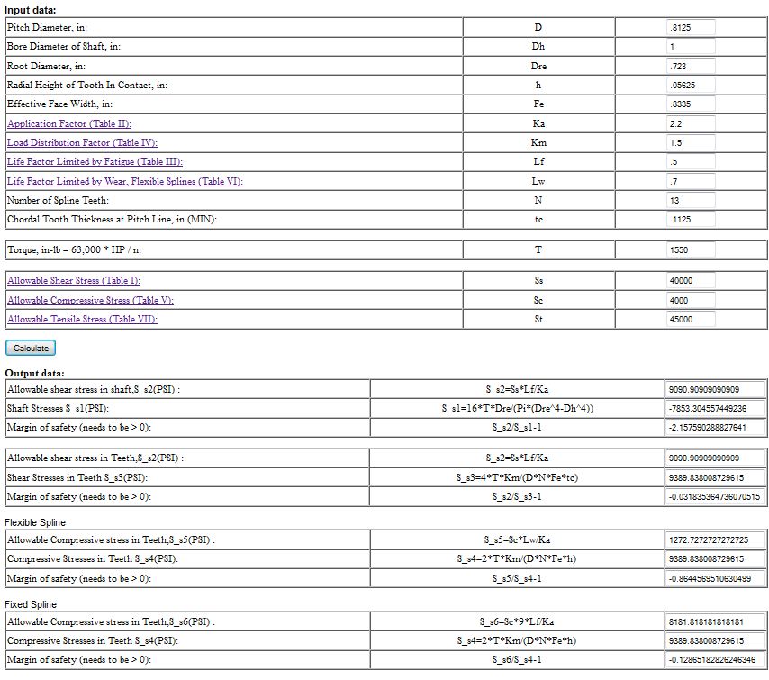

Here's a study I did a long time ago on the SAE B to SAE BB upgrade:
I've attached two outputs from a spreadsheet given to me by a gear professional. One is for the 7/8" shaft, (SAE B), the other for the 1" shaft, (SAE BB).
If you look at the "shear stress in teeth" and "compressive stress in teeth" for the 'Fixed Spline' you'll see:
1) 'compressive stress in teeth' margin-of-safety of -0.129 for the 7/8" shaft and 0.349 for the 1" shaft, and
2) 'shear stress in teeth' margin-of-safety of -0.032 for the 7/8" shaft and 0.487 for the 1" shaft.
My gear guy would like to see safety margins no less than 1.5x to 2.0x.
The 7/8" shaft just isn't adequate. The 1" shaft is markedly better. I'd like to see even better but we can only accommodate an SAE BB upgrade.
