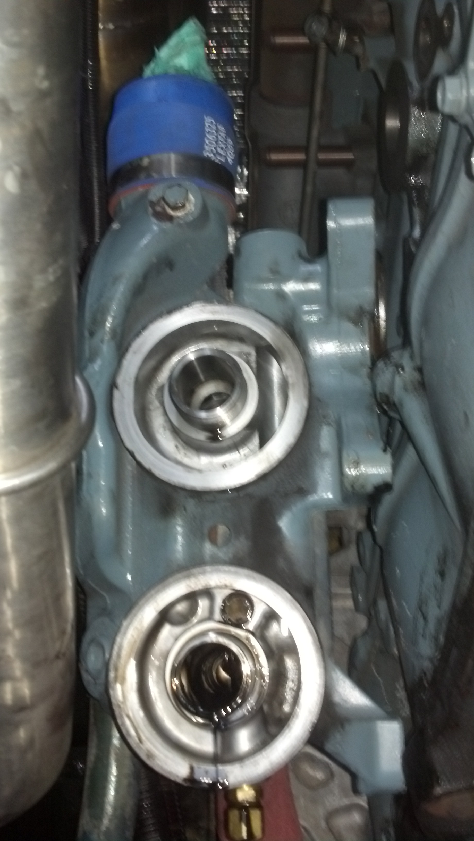

We have some folks working on their LXi rads and CAC's. Here's a "while you're in there project". I think the pics tell the story. Don't wait till after you have the CAC/Rad installed to realize your oil cooler leaks. The seals can be replaced with everything buttoned up but it's an ultra-easy job when the CAC/Rad are out.
