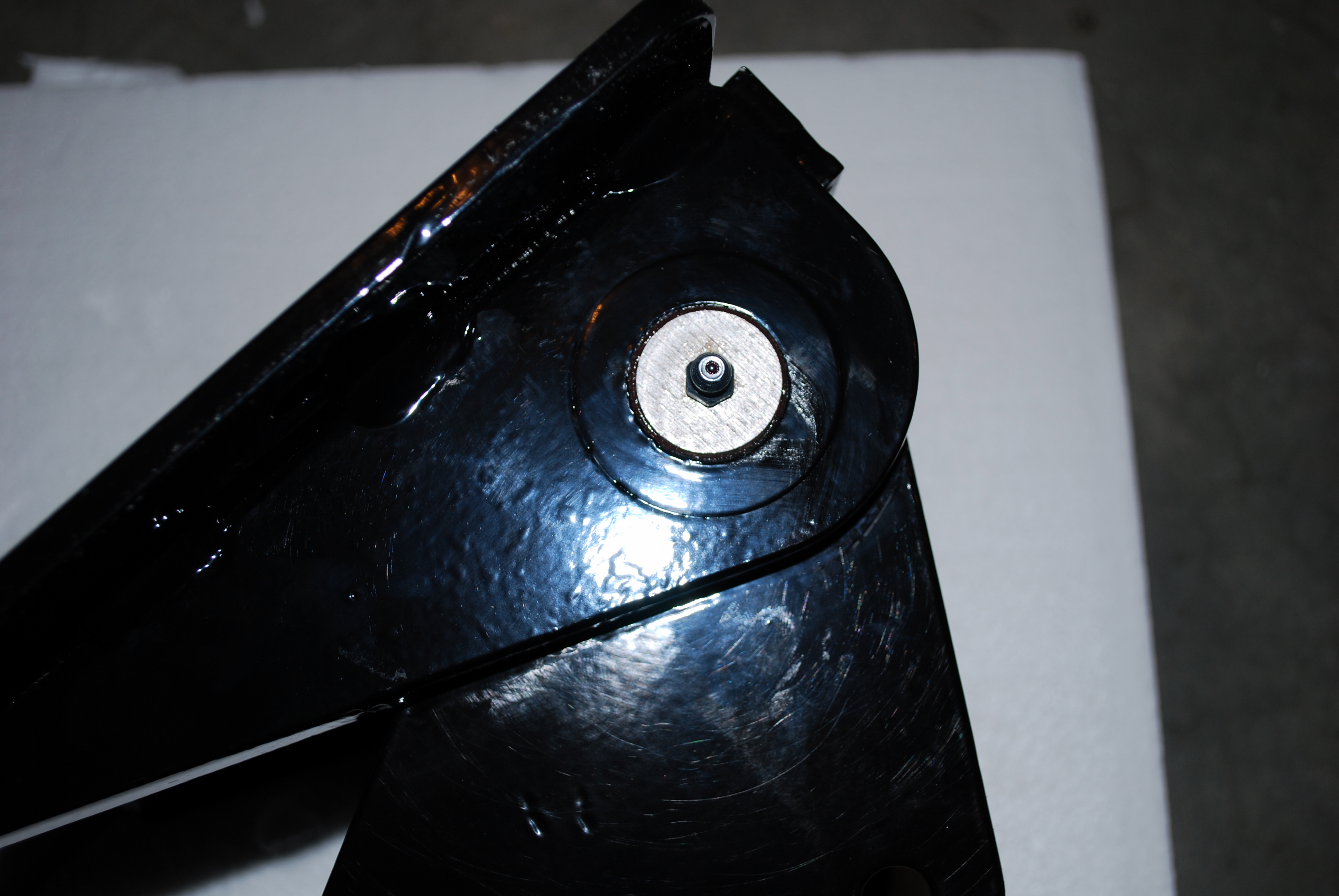

While you're R&R'ing your CAC and Radiator, here's something else that you may as well do now. My machinist pressed a bushing into the inner piece, and a bushing on each ear of the outer piece. He then machined a pin with a grease fitting in the center and tapped a hole to secure the pin flange to the outer piece. The pin flange ensures that only the inner bracket pivots on the pin.
