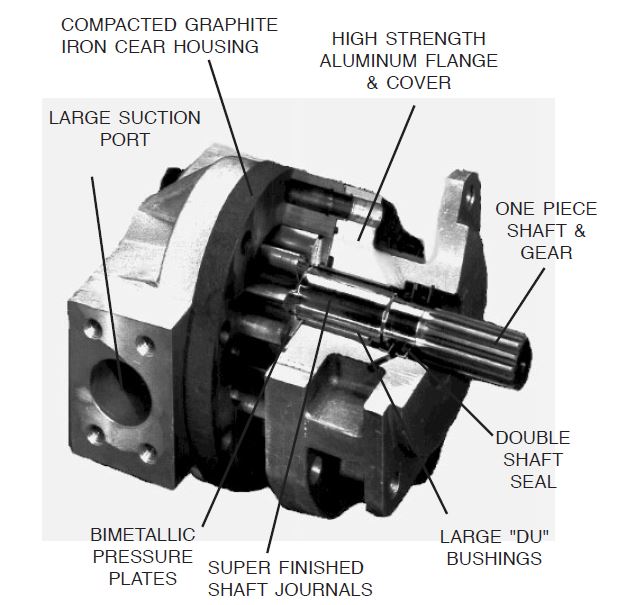

It's real; I'm in the manual grease camp too, but my greasing was easy. Greasing should be done every 3500 miles. I don't know how you're going to manage that on long trips? I'm in the manual grease camp because the 1" 15T splines solution is better but it still misses the factor of safety objective of 1.5 to 2.0x.
Here's a pic of the QCC one piece output shaft and gear: david brady, '02 Wanderlodge LXi 'Smokey' (Sold), '04 Prevost H3 Vantare 'SpongeBob' "I don't like being wrong, but I really hate being right" |
