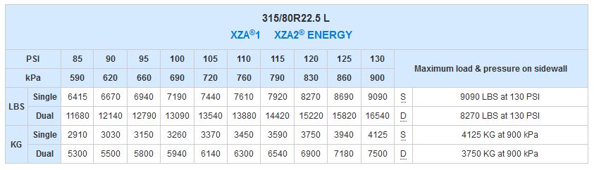

At 16,000 lbs on the steer axle, Michelin recommends 115 psi:
Look to the left for LBS, then look fro the "Single" row, then scoot over to 7920 lbs and up to 115 psi. That's 7920 lbs per tire or 15840 lbs total for the steer axle. 130 psi will loosen the fillings in your teeth! LOL!
Or, you can go over here to the Prevost Tire Pressure Calculator, choose "front axle" and 315 tires and 15840 to 16539 lbs, and you'll also get 115 psi.
