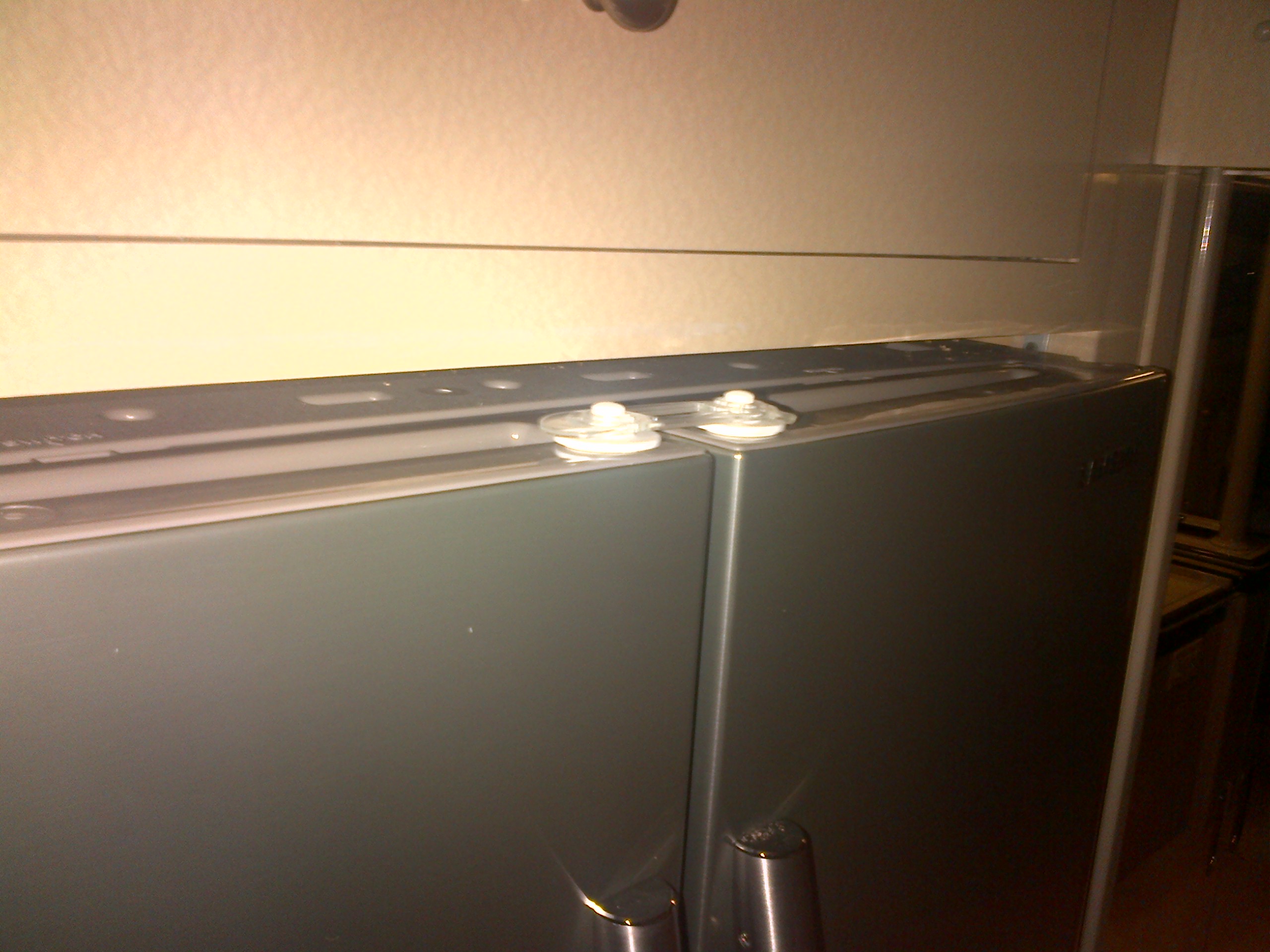

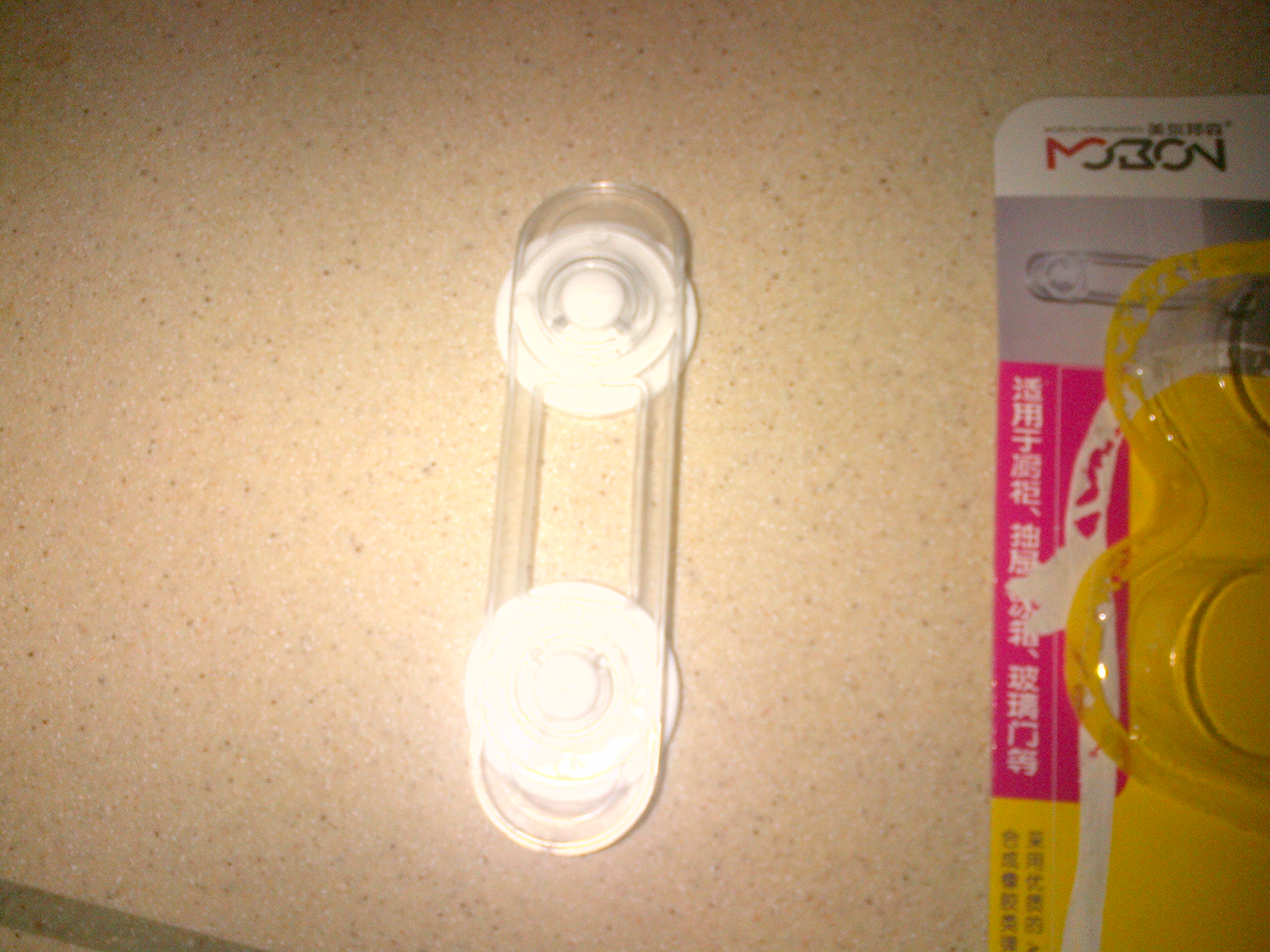

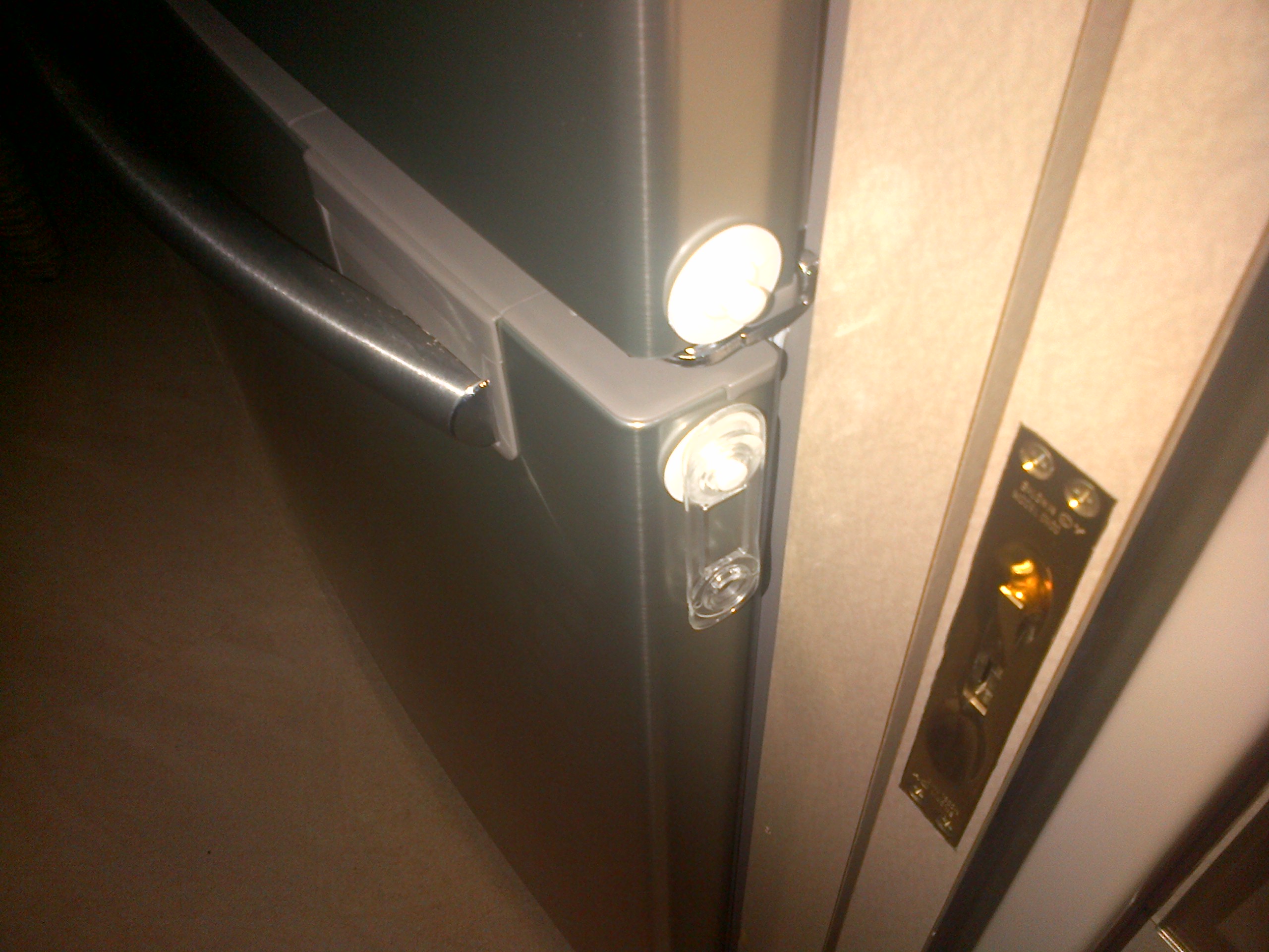

There has been a lot of discussion on how to hold the doors on the household fridge shut when under way. Leave it to my darling Jenn, who knows virtually nothing of RVs to come up with a solution. You see, she does have experience being a mom!! İmage This little device was bought on line for about $5 (for two), it is a child lock for cabinets. On top it locks the two sides together and is very strong. İmage For the freezer, the tabs were located towards the far back side. İmage Pretty much invisible, The tabs have self-adhesive tape and the piece that hooks them together is some kind of strong rubber.

Wait, let me grab my slide rule so I can do a modulus of elasticity calculation... Yup, right on! Way to go Jenn! :-)
