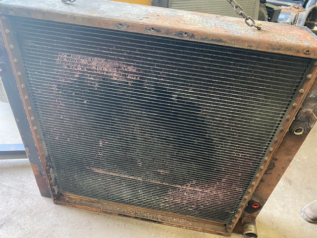

I finally got my coach back -was quite an ordeal - time wise and $$$$$ I think that the information I have seen had the radiator being removed from the side. The guys doing my coach removed the front bumper and removed it from the front. Not saying this is the best way - but it was the way they wanted to do the repair. I have enclosed a few pictures - both the radiator and CAC had to be rebuilt. Just the charge of rebuilding them was over $6,000 Hopefully this helps someone I am not sure if I attached the three pictures correctly. Thanks Urnie[attachment=2208][attachment=attachment=2209][attachment=2210] Urnie & Medie Krueger Yorkville, IL 2001 LXi One Slide 1983 FC35 sold |

While it's tough to "like" your post due to costs, I'm glad you've got it done. IIRC, David did the same thing to get his radiator out of his LXi. The bumper had to come off and it kind of came out the rear/side.
