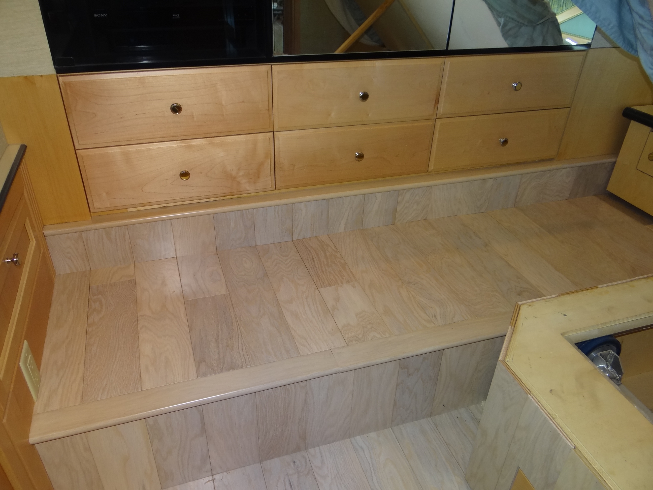

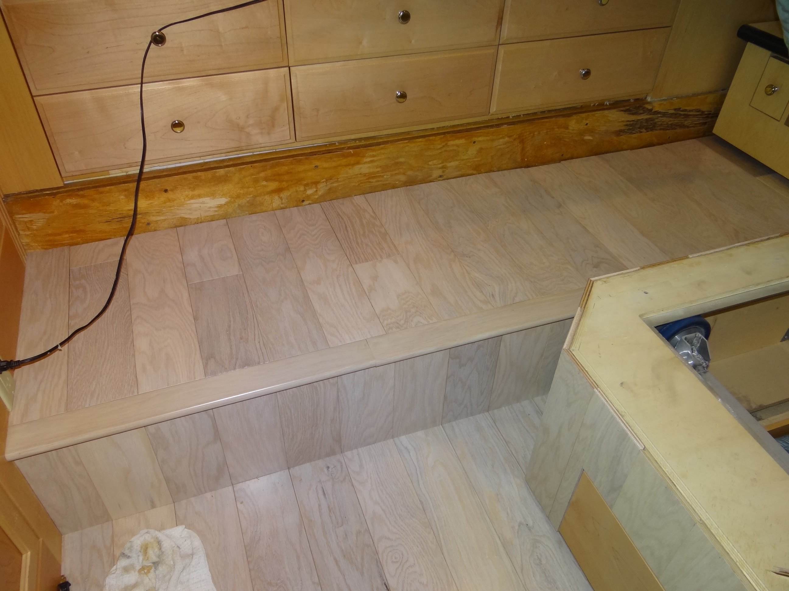

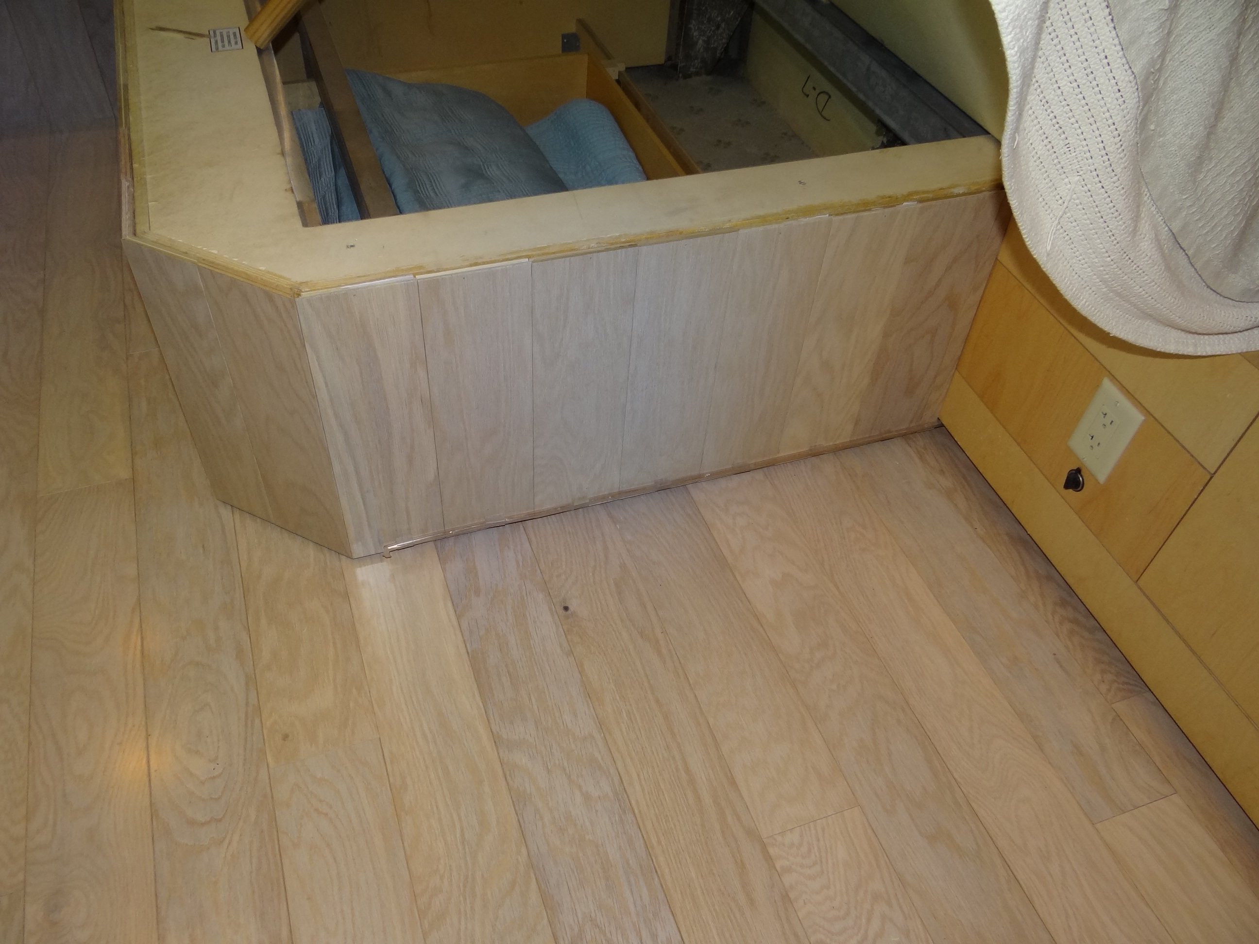

RE: Factory installed flooring-450 Lxi

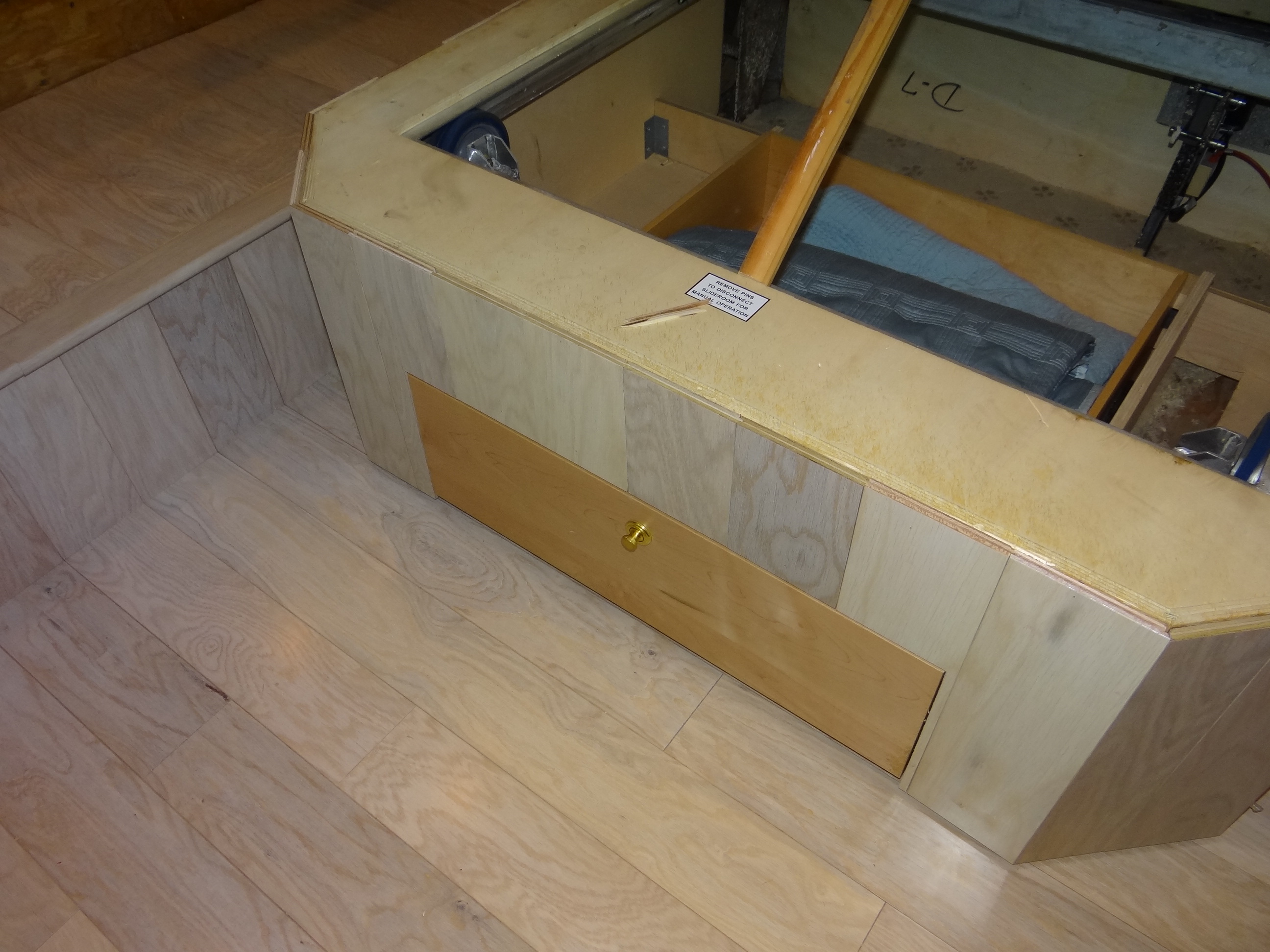

Hi,. Looking at the bed frame. With the mattress and board lifted, will the wooden frame around the aluminum slide off toward the curb side? Undoing the top screws and the back support of the drawer? Perhaps a couple screws going down from in front of the headboard? It would make installation of any product easier.
Ross MacKillop Wiarton Ontario 2006 450 Lxi |
05-11-2017, 18:57
Ross, I install the wood just a little ways under the frame. The bed frame rolls on the aluminum structure that is bolted to the floor. Other clients have taken the time to remove everything. That endeavor would add 2 days labor to R/R that piece. And then, I have no place to store it

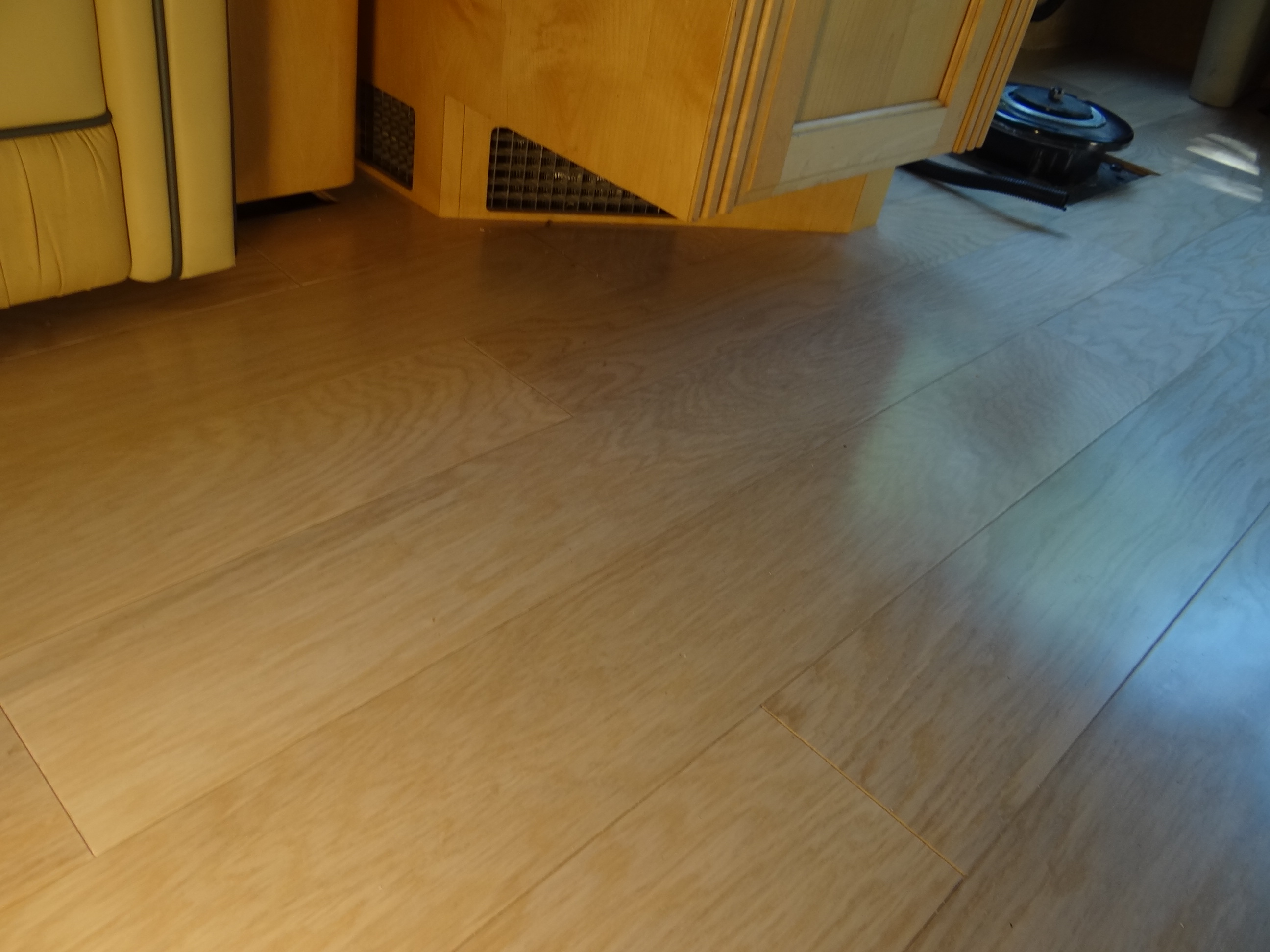

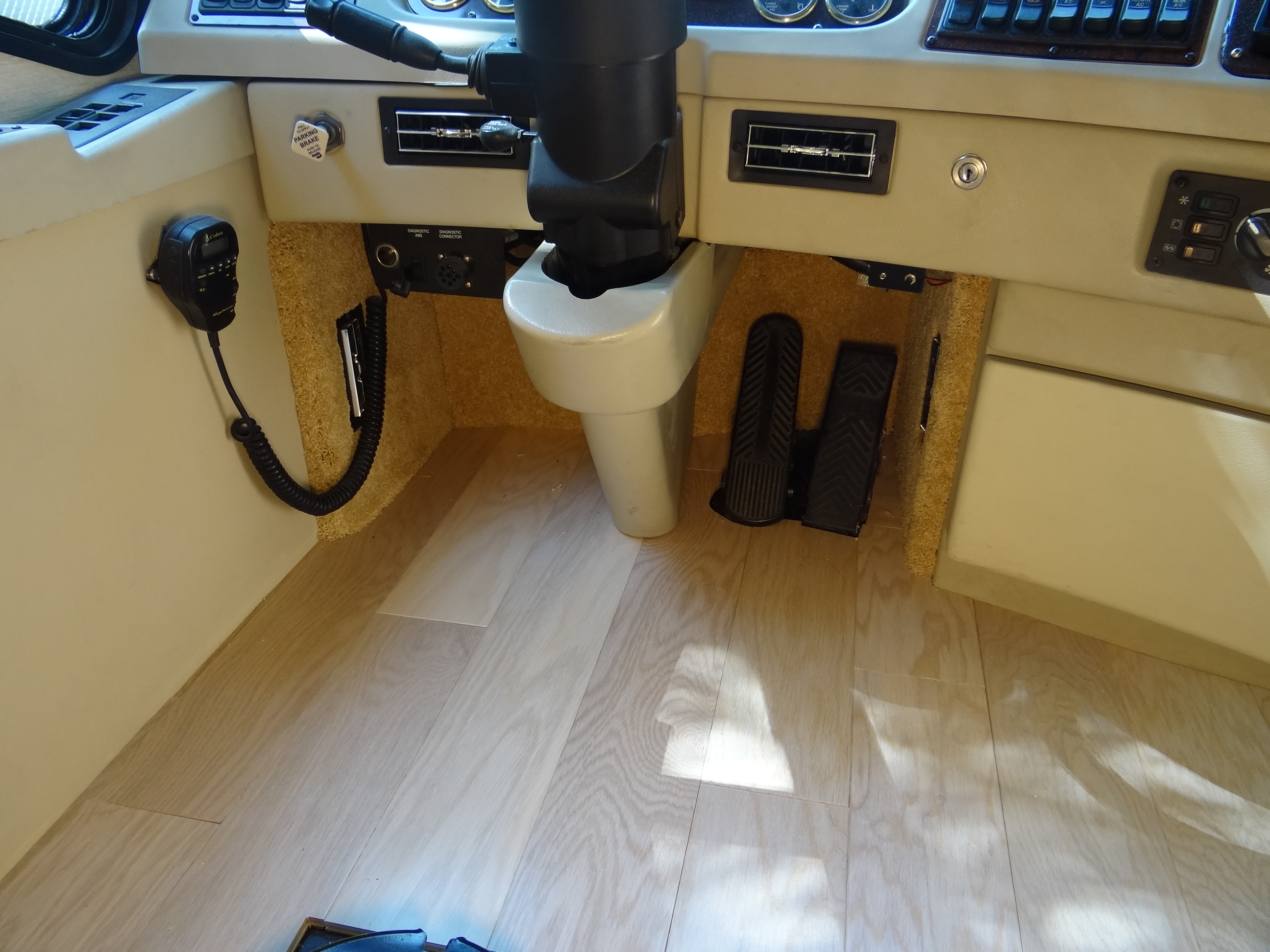

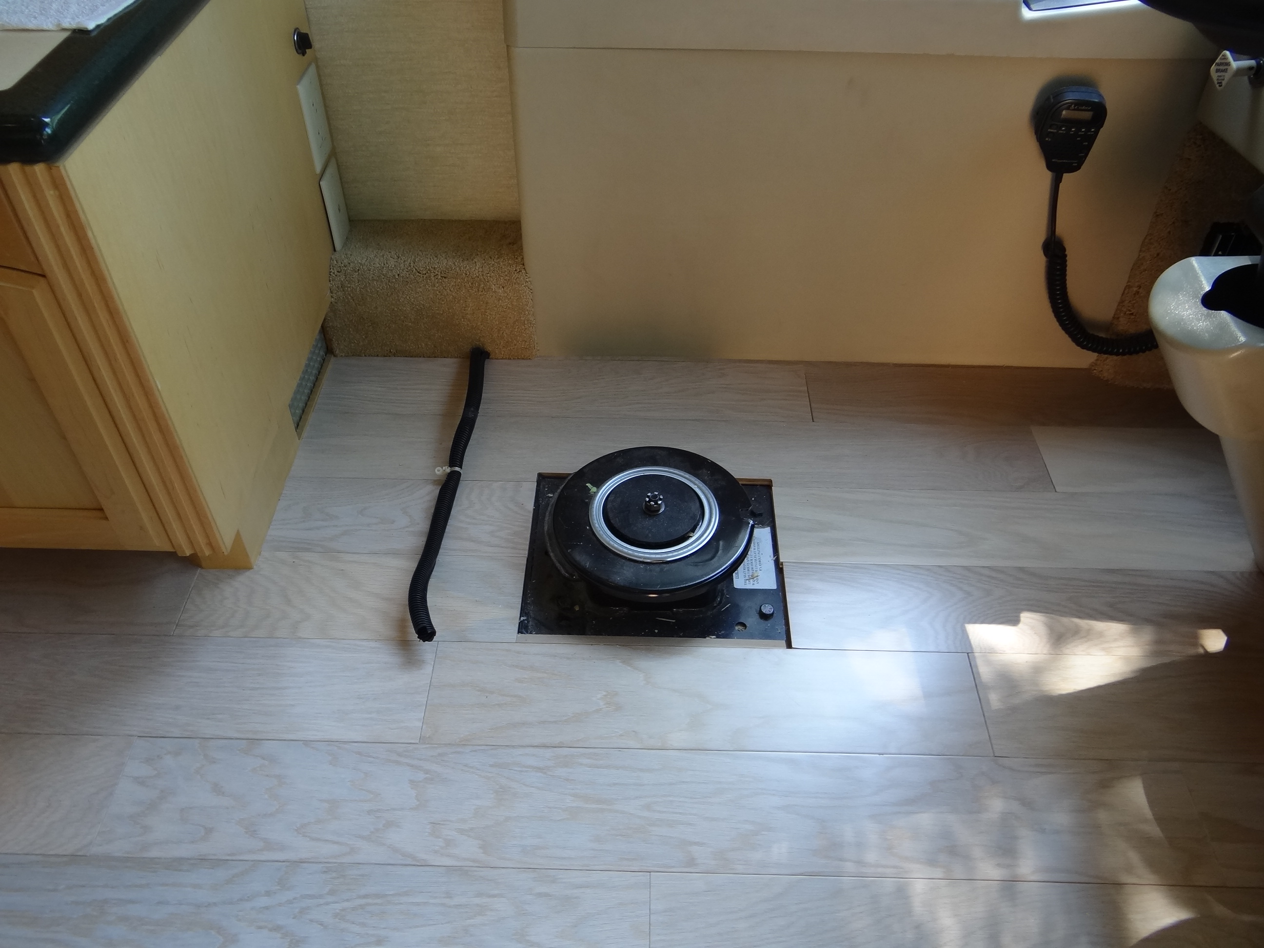

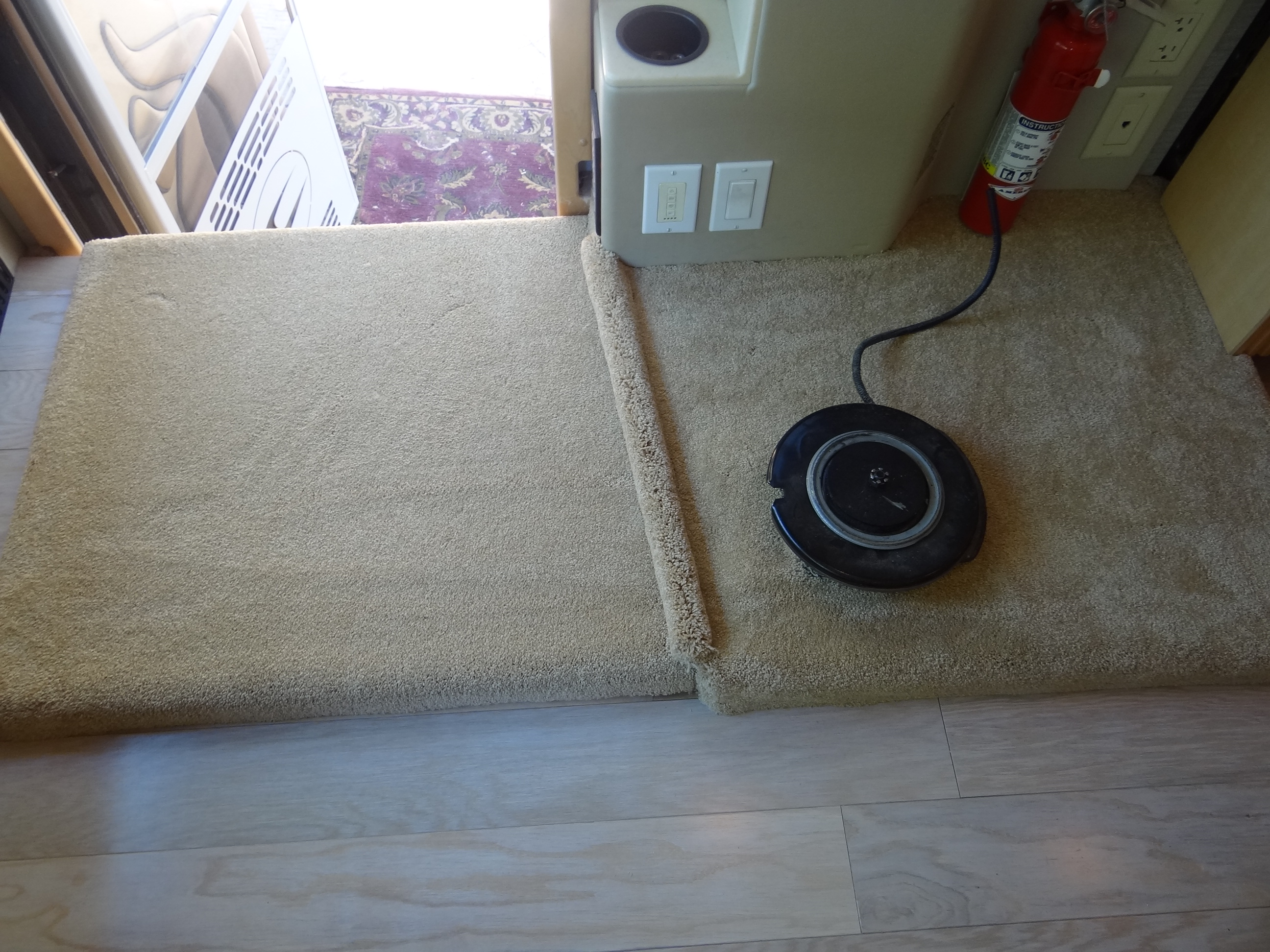

main floor completed
05-11-2017, 20:23
Absolutely perfect.. Impressive.

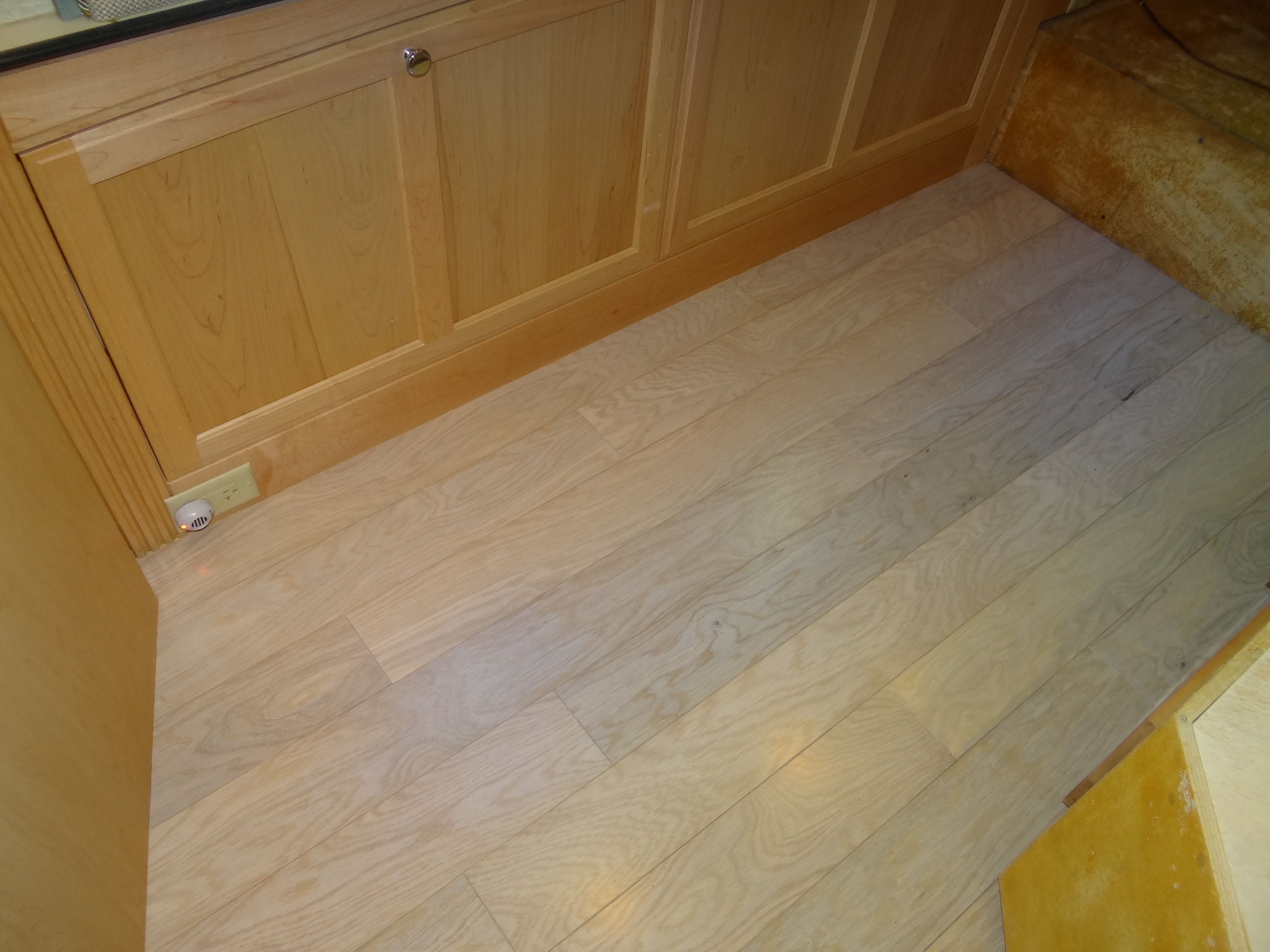

bedroom

Now that's a beautiful installation Ernie! Thanks for sharing!

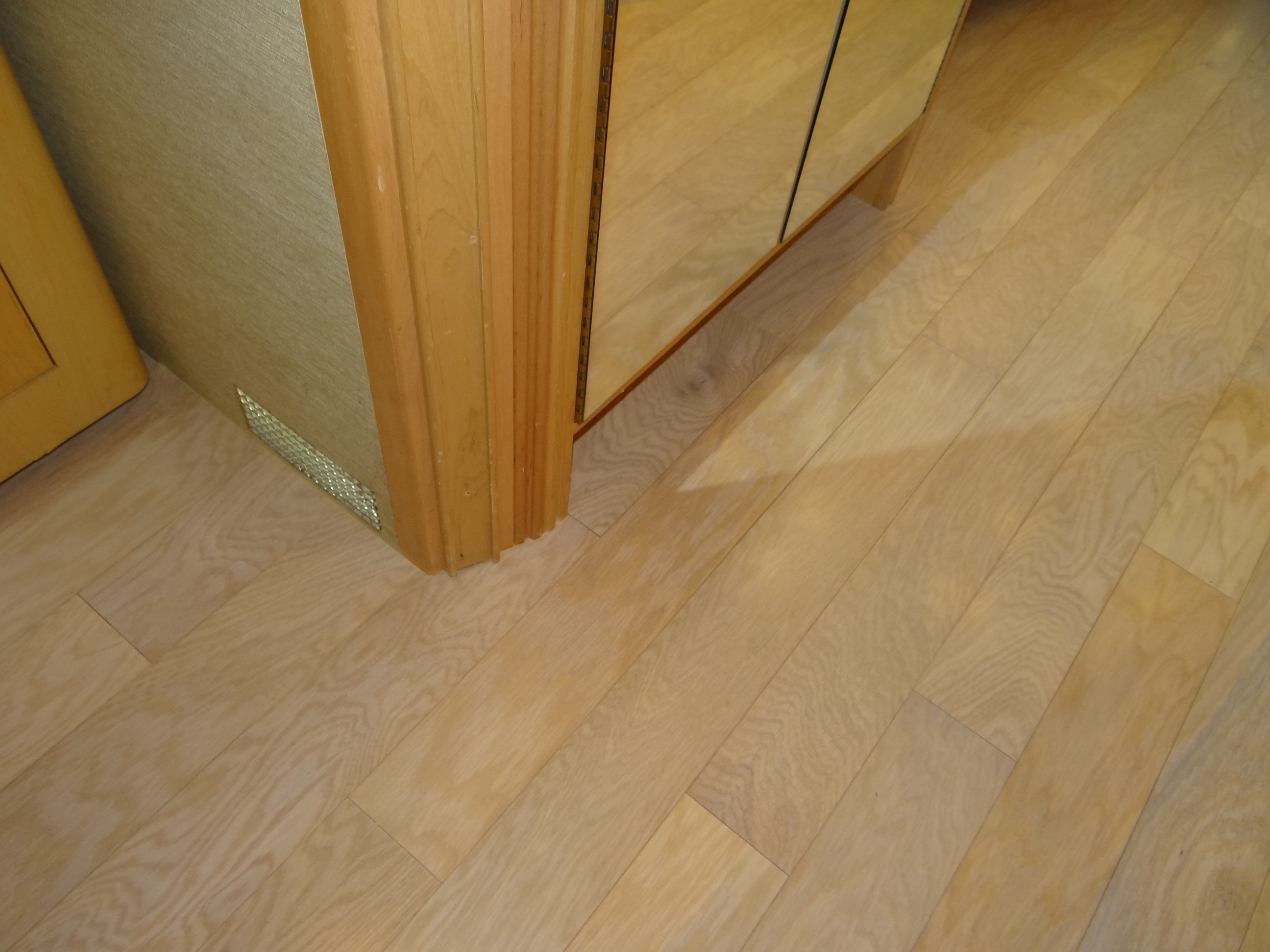

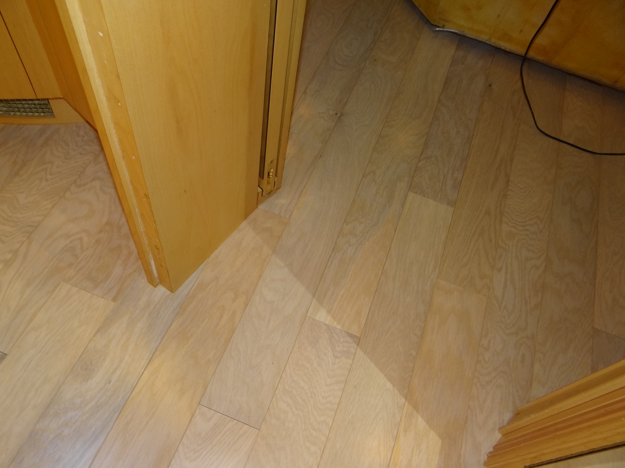

it sure is Ernie
How long does it take you to do a floor like this one ? Also , were you able to go under the Fluted door moldings or did you need to cut , cause it sure looks perfect
05-13-2017, 18:31
I cut under those molding with my Fein saw. Usually, a coach takes 10- 14 days
