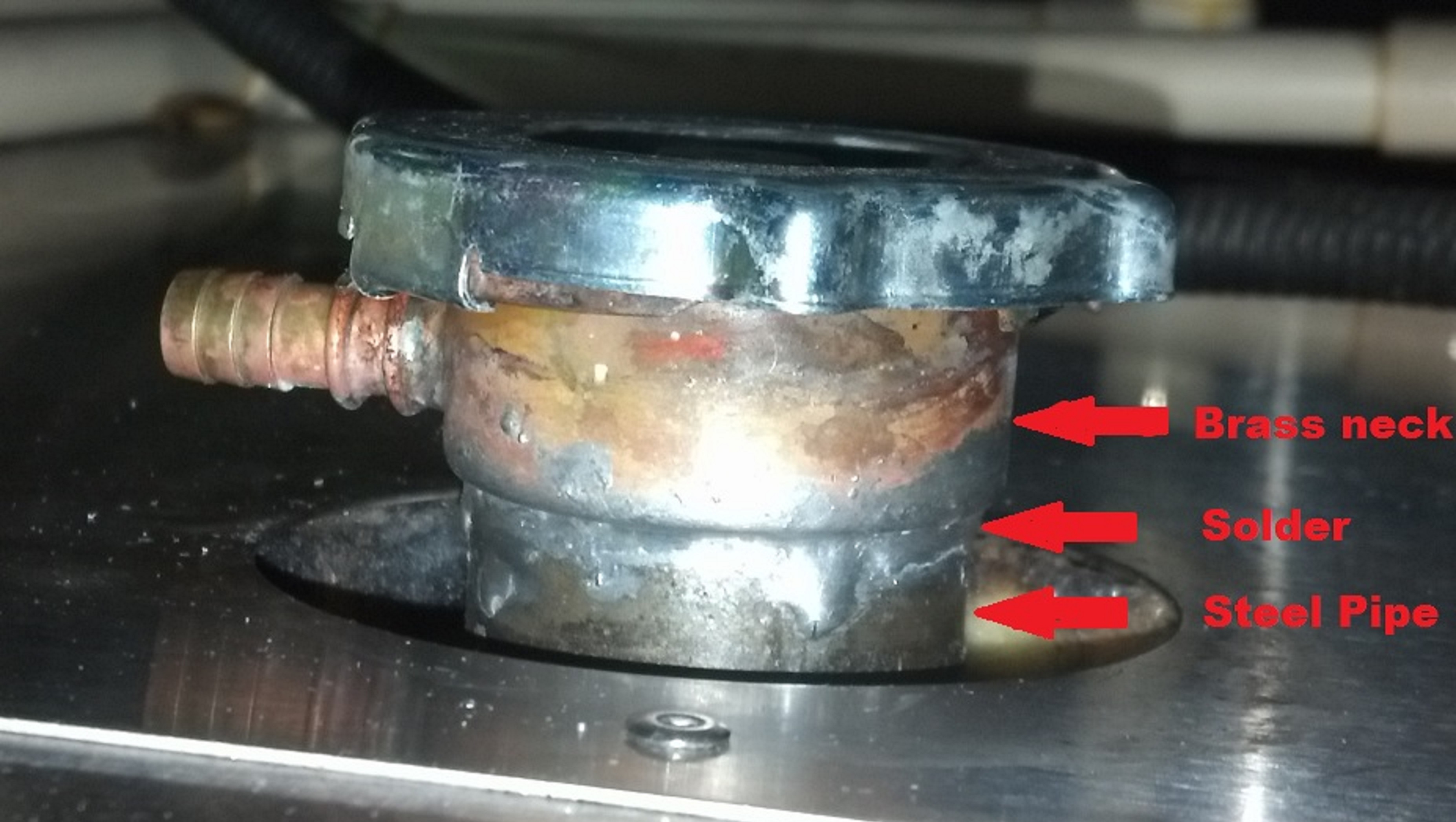

(04-04-2013 17:26)al perna Wrote: Is the Aquahot tied into the S60 coolant ? or are they 2 seperate systems ? Yes, the Aquahot has a pump that circulates hot coolant from the motor to make hydronic heat and hot water, as well as the aquahot can heat the cold engine block, so the coolant can for lack of a better explanation flow in both directions to either heat or scavenge heat So if I'm understanding you correctly it's not the filler neck to tank that gives problems, it's the brass cup to filler neck that typically leaks??? That's correct I'm imagining a steel neck that's around four inches in length and then a brass cup that's maybe half that length, Got the steel neck part correct, but the brass cup is very shallow. Actually it's flat on the bottom with a very shallow lip 1/4" max. and it's smaller in diameter than the filler tube diameter, you just center as well as you can by eye and solder it on. and the brass cup is soldered to the top half of the steel neck. Yes How does the steel neck attach to the tank? Is it welded or soldered? Welded it's steel to steel[/i] If the leak is at the cup to neck interface I may be able to get in there with a small torch... Possible, Slim Sommerville fix his Aquahot that way[i] |

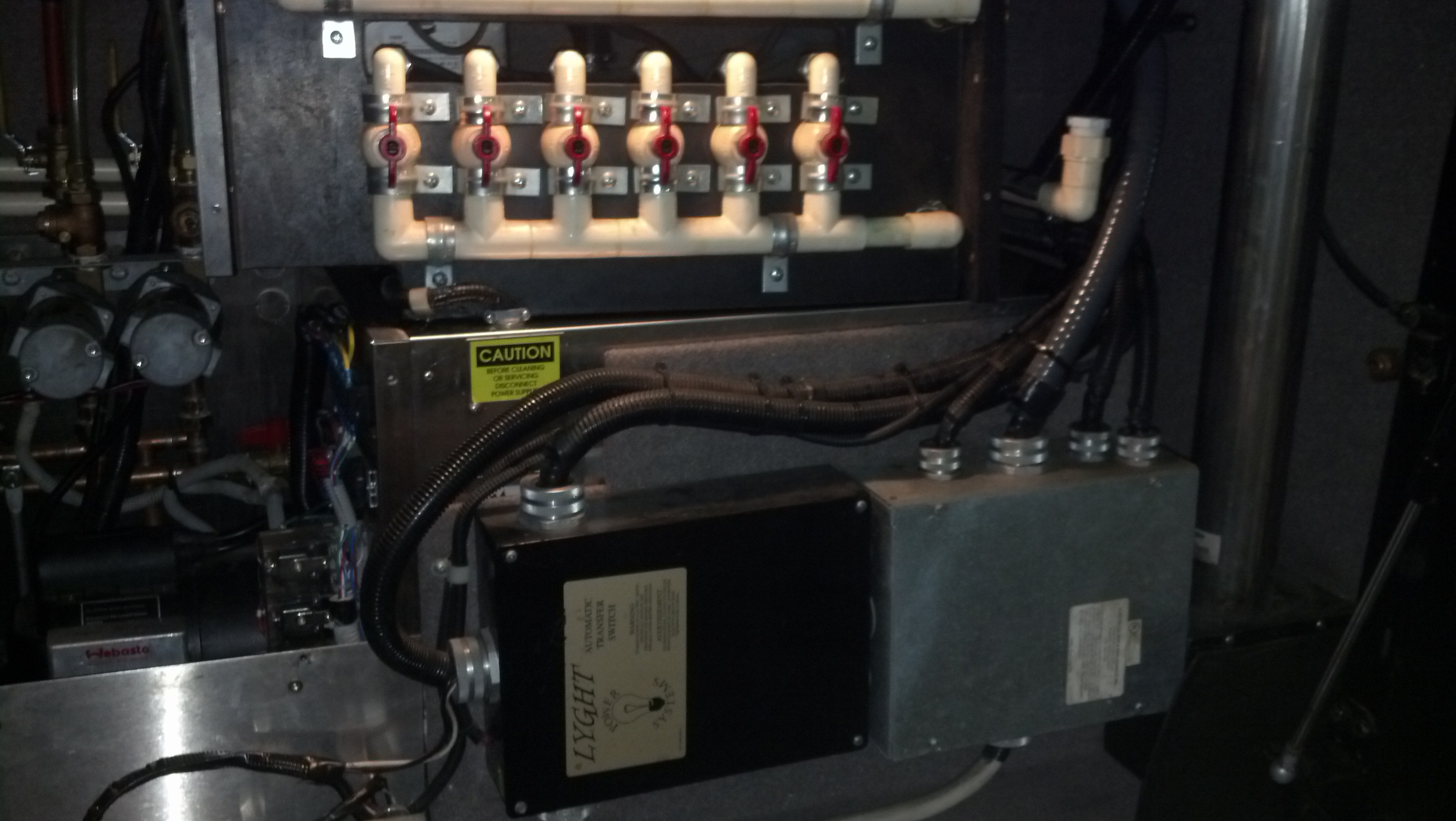

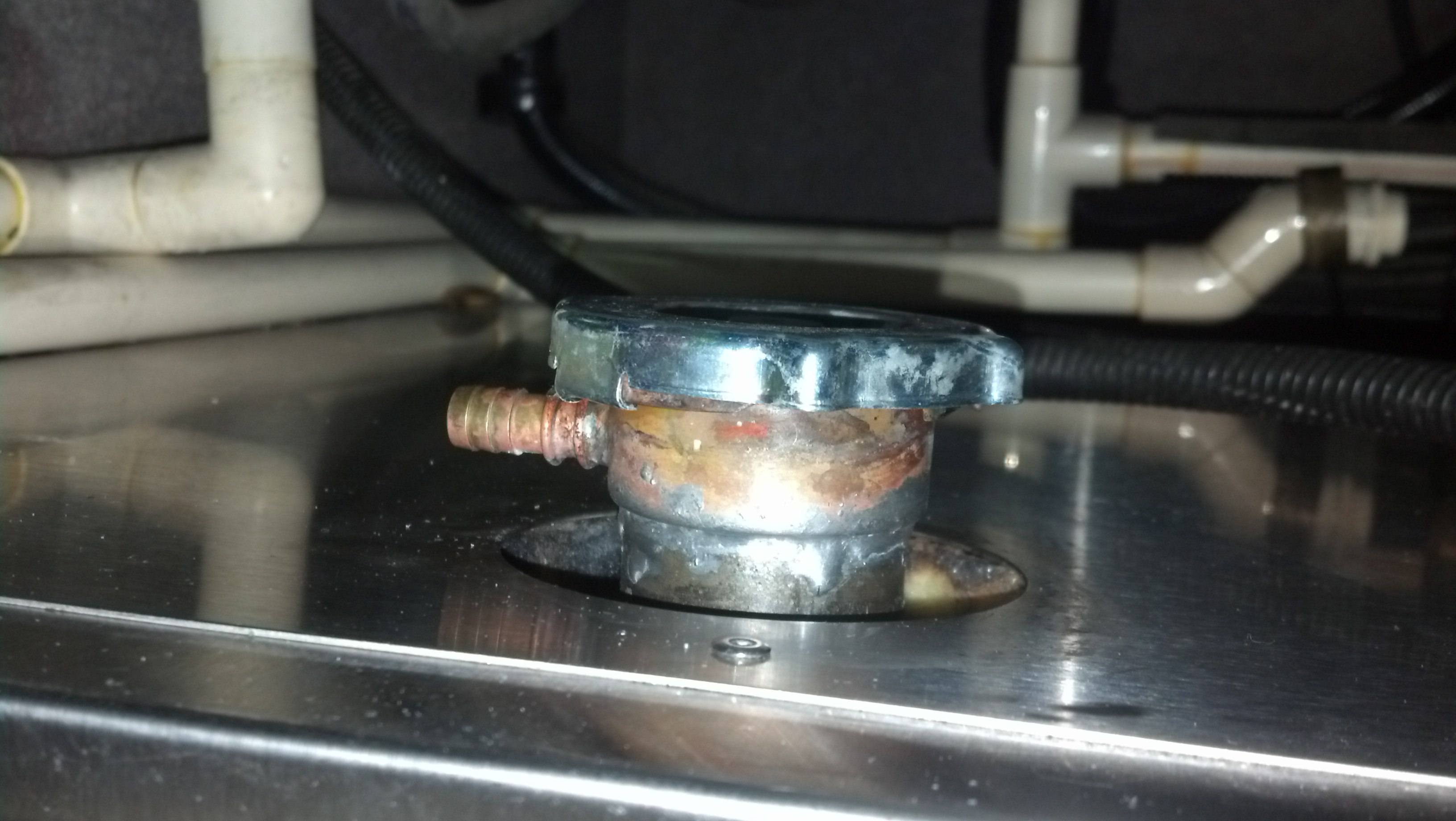

Now that cold weather is around the corner I can't postpone my aquahot repair any longer.
I unbolted the transfer switch and the domestic fresh water manifold and swung them out of the way: After pressurizing the AH boiler to 15 psi and dousing the filler neck with windex it was easy to see bubbles forming at the solder joint leak. I took a wire brush and scrubbed the old solder. I then swabbed the soldered joint with alcohol, applied flux, heated the brass neck with my propane torch and sweated in new solder. The new solder flowed nicely into the fitting. I then repressurized to 15 psi to check for leaks. Pretty simple job - what took me so long! david brady, '02 Wanderlodge LXi 'Smokey' (Sold), '04 Prevost H3 Vantare 'SpongeBob' "I don't like being wrong, but I really hate being right" |
