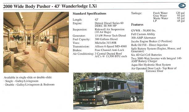

(02-18-2013 23:33)davidmbrady Wrote:(02-18-2013 22:06)Ms. Bee Wrote: Well if it was a cup of coffee, it might not spill all the way across the country, but would it not get cold??? The other thing I think that is worth noting, while I'm being an all out brown noser, is that the earlier LXi s (99's and 2000) were much weightier than the later LXi's, such as yours, David, a 2003, especially on the steer axle.I remember as a newbie speaking with you, David, for advice, when we were getting new Michelins tires put on, as to what our tire pressures should be. You told me to get the coach weighed, and how to weigh each axle separately, which we did, on a Cat Scale, and then use the Michelin chart for what tire pressure should be. When I told you what I thought our tire pressure was supposed be according the chart, just to be able to check with you that my figures were correct, you were really surprised until I told you how much our coach weighed. Our coach empty, new to us, no clothes or dishes or food or other stuff etc stored in it, just us and the dogs, topped 50k, and I think you told me yours weighed somewhere around or closer to 47K or 48K loaded? I believe on the later models, BB made a concentrated effort to lighten the load, especially on the steer axle, as it was too heavy on the earlier LXi's, I'm pretty sure that there was a recall on the steer axle. On later models after beefing up the steer and they also then decreased the size of the fuel and holding tanks to help make the coach weigh less. So Al, if he hasn't already, he should really have his coach weighed to check to see if his tire pressure is correct as you have suggested, since he has the same year as ours, one of the heavy, heavier models. Jennifer and Darrell Snell 2000 LXi ME SS Florida - Palm Harbor and McAlpin |

True, BB had so many axle Field Service Campaigns on the LXi lineup that they put the later buses on a diet. The earlier LXi's have a water tank in the pass thru bay, mine doesn't. Also, mine has a 260 gallon fuel tank as compared to the 300 gallon tank on the earlier ones. BB started with 14600# steer axles then 15500#, and finally 16000#. It would be worthwhile for Al to check the tag on his steer axle to make sure he's got an I160 for 16000#. But exceptions abound, Rob Robinson's '99 weighs in at 46750#. Mine's an 2002 and it weighs in at 47500, so it's heavier than Rob's. I have maple cabinetry as compared to laminate, also I now have hardwood floors but it originally came with a laminate resilient tile as compared to ceramic tile in some of the early ones. Some early LXi's had wood flooring which kept the weight down. Interior appointments factor into this too. Weights varied quite a bit from bird to bird throughout the LXi production run. But, clearly your correct Jennifer, at some point BB said, "let's see what we can do to reduce the weight". BTW, everything we're discussing here is for the 41' and 43'LXi built from 1998 thru 2003.
