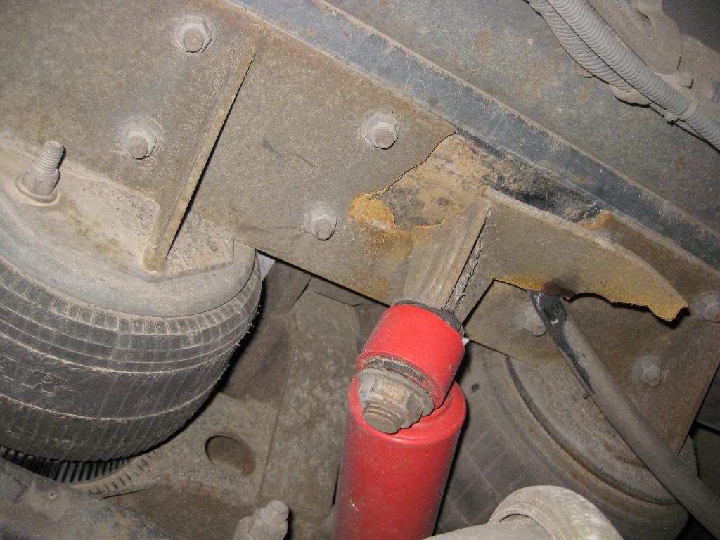

Sounds exactly like what happened when my shock mount failed. Bent the shock upper fitting and took out the air line. Fortunately for me, the failure actually occurred at the CCW facility while moving the coach from one service point to another. (I had noted an odd "popping" sound that seemed like it was coming from the passenger side suspension -- but that was an illusion as the "popping sound" was probably the last bit of the shock mount giving way on the left... Of course, the CCW folks had thoroughly checked the right side finding nothing significant...)
Be sure that the welder adds a couple of gussets to strengthen the weld -- Henderson's in Grants Pass had earlier welded the crack (short of complete failure) 6 months earlier, but their weld was insufficient. I've subsequently inspected the rewelded mount several times, and it looks clean and appears to be holding. I guess the caution here is for all the Wide Body owners to check the driver's side front shock mount and carefully examine the area around the mount for cracks. If the issue is caught before failure, you're likely to avoid having to pay for a new shock, because the failure mode seems to always bend the top of the shock. The failure is in a Ridewell component that, frankly, was of insufficient strength for the loads applied. Pete Masterson '95 Blue Bird Wanderlodge WBDA 42 (For Sale) El Sobrante CA "aeonix1@mac.com" On Feb 18, 2009, at 1:50 PM, Don Bradner wrote:

Ernie, it's not the shock, it's the upper shock mount. See the photos on my web page:
One photo 01, 02, and 04, I've outlined the added gussets in blue and drawn a line in yellow showing the crack that developed. Note: For those who notice, the locknut was replaced since the photos. The technician put 2 washers on when only one should have been used*, making the locknut not fully engage. A new locknut should always be used in this application. *The shock mount has a smooth, round landing zone for the shock to press against. Only one washer, on the outside is needed. But the inclination would be to use two washers, but then the locknut won't tighten fully to engage the locking threads. =============================================== Pete Masterson, Author of Book Design and Production: A Guide for Authors and Publishers "Aeonix1@Mac.com" Aeonix Publishing Group http://www.aeonix.com =============================================== On Feb 18, 2009, at 1:59 PM, Ernie Ekberg wrote:

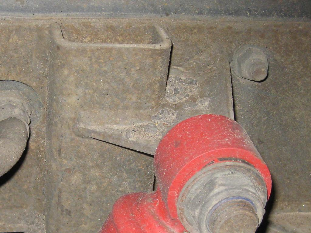

I went in and looked from the underside when I didn't know what the problem was,
but my best look at things came with blind camera shots over the top of the tires. I took many pictures at various angles, and also did this on the passenger side. This is an example of the way that side looks, and demonstrates the significant differences: http://www.arcatapet.net/image/goodmount.jpg On 2/18/2009 at 3:13 PM Leroy Eckert wrote: >I agree David. When it dries out around here I am gonna take a look at >mine.. >Leroy Eckert >1990 WB-40 Smoke N Mirrors >Dahlonega, GA >Royale Conversion > >--- On Wed, 2/18/09, David Brady >From: David Brady >Subject: Re: [WanderlodgeForum] Shock mount failure >To: WanderlodgeForum@yahoogroups.com >Date: Wednesday, February 18, 2009, 5:51 PM > > > > > > > > > > > > > I'm not a metallurgist, but from the looks of the rust on the >crack >edges, this failure has been developing for some time. Okay >everyone, it's time to crawl under your bus to check the steer >axle, street side shock mount for cracks. > >David >'02 LXi, NC > > >-----Original Message----- > >From: Don Bradner > >Sent: Feb 18, 2009 5:47 PM > >To: WanderlodgeForum@ yahoogroups. com > >Subject: Re: [WanderlodgeForum] Shock mount failure > > > > > > > > > > > > > > > > > > > > > > I'm not sure it is worse than others. The thing is I don't >think anyone has shown theirs pre-fix before. If you look at Pete >Masterson's http://homepage. mac.com/aeonix1/ Sites-Pages/ Image2.html you >will see that the tear is almost identical in location and scope as mine. >In the Bumpersbird album I can't really tell where the tear was (and it >may not have torn off). > > > >On 2/18/2009 at 5:24 PM David Brady wrote: > > > >>That's gotta be the most > >>severe case of the dreaded shock mount crack that I've ever > >>seen on a Wide Body. > > > >Don Bradner > >90 PT40 "Blue Thunder" > >My location: http://www.bbirdmaps. com/user2. cfm?user= 1 |

I wouldn't call it smash or tear - it was a very sharp edge on that contact
point that gouged the line. List for that shock is $197 - I suspect that will be a lot less than the labor of the fix! On 2/19/2009 at 1:04 AM Kurt Horvath wrote: >Welcome to the club Don. >There are a few photos of the welded mount in my album ( Bumpersbird ) >Look for #22, #44 >Did it smash the brake line or did it tear off. >Running without one brake is dooable with care as you said. >Not an uncommon occurance according to some shops. just plug the line >and go, slower of course. >The cheepest new Konis were at BB. Now that's not an option, If time >allows shop around, prices varied by 50 -60% when I went shopping to >replace mine. > >Kurt Horvath >95 PT-42 >10AC > > > >------------------------------------ > >Yahoo! Groups Links > > > |

Don, If you send a pic to Ridewell they may give you a new piece. The curb side upper shock mount is different due to the location of the panhard rod frame pivot. David Brady '02 LXi, NC Don Bradner wrote:

I think the crack was there from off-camber HWH jack parking in the
past. looks like the temper of the weld proved a brittle spot that under normal conditions would not have issue. Then the new shock absorbed more bounce but reacted equally agressive causing much more stress on the mount. I think the mount post should have less strength and be a point that can bend at failure. the tripod gussettes are a bad idea. I think problems arise when the bus air bags are dropped to be leveled but the spot is too off camber. the HWH push one side up and tilt the axle too much. at that point raising the front is effortless and and the 30 foot lever post all the stress on the tucked tire. If I was to repair that mount I would remove two bolts and make a trapazoid shape cut and replace the plate with a butt weld then build the post mount back no better than before. If you lose an airline and must drive. there is a screw set in the maxicam to turn off the parking brake. you can then plug the airline and fold it over then tape it. Greg ofTim&Greg 94ptca .--- In WanderlodgeForum@yahoogroups.com, "Don Bradner" > > I'm the latest victim of a driver's side front shock mount failure. It took out the brake line when it went. I was not far from home on the way back from Q, so I limped on in (I know, in retrospect it was too dangerous, but I kept a lonnnng following distance!) > > I've used the local Detroit dealer in Arcata (Trinity Diesel) a couple of times now for service, so I called them, and the service manager said he would swing by for a look, no charge. He ended up removing the shock and the air line, and said that he would come by the next time he was this way with a new airline. A new shock will have to be ordered (the top bent/caved in) and they will schedule an appointment to get it welded after they have that. Shock was 17 months old. > > > Don Bradner > 90 PT40 "Blue Thunder" > My location: http://www.bbirdmaps.com/user2.cfm?user=1 > |

Greg, I don't think the axle tilt puts undo stress on the shock. If you consider the steer axle in full droop on one side and full bump on the other. The angle of the axle is roughly 5 deg to the horizon, and this turns out to also be the angle of the shock. (inverse sine of (8 inches / 96 inches)). The rubber bushings in the shock can easily comply without transferring excessive forces to the mounts. I'm sure Ridewell did this basic calculation. If this were the cause then we'd be seeing similar failures on the drive axles. The cause could be shocks that bottom before bump stops (shocks too long), folks retracting their HWH jacks w/o first airing up the suspension, folks raising the front off the ground w/o first dumping air, or simply and inferior Ridewell design. After year 2000 or so, I was informed by the engineering staff at Ridewell that all their suspension systems underwent finite element analysis and subsequent redesign; consequently the LXi uses a different shock mount system than the WB's. Could be that Ridewell addressed an inherent weakness. David Brady '02 LXi, NC timvasqz wrote:
