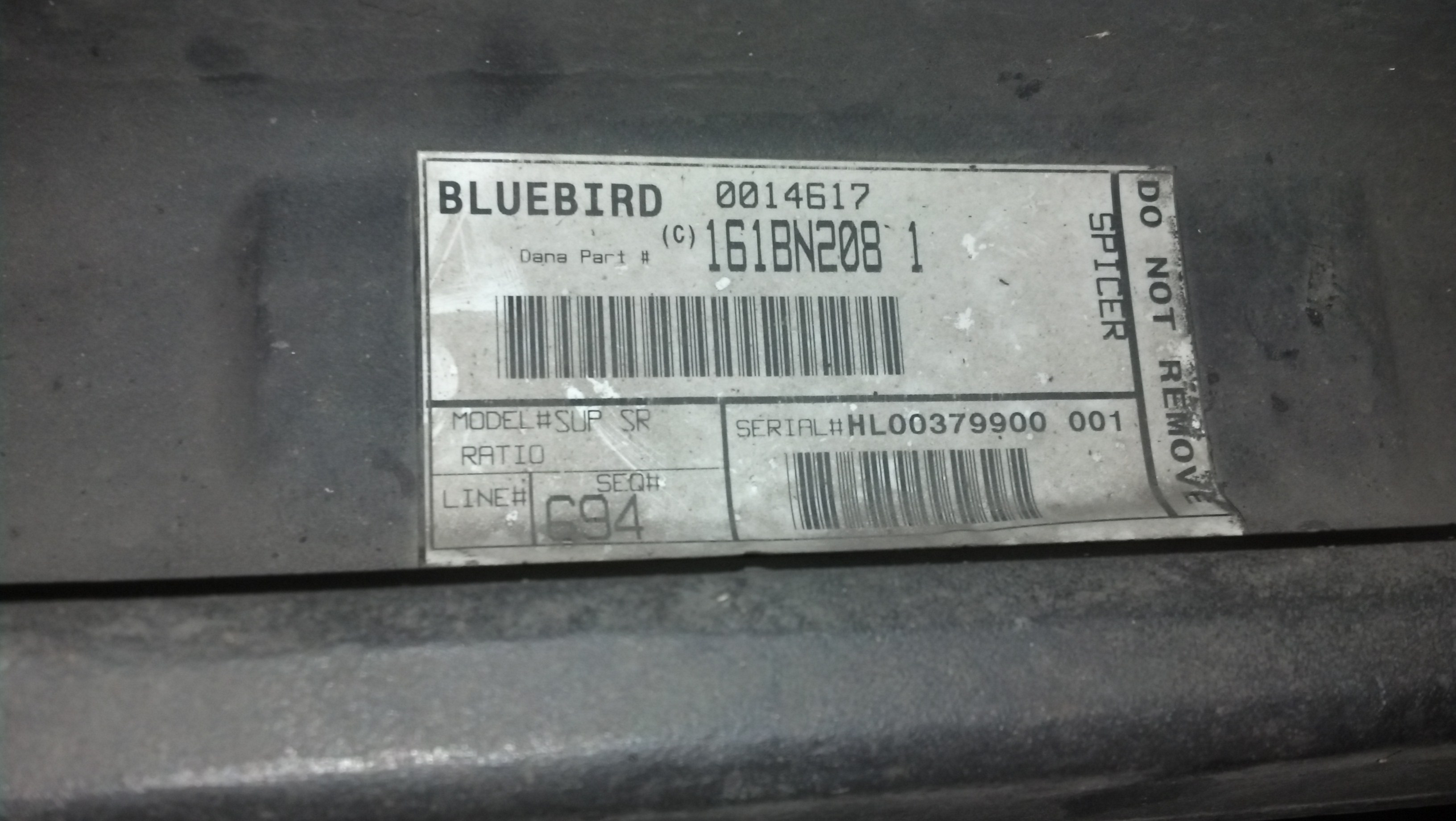

It could be that BB retained the nominal 14600 lb axle but uprated it to 15500 by changing out the hubs and/or spindles and or tie rod ends. A person in heavy vehicle manufacturing once told me that the final arbitor in axle ratings of its vehicles is the manufacturer which in this case is Blue Bird. david brady, '02 Wanderlodge LXi 'Smokey' (Sold), '04 Prevost H3 Vantare 'SpongeBob' "I don't like being wrong, but I really hate being right" |

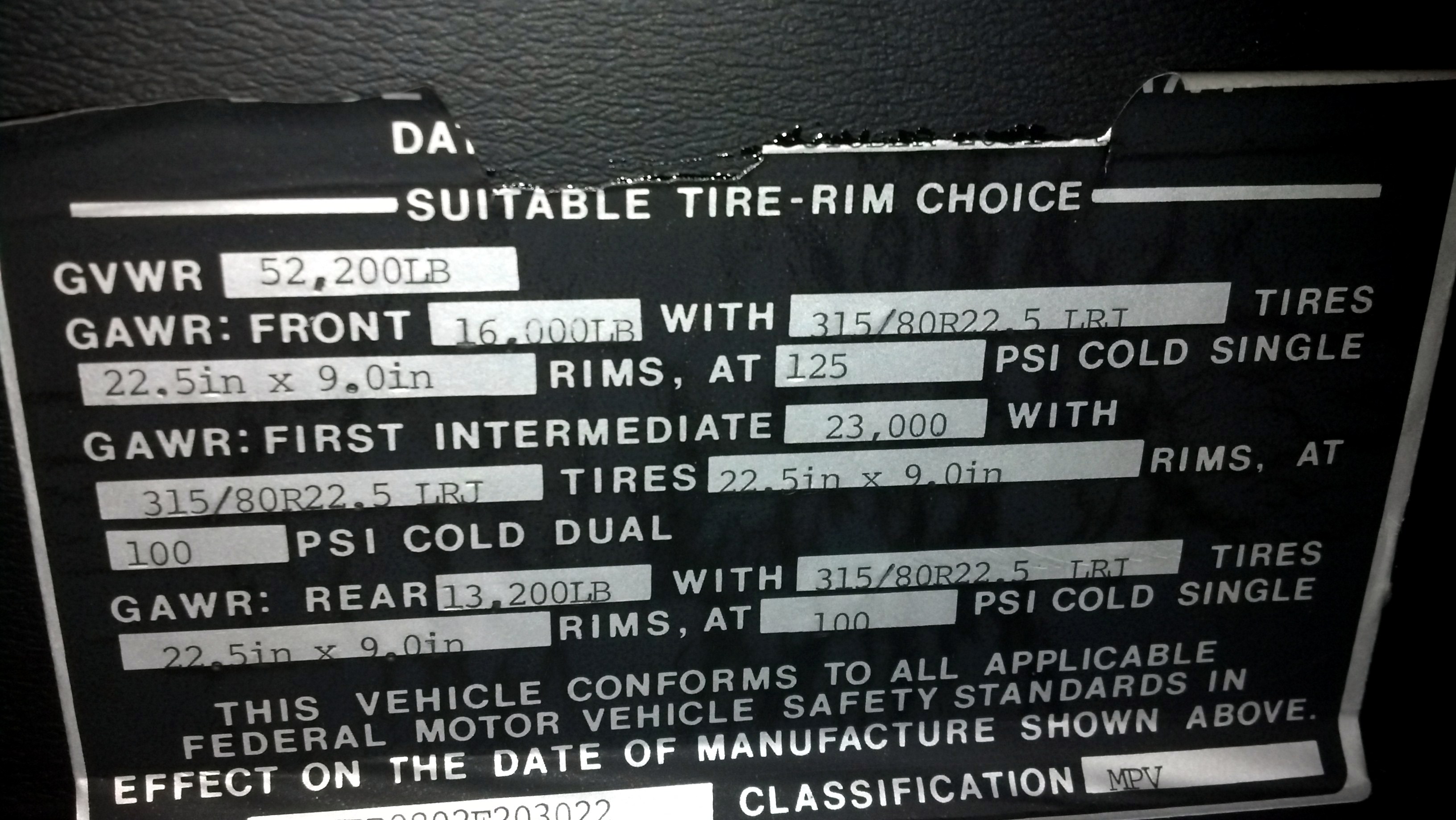

Here's my placard with axle weight ratings, (note the minimum requirement of 315/80R22.5 load range J tires; I'm currently running load range L):

Anyhow, here is my label info: DANA # 140BN1095 SER# 253-D MODEL # I 1405 RATIO 98210 (must be date code) BB 1961606 Looks like mine was never changed. So I better: 1. Clean out bays and storage of excess inventory and tools. 2. Get rid of extra bay mounted water tank? 3. Keep my fuel tank max at 1/2 full. 4. Any other tips, owners? Morey Zuber 99LXi41 |

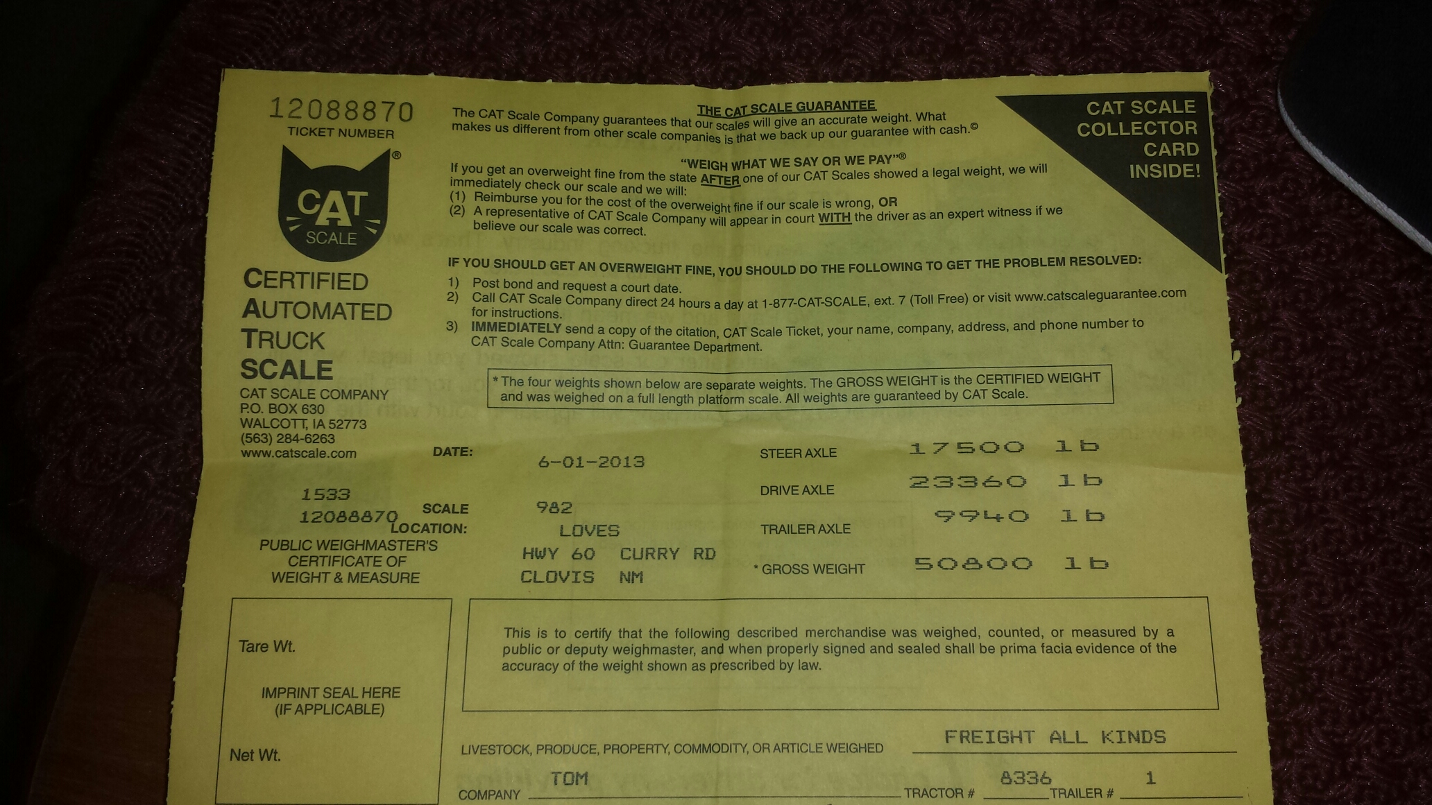

i just weighed my 2002 newell so i thought i would share my data with you guys for fun.
tom after we filled with fuel today we unhooked the car and weighed the coach. we weighed with empty waste tank, full water tank and full fuel tank and darlene and i at our seats. attached is the picture of the scale readout. it is a little confusing to me as it is lower than i expected. my vin plate shows gross weight of 55,000 pounds with 12k at tag, 18k at steer and 25k at drive. corresponding tire pressures on the vin plates for 215/88r22.5 lrl are 100psi at tag, 110psi at drive and 140 psi at steer i have changed the steer to 365/70r22.5 lrl and have been running 115psi. my scale readings were 9940lbs tag, 17500 steer and 23360 drive for a total of 50,800 the michelin chart show that the tire pressures could be wayyy lower than what i am running. it was a cat certified scale. tom 2002 Two Slide Newell Coach 608 DD Series 60, Allison 6 speed |

Impressive numbers Tom. Thanks for sharing. Where are the tanks located on your Newell (water and fuel), and how large are they? Whose IFS do you run? I'd be very tempted to reduce the tire pressure on those massive 365's!
