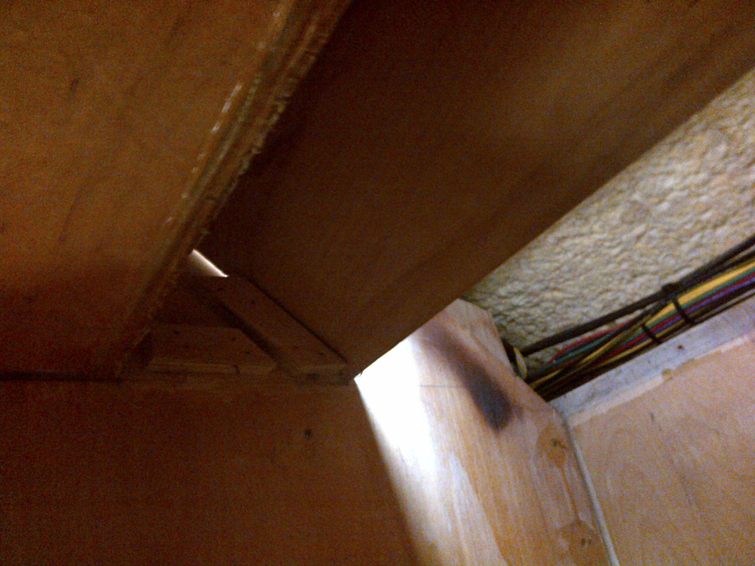

Some folks have reported the discoloration that you see. Other's haven't. I'm confused as to whether it's actually charred wood (pyrolysis) or is it carbon build up from non-ideal or initial combustion mixtures? david brady, '02 Wanderlodge LXi 'Smokey' (Sold), '04 Prevost H3 Vantare 'SpongeBob' "I don't like being wrong, but I really hate being right" |

(06-28-2013 15:51)davidmbrady Wrote: Corey, Good question, but I've never seen LP gas carbon, have you? Maybe residue from mud dauber burn off?? |

As far as I know incomplete propane combustion will put off carbon. (I'm don't want to be a pain, just trying to gauge how much at risk the rest of us are). I fully support your choice to swap out to a compressor fridge. Did you see my post (#8) where I linked to Nodine's RF197 conversion?

Cool, glad to make this an issue, but hope it's not. Either way, I needed to make a decision due to the fridge dying. It is possible that is just carbon, I'll look closer when I get back down to the RV. I do believe there is significant risk as there have been definite fires due to this specific refer. I think I'll save my carcass for the eventual class action suit!!

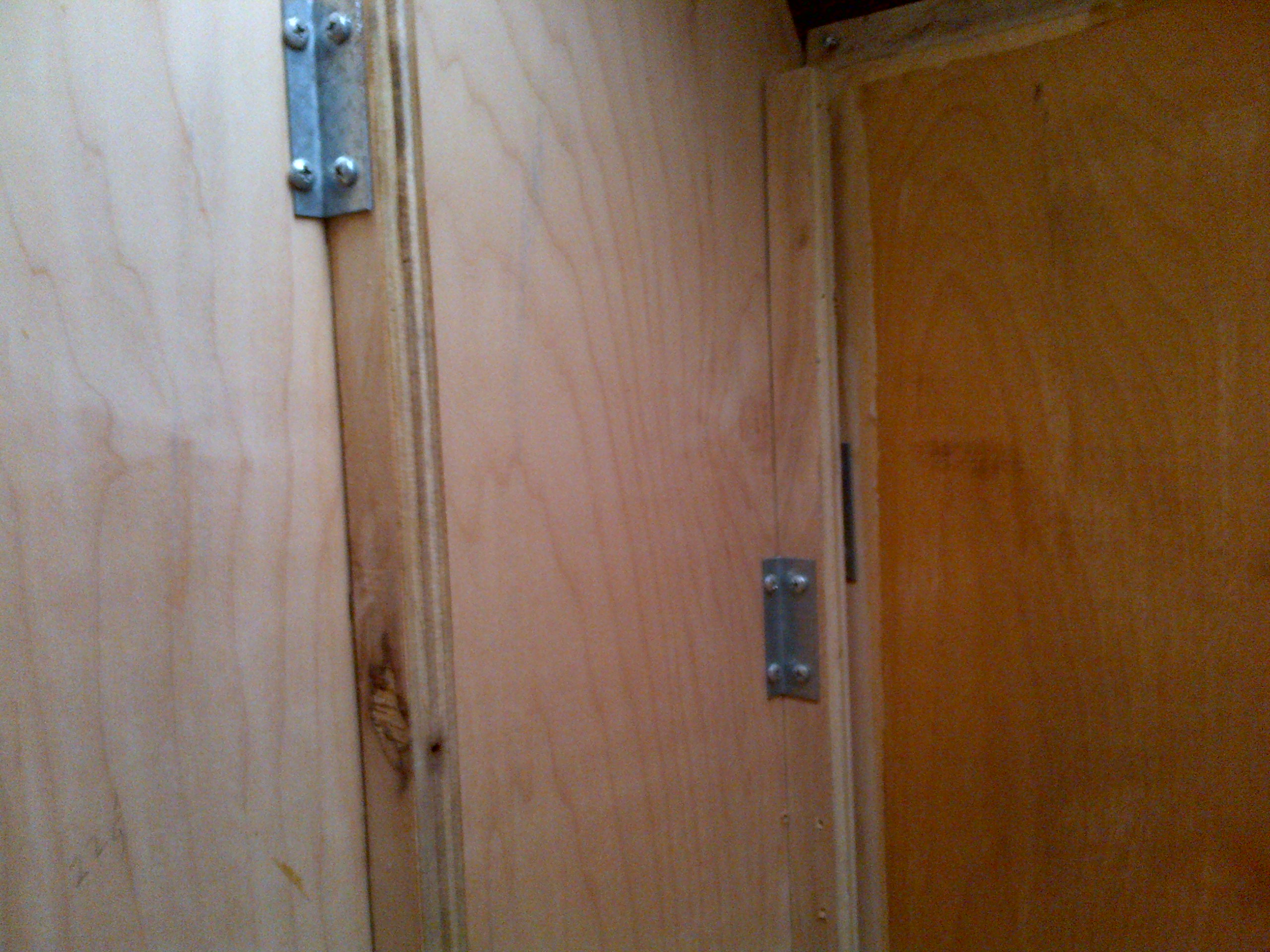

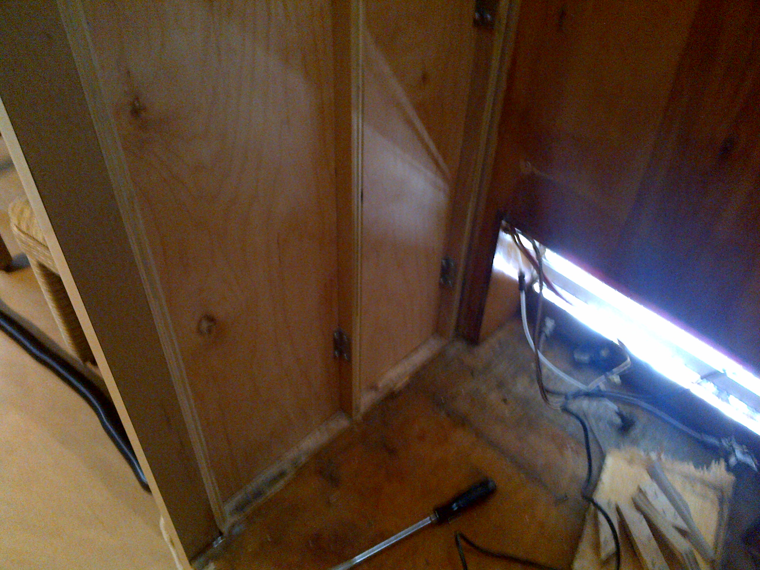

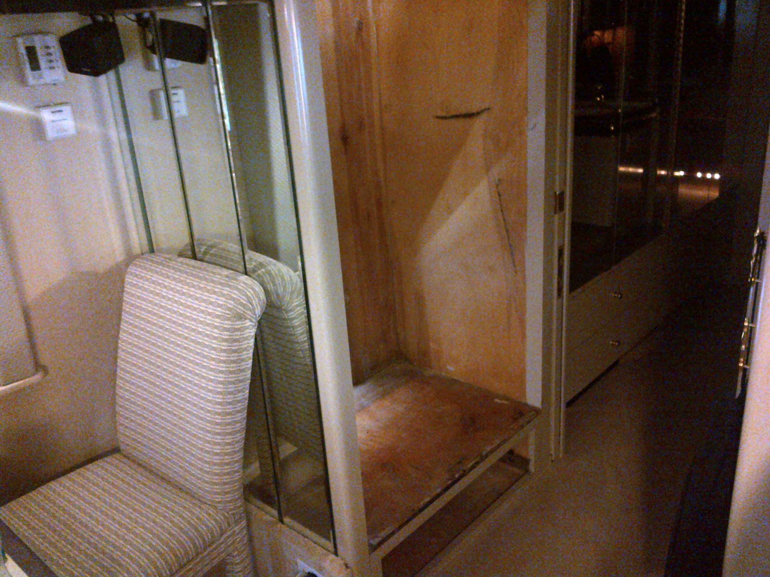

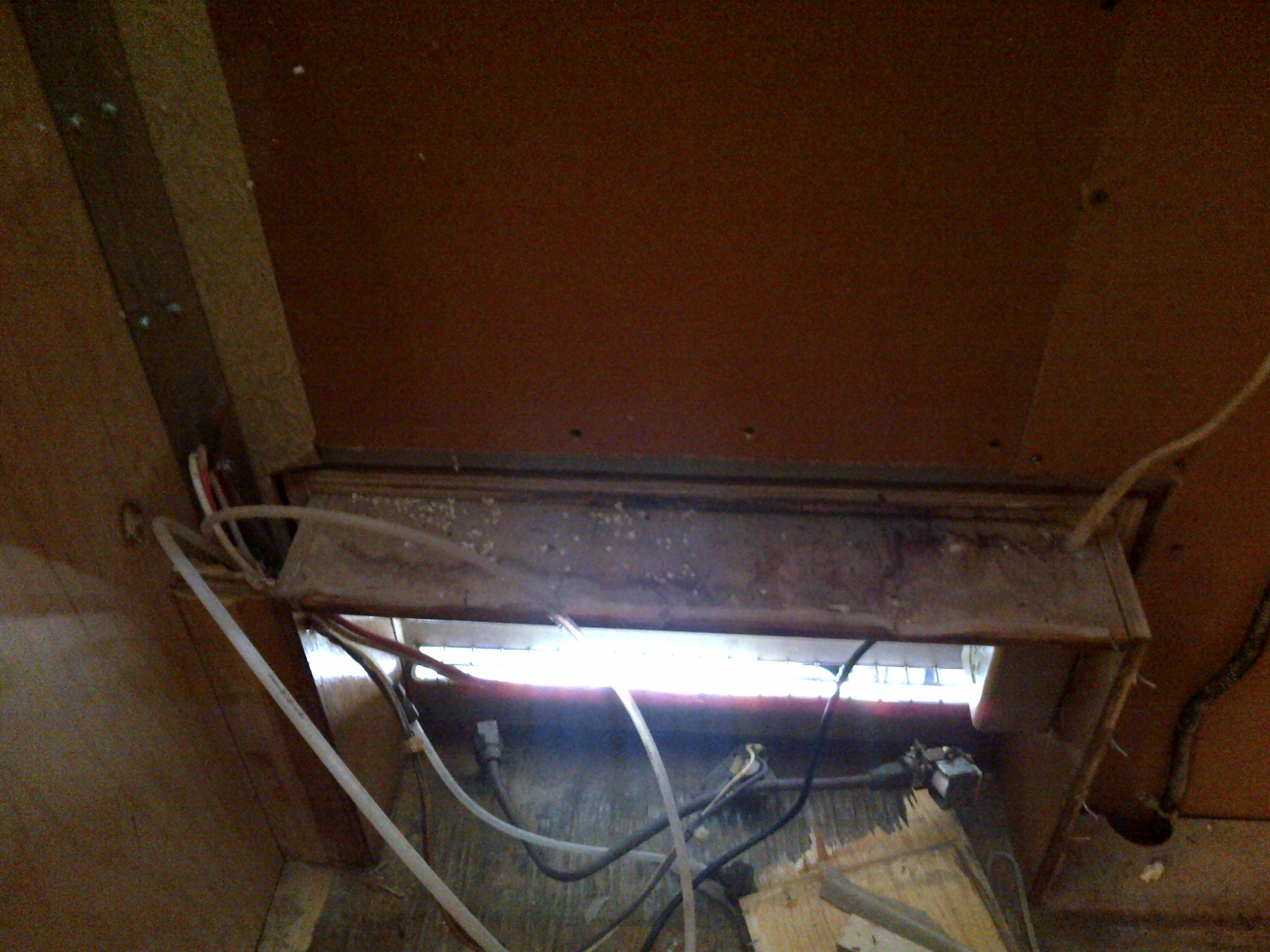

Yesterday we took the old Dometic apart and learned a bunch that may be helpful. I could not verify if the black charred spots were true heat charring or just off gassing. Could be either, in any case doesn't add confidence. Start by removing the doors and all the interior racks from the Dometic. Once you remove the Dometic from the wall, it makes sense to take the cooling unit off and remove it from the bus separately, it is more than half the weight of the entire unit and it makes getting the Dometic out the door a breeze. Essentially, you want to remove all the screws you can find inside the fridge then on the backside that are obvious. Also, unclip wires, etc and peel or slice the duct tape that hold the cooling unit in place (this will be obvious to you when you get into the job). When disconnected, the cooling unit comes out as one big, heavy and awkward part. It is easy to maneuver out the door, but be careful to remember it is full of ammonia!!!. Then the empty fridge box is light and narrower and also fits out the door. Here is the hole you are left with... What is interesting about the cavity for the gas absorption unit, is that it needs to be a completely sealed space. This means there was a lot of extra plywood and silicone used to make the space vent from the bottom. The great news here (in the LXi anyway) is that if you dismantle the "interior box" you will gain about 2" on the sides and 3.5" in the rear. Basically, you have the entire space to the wall with no obstructions. Here are some pics that may help explain. Top empty box removal must be done first in order to easily remove side panels. |
