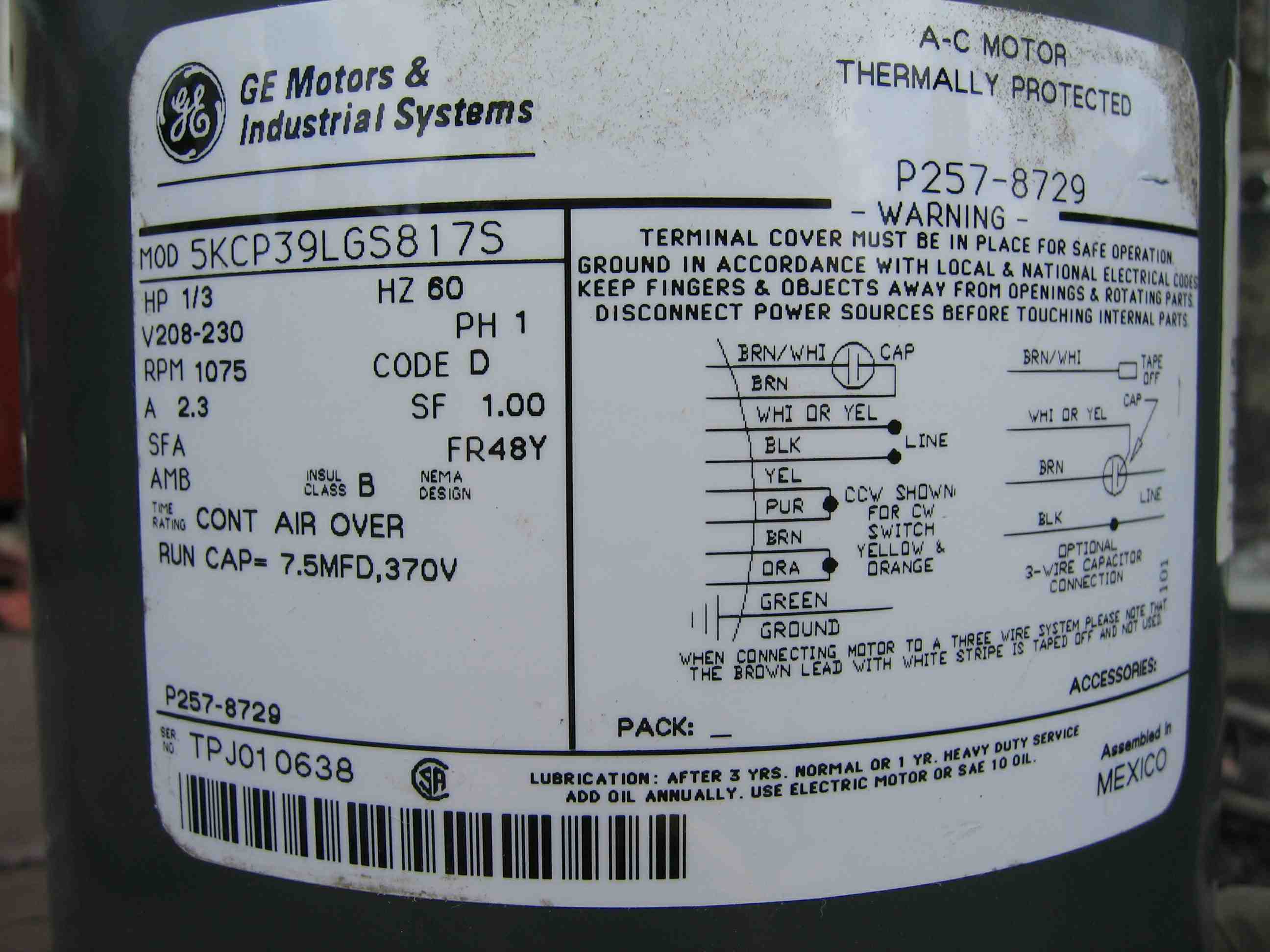

(08-01-2013 19:20)davidmbrady Wrote: Here's your motor. It's also on ebay. I ordered that motor from Ebay, but the site doesn't calculate shipping. Ultimately, the shipping charge was quoted at $30 in a follow-up email, but method was not specified. This is $10 greater than most other vendors. I'll see how the process goes. Searching Ebay for all 1/3 HP HVAC motors yielded many similar units, made overseas, at similar pricing. Do the motors on the newer Powertech units use ball-bearing or sleeve bearings? Thanks for the help. --M.R.Kane 1987 PT40 'Sleipnir' currently Iron River, MI |

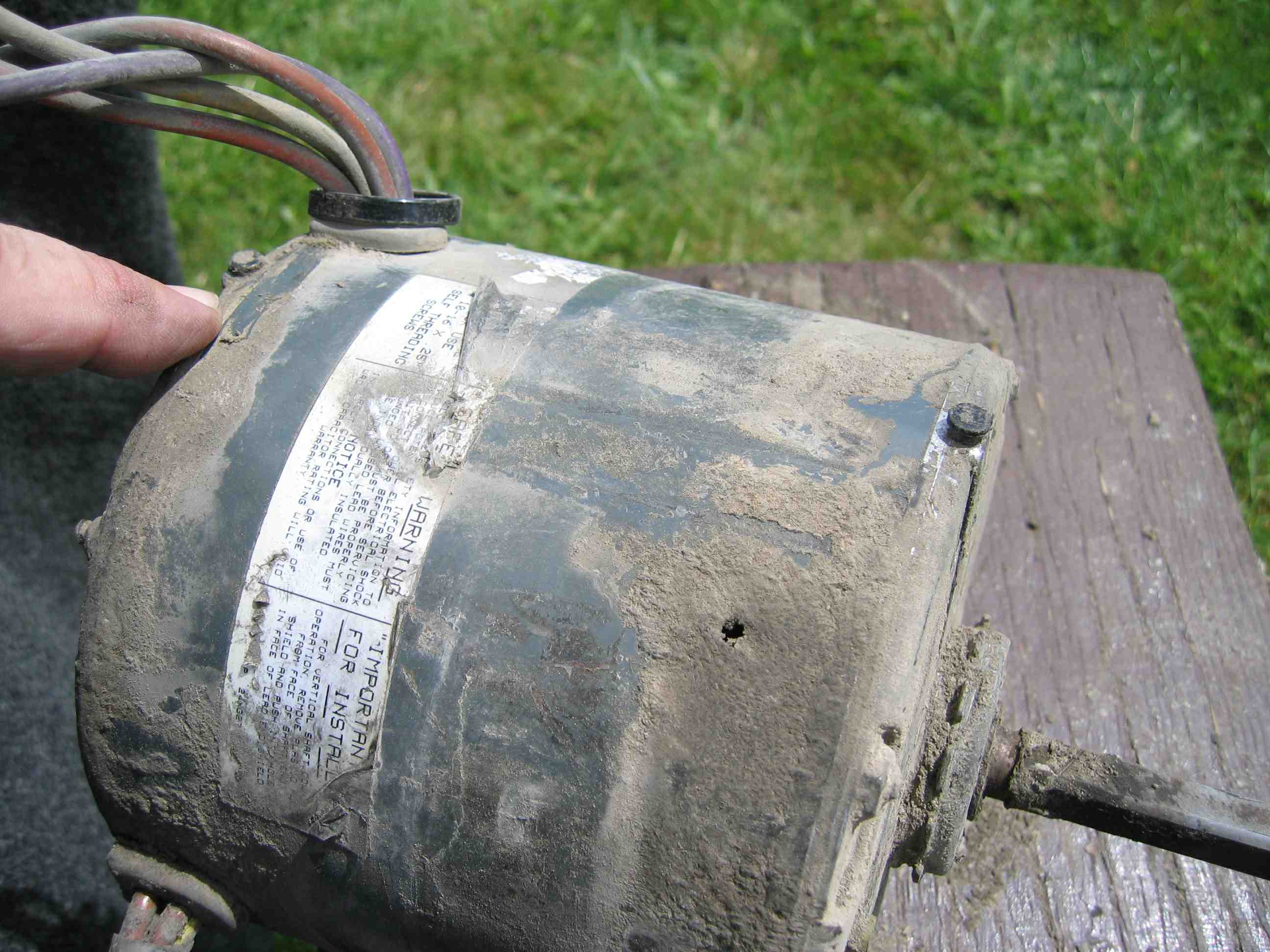

I think that's what mine is, because it has oiling(sp) ports on the ends. If I spin it by hand, it turns for awhile.

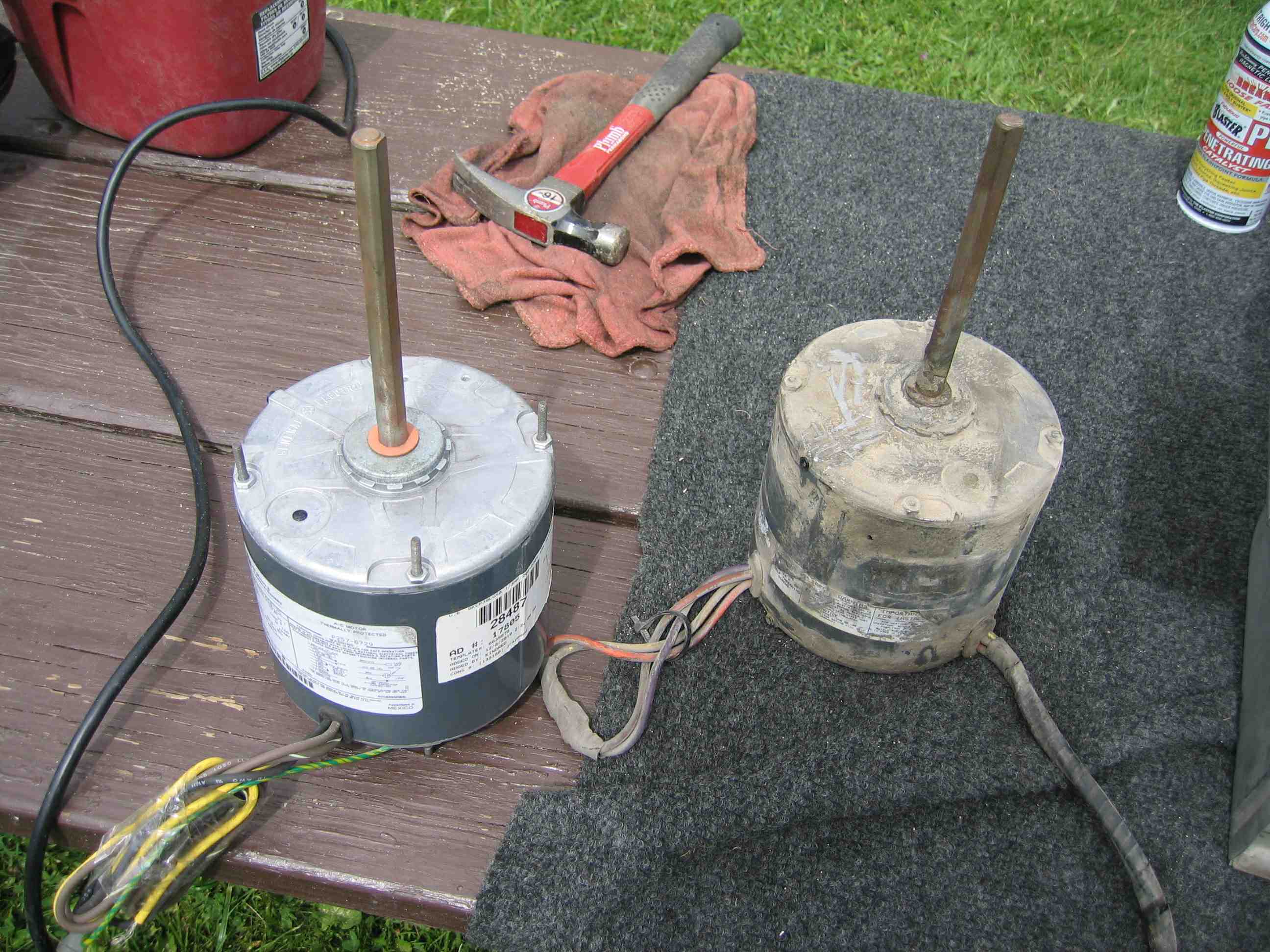

08-08-2013, 21:27
(This post was last modified: 08-09-2013 16:45 by mrkane.)
RE: Down-draft radiator fan failure

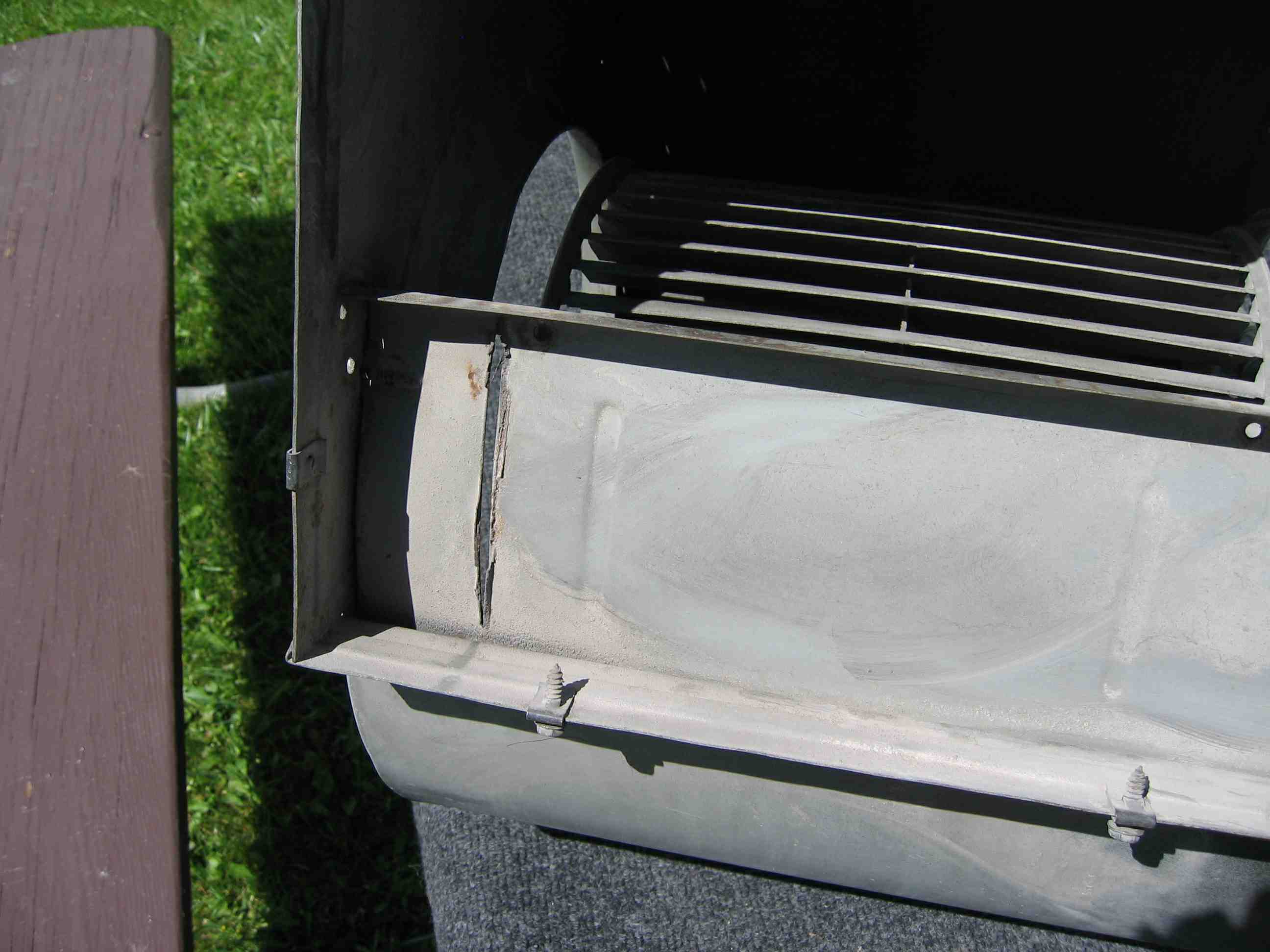

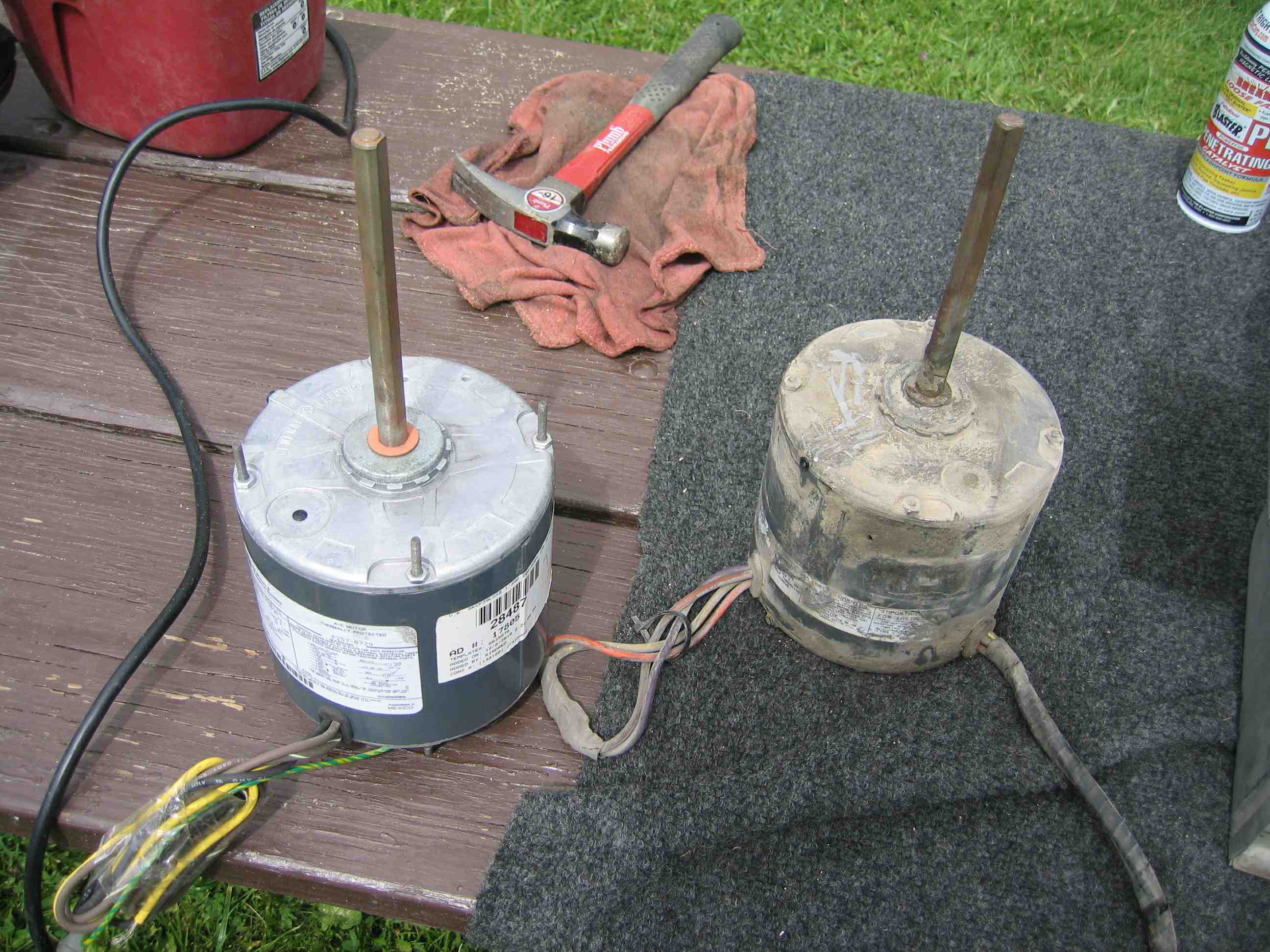

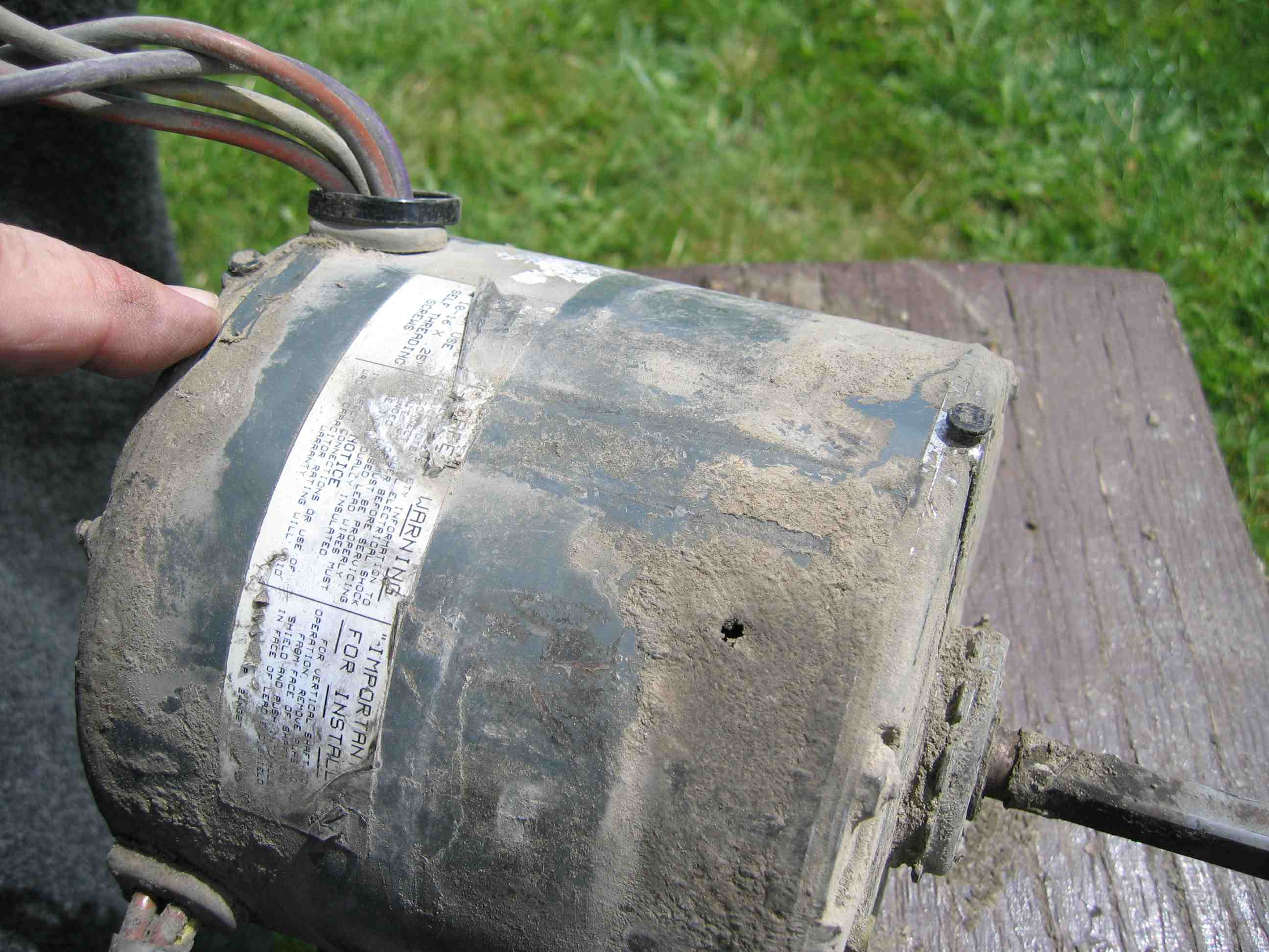

(08-02-2013 18:29)davidbrady Wrote: Do you know for certain that you're replacing the original fan motor (the motor that your bus shipped with from Blue Bird)? Looks original, but there isn't any documentation. This coach was purchased from a consignment dealer. Built a cradle and removed the fan today. Still waiting for the new motor. Update: The motor arrived, not well packed, IMO, but good enough. Looks identical to old one, except made in Mexico, rather than USA. Question to Steve: Do your oiling ports look like this? These were mounted downward on the old motor. David, this pic shows a slice in the housing made by the blower, so I bet there was a previous repair. --M.R.Kane 1987 PT40 'Sleipnir' currently Iron River, MI |
