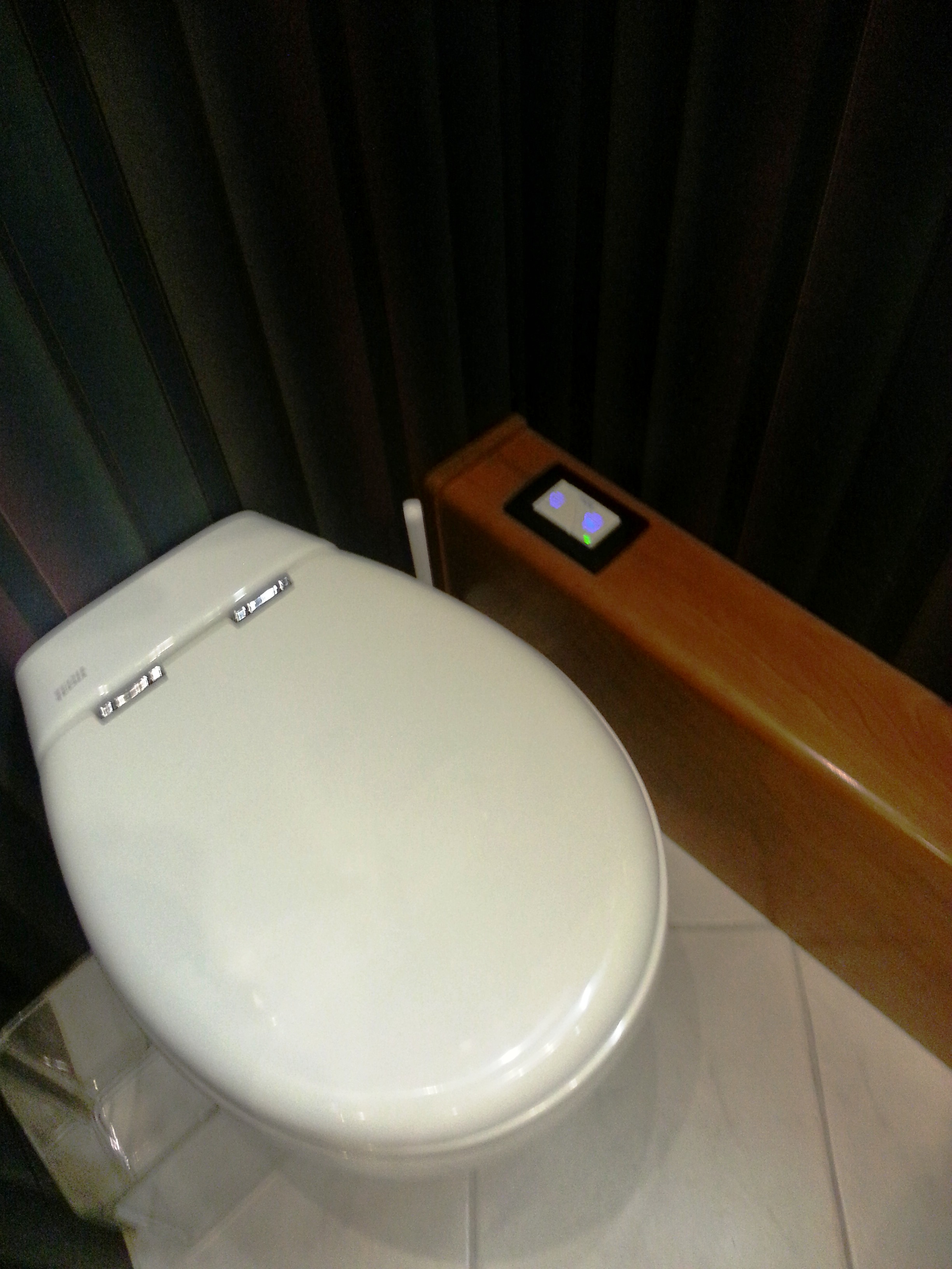

Greg, before you settle for a gravity flow toilet, you might want to consider another option. I think there is some horizontal plumbing in an LXi that makes a gravity flow toilet not to work efficiently. This is the toilet model I have in my LXi. I think it is made by Thetford. I'm presently away from my bus but I will be back Monday. If this interests you, I can get you more specifics then.
This toilet works excellent. It has a lite flush and a heavy flush operation with the push of a button. The electric controls go to sleep after a period of non-use.
It seems so unnecessary to have to deal with all the pneumatics associated with the Microphors.
