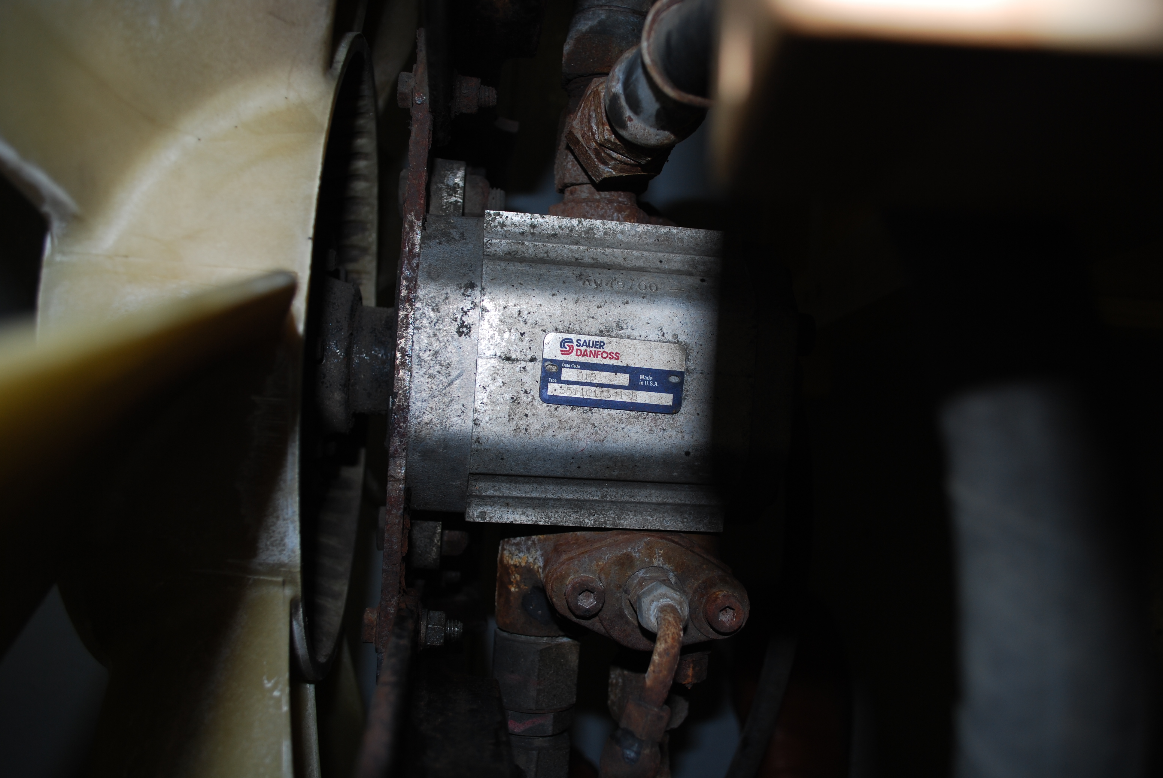

Attached is a pic of my old fan motor. If you enlarge the photo to it's full size you should be able to read the part number. It looks like a Sauer Danfoss part number to me: david brady, '02 Wanderlodge LXi 'Smokey' (Sold), '04 Prevost H3 Vantare 'SpongeBob' "I don't like being wrong, but I really hate being right" |

You're right, Flint Hydrostatics didn't recognize the number, but Berenson, Houston did, it is a unit made in England and is over double the price of $461 for the SNU3 etc motor. Now chasing the 551101134190. Morey Zuber 99LXi41 |

Chuck, thanks- David's number worked, the only problem for awhile is none of the sources had a motor. Blue Bird service centers, Google search hydraulic dealers, all had to order. The LXI pump is built only in England, not USA. Old motor had the same number on plate. We couldn't read it in the engine compartment with the light glare until we got it out.
