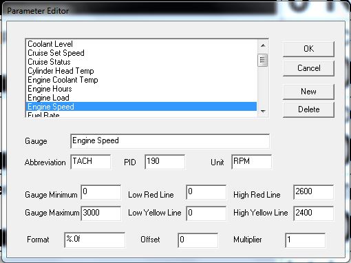

I thought you guys might like to see the steps required to add a Fan Speed gauge to VMSpc.
First bring up the VMSpc Parameter Editor. Here's a snippet of the editor:

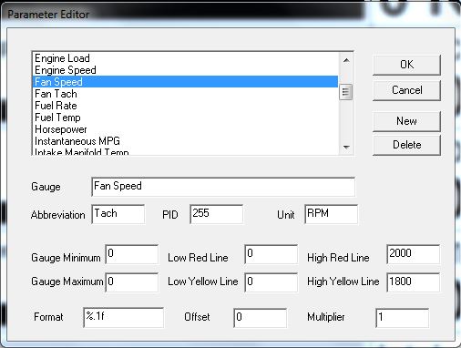

For my Fan Tachometer I'd start by choosing a similar PID that VMSpc already understands. In this case I chose "Engine Speed". This means I'd use the same J1578 encoding for my Fan Tach as is used by the Engine Speed PID 190. Now all I need to do is define the new PID value and assign the gauge min, max, red line, and yellow line values. In the snippet below I arbitrarily chose PID 255; I'm assuming there's some proprietary PID space available, maybe a bad assumption. I'm also assuming that what VMSpc needs to know to decode the PID is described in "Format", "Offset", and "Multiplier", which I left unchanged from what's used for "Engine Speed". This needs to be verified:

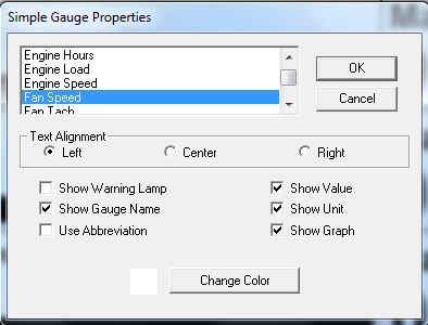

Then under Gauges I select "New Simple Gauge", choose "Fan Speed", click "left alignment", and click "show gauge name", "value, unit", and "graph":

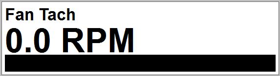

And here's my gauge:
This may work assuming there's some proprietary PID space that I can use, also it needs to be verified with Silverleaf.

I would NOT choose PID 255. PID 255 is a continuation PID, which indicates the next byte is a PID in the range of 256 to 511.
The PID's are arranged in an order, single byte data PID's run from 0 to 128. Double byte PIDs run from 128 to 191, and variable byte parameters run above this. This is all modulo 256, and a PID of 255 indicates an extension PID, and the next byte indicates the PID. It can be extended 3 times to give PID values up to 1024.
I don't know how Silverleaf expects you to do this, but I would assume you need to chose a PID that does not get sent in your vehicle. In that case I would chose something like 180, which is normally trailer weight, but would be a two-byte data value.
PS: Are you looking for actual speed, or the fact that you're on high or low setting. PID 26 is already defined as "Estimated Percent Fan Speed", but expects a percentage value, so it is a single byte value. Never-mind, I see from your example that you are going to send the actual RPM, so a two byte data PID is more appropriate.
