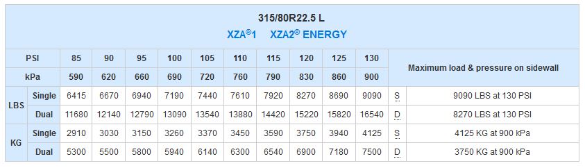

					Thanks for all of your help. I will be taking my sway bar off and getting the  Koni Adj. Shocks. Would anyone know the Koni part # for the proper shocks for the 2000 lxi? I'm reluctant to mess with front tire pressure. My coach carries 16,000 lbs on the front axel and according to tire pressure charts I should maintain 130PSI in the tires, which I do. Larry@2000lxi larryevans1201@gmai.com | |||

					Hi Larry, At 16,000 lbs on the steer axle, Michelin recommends 115 psi: Look to the left for LBS, then look fro the "Single" row, then scoot over to 7920 lbs and up to 115 psi. That's 7920 lbs per tire or 15840 lbs total for the steer axle. 130 psi will loosen the fillings in your teeth! LOL! Or, you can go over here to the Prevost Tire Pressure Calculator, choose "front axle" and 315 tires and 15840 to 16539 lbs, and you'll also get 115 psi. david brady, '02 Wanderlodge LXi 'Smokey' (Sold), '04 Prevost H3 Vantare 'SpongeBob' "I don't like being wrong, but I really hate being right" | |||

					Thanks David, glad i mentioned the tire pressure. I'll lower that pressure. At  56,000 miles do you think the front shocks need replaced or just uncouple the anti sway bar and give it a try? | |||

					Nice little chart David, thanks for sharing
