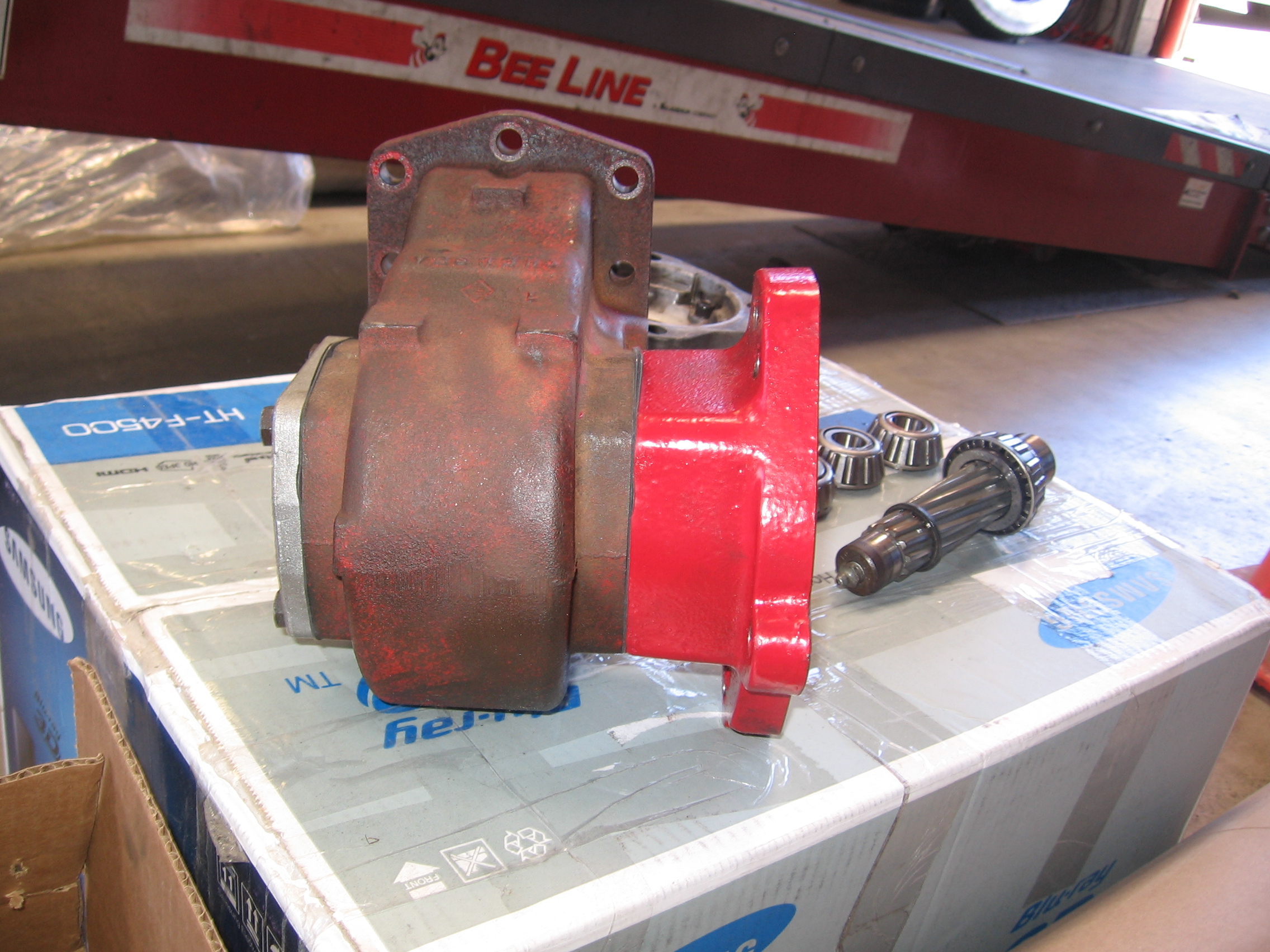

I'm posting a few pics below to show folks that the 7/8" PTO can be rebuilt as a 1" greasable or wet splined PTO. I am sure that the cost is much less than a new PTO, but at this time I do not have all the invoices to say exactly what the cost is.
It includes the -129 Kit, 3 new larger bearings, end cap to receive the 1" pump & an end cap to replace the cap with the grease fitting.
More to come
