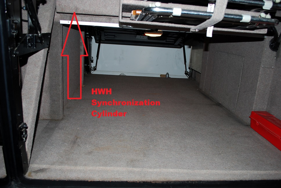

Hi Al,
On the LXi, the synchronization cylinder is located in the curbside first basement bay, illustrated by the red arrow in this pic: The room cylinders are located with the ram tubes. All of the HWH docs are located in our Document Library at Document Library -> House -> HWH Here's a document that describes the procedure for replacing a room cylinder: Room Extension Cylinder Replacement, by HWH, and here's the document that describes the part numbers for the room and synchronization cylinders: Blue Bird Room Extension Assemblies, by HWH. Sorry, but I have no hands-on experience with replacing the room or sync cylinders. For my entire 9 year ownership my LXi slide was trouble free, 100% reliable. It's a very robust system! ![]() Here's a list of HWH Master Service Centers, Dealers, and Service Centers. david brady, '02 Wanderlodge LXi 'Smokey' (Sold), '04 Prevost H3 Vantare 'SpongeBob' "I don't like being wrong, but I really hate being right" |
