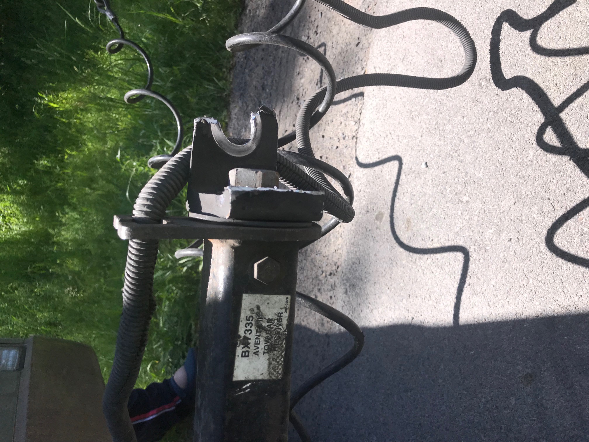

Well, there used to be a Blue Ox tow bar here. No longer!
[attachment=2122]

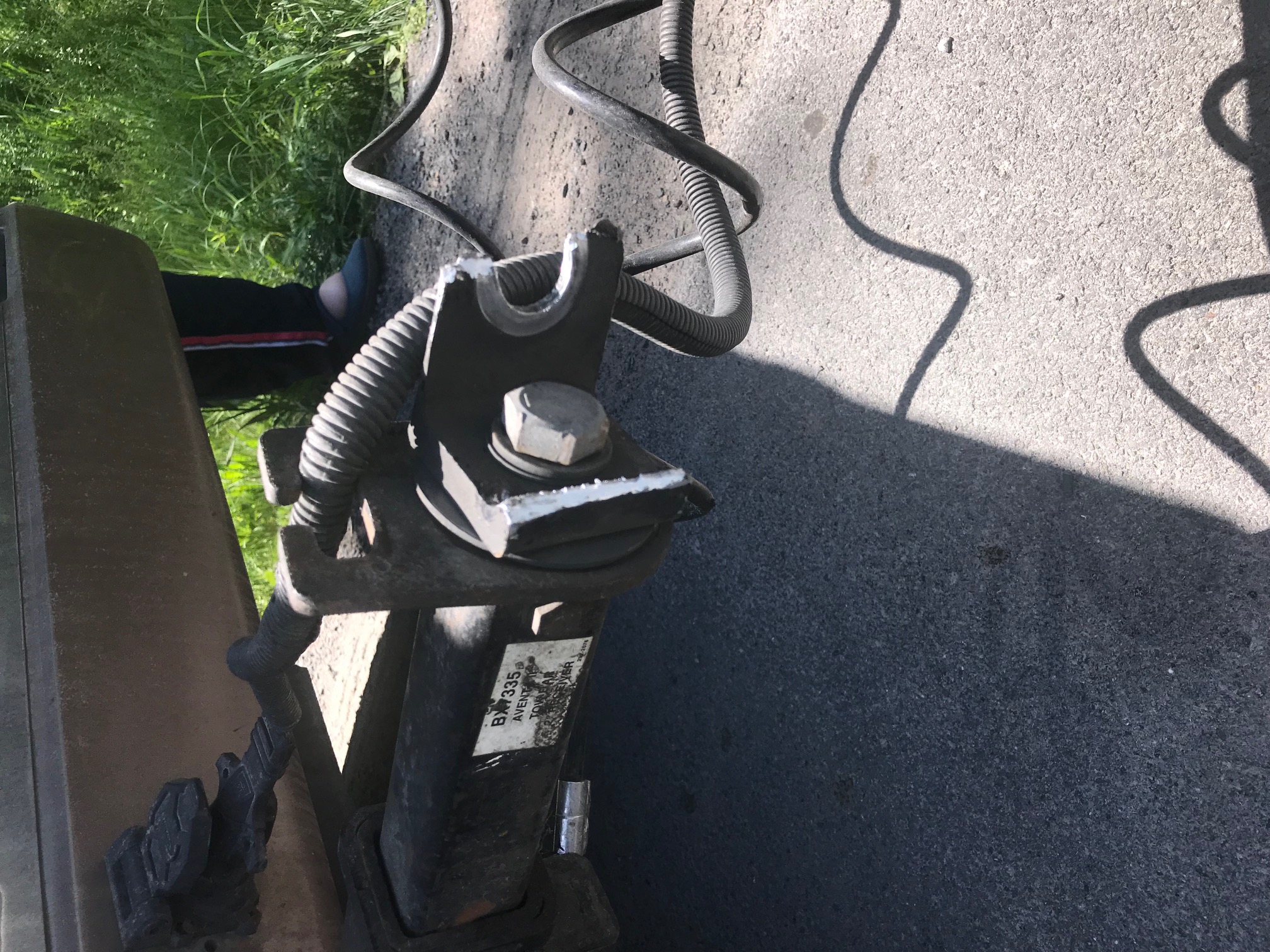

Major organ failure on the Blue Ox hitch assembly shown. [attachment=2123][attachment=2124]

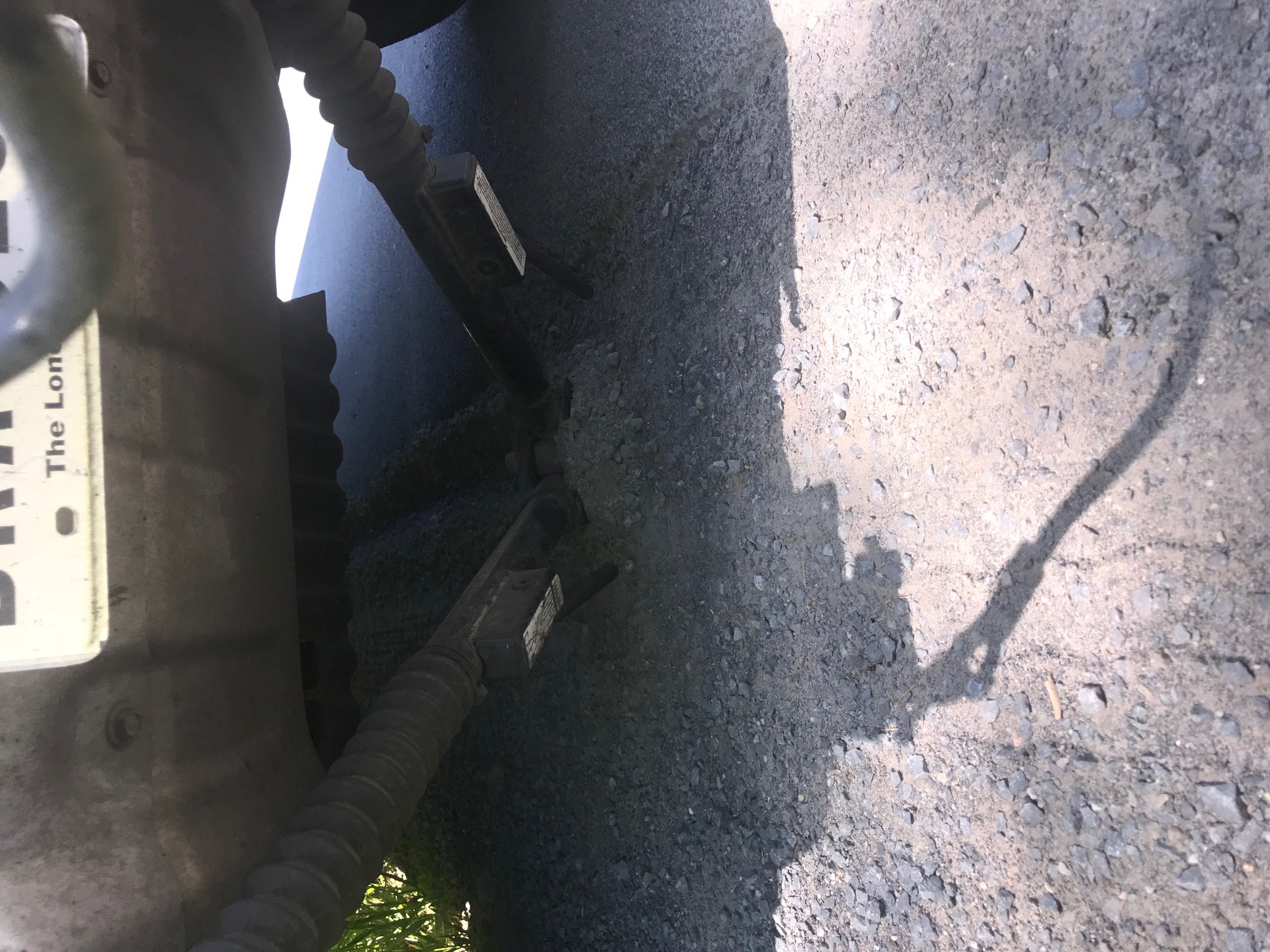

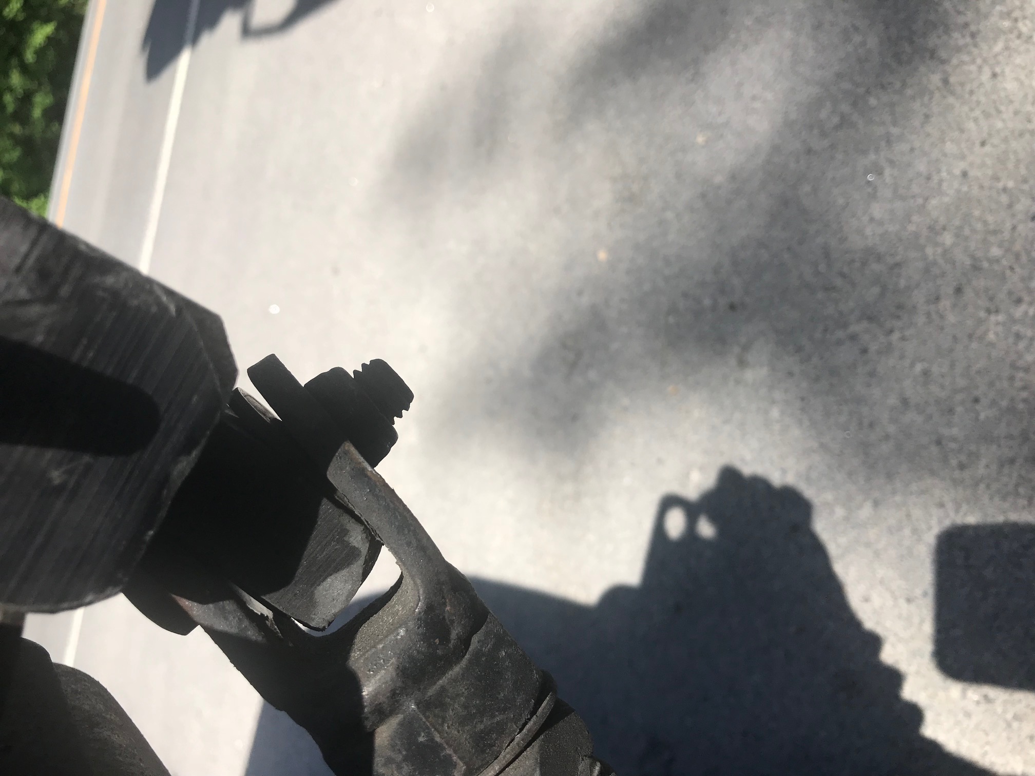

That major clevis connector was cast aluminum! Only good news is the arms flipped under the Hummer and acted as a brake against the 10,000 lb safety straps.[attachment=2125][attachment=2126] So minimal damage to the Bird (probably about $2k of fiberglass and paint work)
24 hours and many $$$ later, Hummer is in a shop awaiting arrival of all new brake calipers, rotors, pads, rear grease seals, and maybe new e-brake parts, as needed. New DEMCO tow bar (all steel and 10,500 lb rated) on order from Tweety’s, due by end of day Monday. Hope to be back under way on Wednesday of next week. Then to Texas Custom Coach for rear bumper and corner fiberglass repair from minor impact and off road adventure during tow bar break (huge rear overhang was also not tolerant of arched shoulder, but no real choices there!)

Here's Mike's pictures: İmage İmage İmage İmage İmage
Mike, glad no one was injured and that the damages are minimal. Thankfully you were able to stop and extinguish the fire before it grew. Some aren't so lucky; I've seen coaches burn because of fires started in toads. I guess if you're in this game long enough you'll see it all. Glad you're safe. I hope your new bar is made of steel. Smile

here is a could be????
bus went into a steep dip,rear end of bus in lowest dip angle, front of hummer atop of dip, tow bar vertical, bumper of hummer lifted 3 feet
-or a more likely reason for effed pivot joint-
bus went over a hump, wheels of bus atop hump, towbar vertical, hummer lower, bus come off the bump, puts bus ass weifht on front of hummer.
then brak-away brake systems acts as designed, fire starts as hummer attempts to stop a 52,000 lb bus

Greg’s out-of-synch porpoising description is pretty much what happened. Bus rear was going down as Hummer was coming up. When I saw the Hummer grill in the rear view monitor, I knew real bad stuff was coming. And it did.
However, one point of order, the failure of the Brake Buddy happened 30 miles prior. The Hummer was in free wheeling mode at the jump. The tow truck driver said his colleagues referred to it as the launching ramp. Apparently it keeps them in clients. Hmmm, I wonder if there’s a liability claim here?
The new Demco is spec’ed as all steel with a lifetime warranty for the original purchaser. At 10,500 lb rating, it was the highest that I found.
I find it unacceptable that Blue Ox had a cast aluminum piece at a major stress point, and a single point of failure location. They have a 3 year warranty. I have not called them yet. Too busy arranging repairs, ordering new tow bar, and just generally re-couping. I will call, but expect nothing, so have concentrated on recovery. Looking at different braking systems now, rather than the inertia driven Brake Buddy, which will merely be a non-activated placeholder for the rest of the trip. Ironically, I had tried to buy a new version of that aluminum clevis when I rebuilt the tow bar with all the Blue Ox rebuild kits. I was told it “was not available for individual purchase”. Good plan!

one of the problems with aluminum parts is it is hard to see cracks because the primer paint seems to stick better and there is no rust to show during a walk around. aluminum also lacks rebound like seel. you can bend steel out of shape and back several times but aluminum just fails.

(06-07-2018 13:17)RainbowrvGreg Wrote:  one of the problems with aluminum parts is it is hard to see cracks because the primer paint seems to stick better and there is no rust to show during a walk around. aluminum also lacks rebound like seel. you can bend steel out of shape and back several times but aluminum just fails.
In a different thread I asked about Blue Ox discontinuing my Aventa LX tow bar. The Aventa LX has steel arms, but that ball and socket gizmo is aluminum, Sad. Luckily it's not painted or powder coated so I can inspect it for cracks. I found this reasonably priced aluminum crack detection kit on amazon: https://www.amazon.com/Dye-Penetrant-Cra...B00XLW4BRC; it consists of a cleaner, a dye penetrant, and a developer, no back light needed. Magnaflux also makes a kit but it's twice the money. True, if you keep steel stresses below around 30,000 psi it'll never fatigue; whereas, aluminum is always fatiguing no matter how low the stress.
