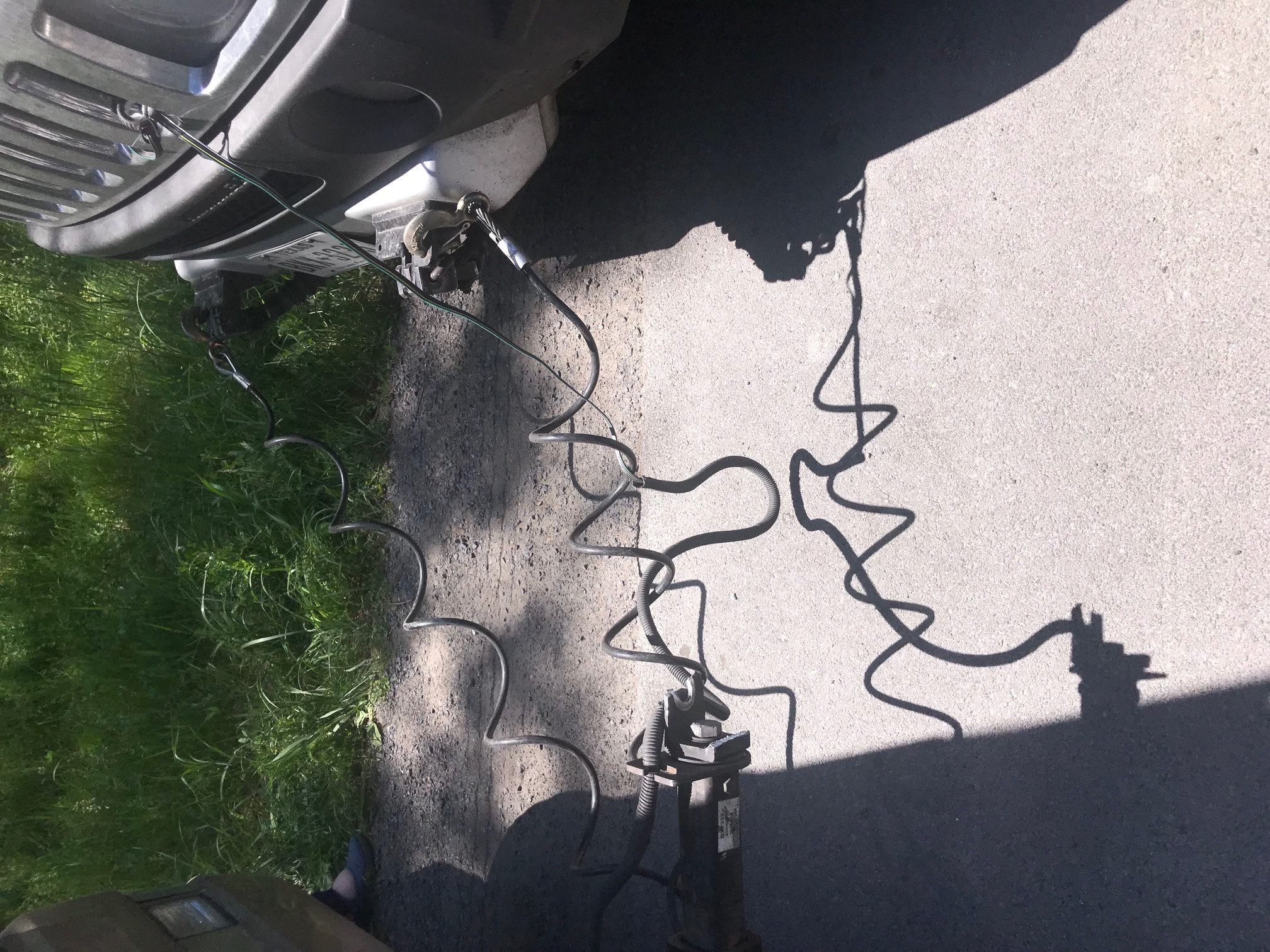

Here's Mike's pictures:
Mike, glad no one was injured and that the damages are minimal. Thankfully you were able to stop and extinguish the fire before it grew. Some aren't so lucky; I've seen coaches burn because of fires started in toads. I guess if you're in this game long enough you'll see it all. Glad you're safe. I hope your new bar is made of steel. david brady, '02 Wanderlodge LXi 'Smokey' (Sold), '04 Prevost H3 Vantare 'SpongeBob' "I don't like being wrong, but I really hate being right" |
