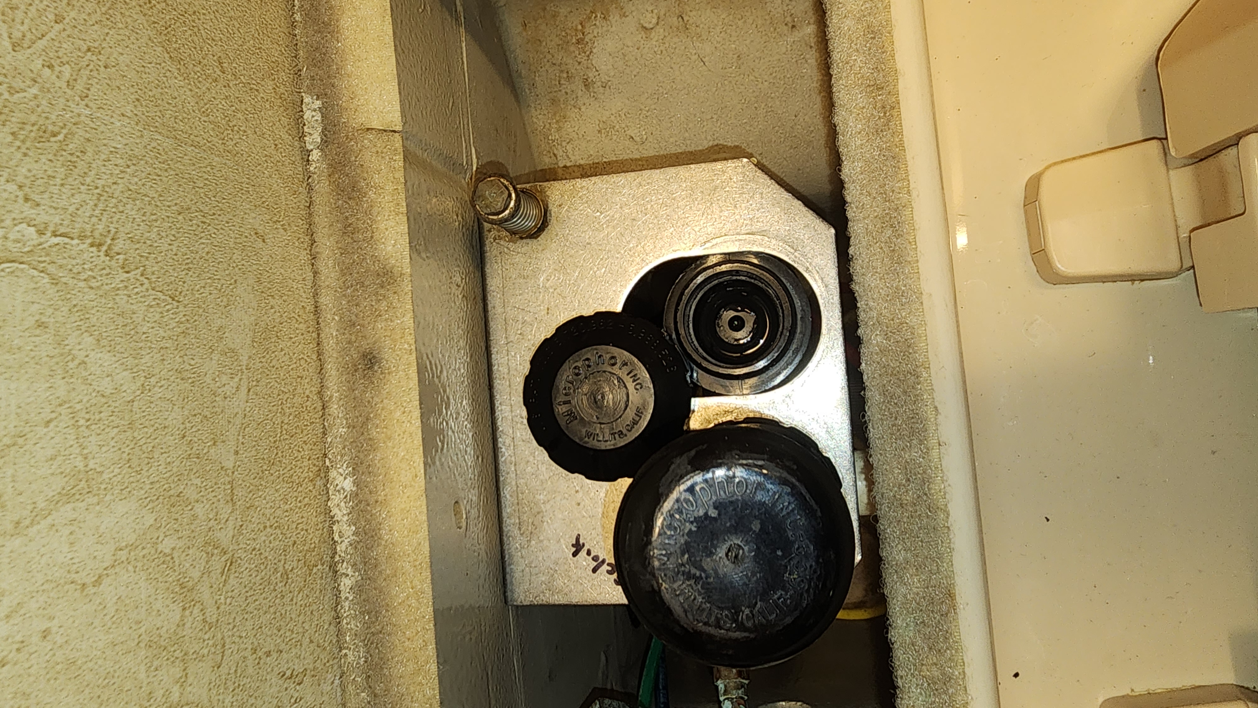

Hello, I recently bought a 1998 lxi 43! I'm loving it so far but the toilet has started leaking heavily from the air/water valve inside the toilet! It looks like the right cap on it is the culprit. Is there a gasket that should be under the cap? If so does anyone know where to purchase it?

The sequencing valve sometimes cracks the housing. Try http://www.mullaney-associates.com for parts. They redesigned that valve several years ago.
