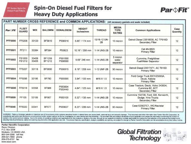

I have heard (read or dreamed) that my DD 8v92 primary fuel filter should be 10 microns and my secondary fuel filter should be 2 microns. Please let me know if this is incorrect.
The primary racor at 10 microns is no problem, however, when I researched the secondary fuel filter numbers frequently referrenced for my 8v92 they also came up at 10 microns. See Attached Chart.
Just didn't make sense to filter twice at 10 microns.
So, looking further I found a 3 micron Donaldson filter which I have been using.

Looking at the chart, it didn't show the 3 micron filter, or am I not reading it correctly?
Because I would like to change my secondary to that.

Would it be safe to say that the major risk of using the lower micron rated filter is that it could(would) plug faster and the major benefit is cleaner fuel, both thru the jets and back to the tank? Am I missing anything here?
Were there changes that made the S60 capable of higher micron filters, or did I get the 8v92 numbers wrong?

The owners manual for your coach, listed at Document Library -> Owners Manuals, specs a Fleetrite FFR8206 secondary fuel filter which crosses to a Donaldson P556916 which is 9 micron at 99%.
I noticed for the EGR version of the Series-60 Detroit Diesel specs a 5 micron (99%) secondary filter, so the progression seems to be toward finer filters with later engines.
