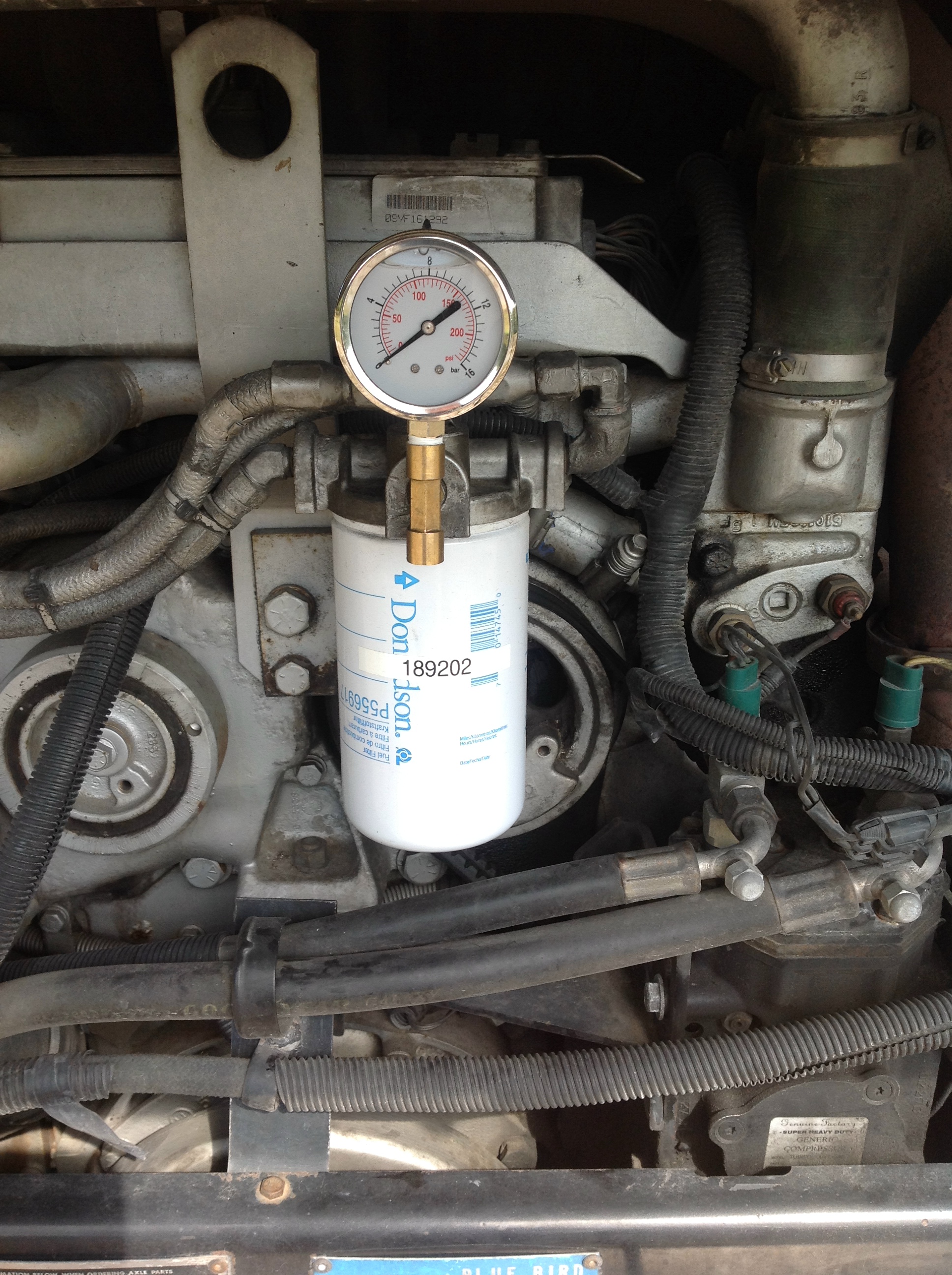

Thanks David,
Once someone gives you the answer, this stuff is easy! Thought I would also share my pressure guage for the secondary for knowing when to change the filter. Haven't had to change the filter yet but the reading is creeping up. (Hard part is holding on to the bumper going down the roadSmile )
