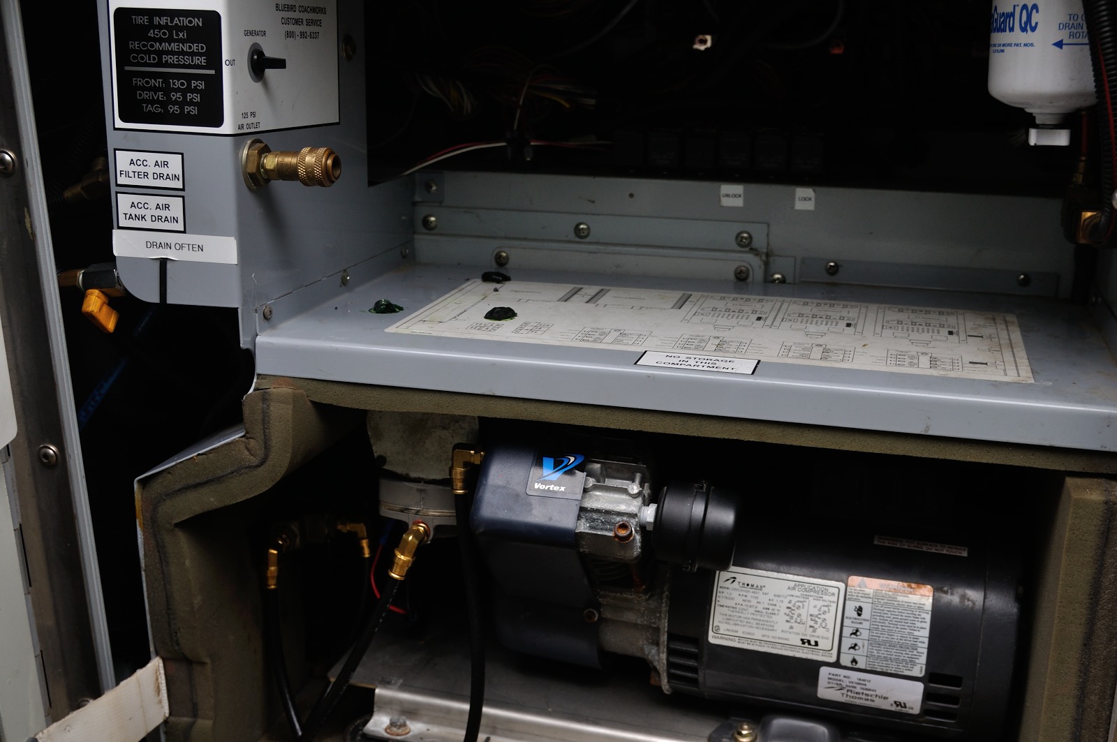

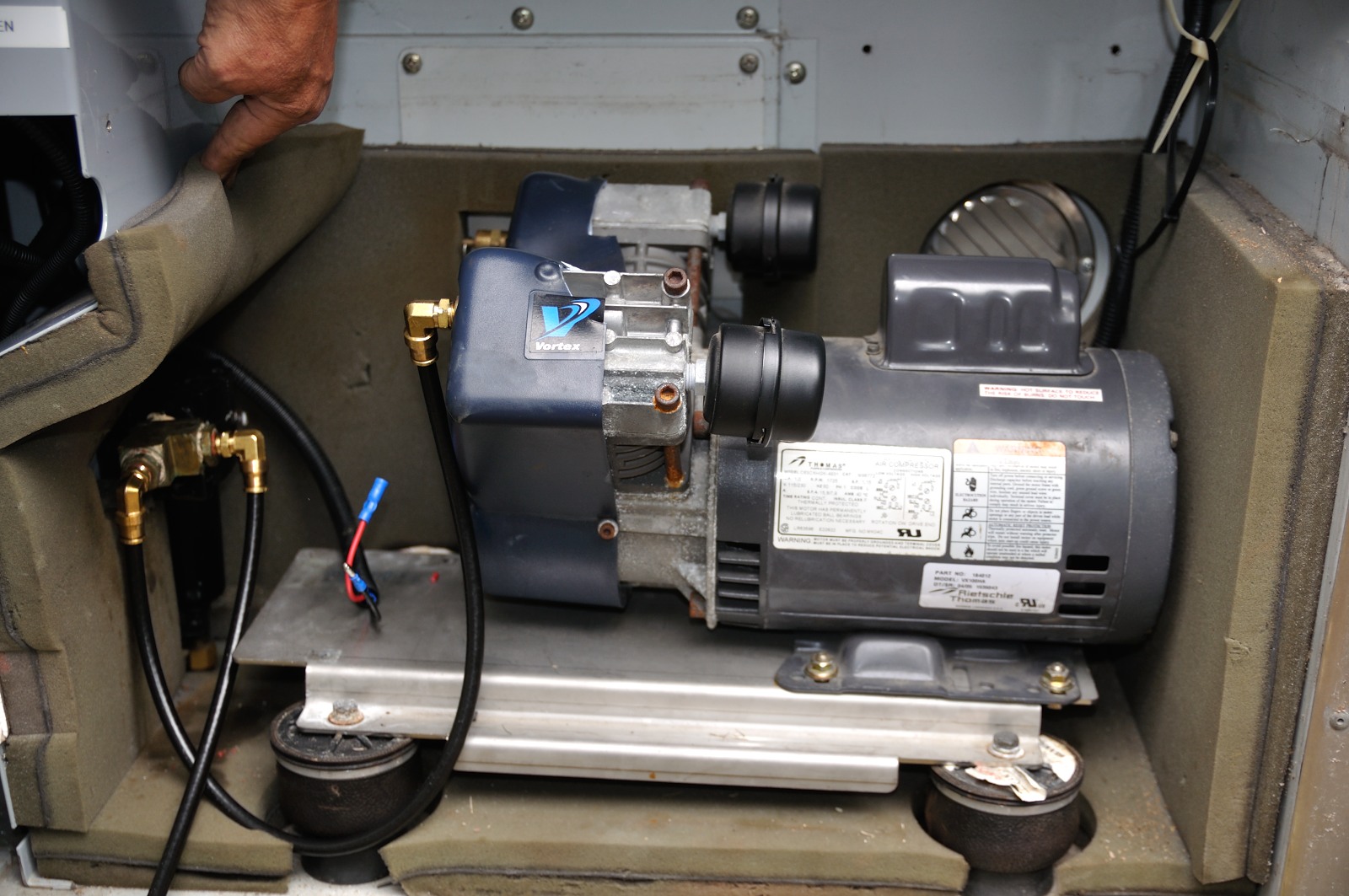

Paul took that out of my coach and replaced it with another compressor and tank. Works well and quiet, also

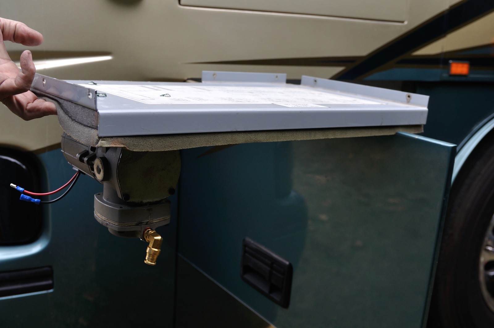

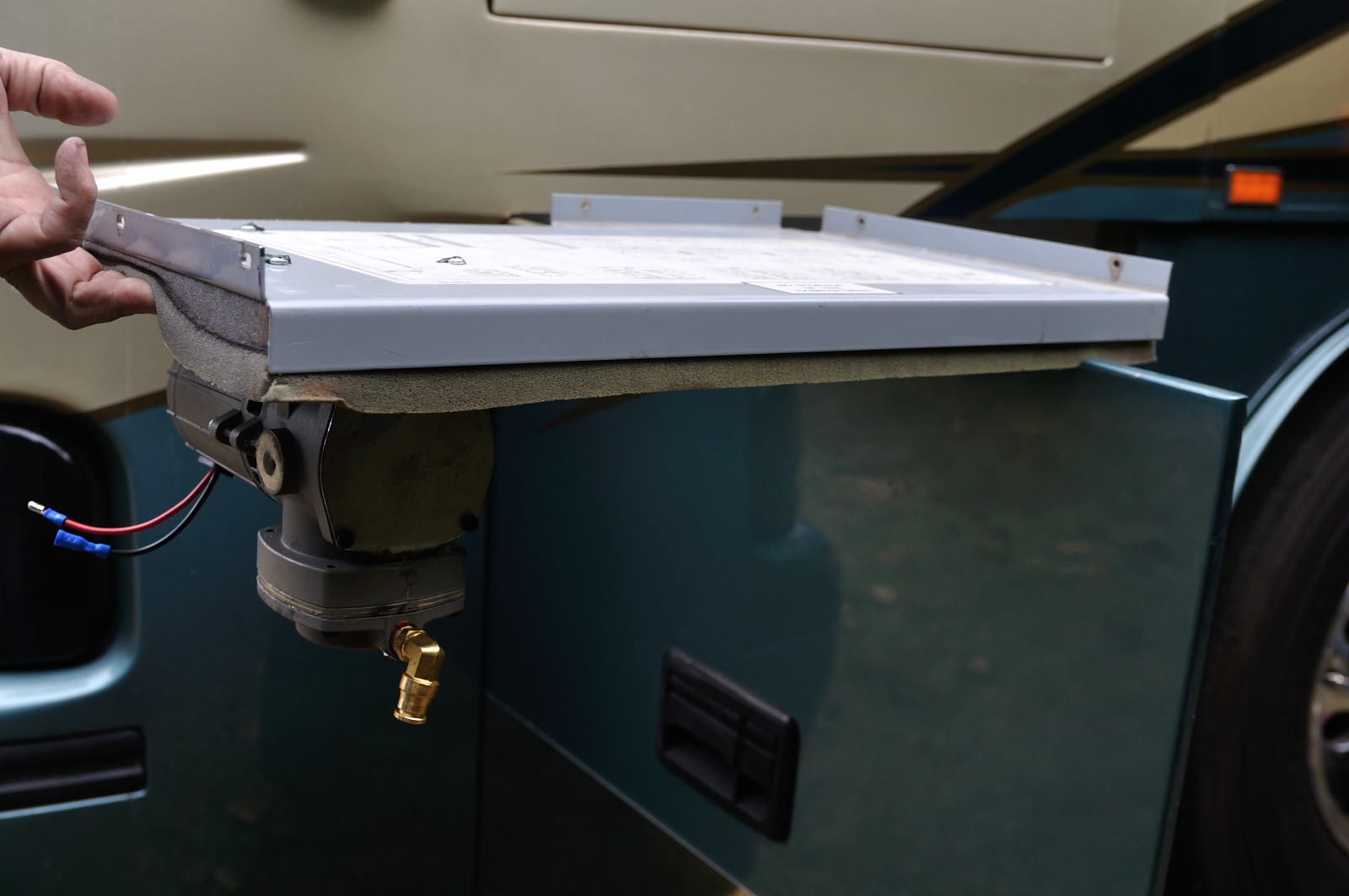

I purchased the repair kit from ZORO tools and also bought a used replacement pump. In the 450 , the location requires 2 hours to remove the unit, so Ed and I changed the fittings, tubing to DOT quick connects and hung the pump so that it can be r&r in 20 minutes. Next will be to plumb the 12 v to just the toilet. (requires check valve and small accumulator.) The repair kit is easy but be careful with the head bolts. One of mine had water corrosion and broke. PIA but repairable. The used pump wasn't such a bargain-- cracked head at the outlet-- Used "Rapid-fix " glue and it works fine-- for now! (Used this same glue to attach ball joint boot heat shields ) Ross MacKillop Wiarton Ontario 2006 450 Lxi |

I would use the Sears Compressor and route it the same way Paul LaZar did in his 97. Works great and less than $150.00. Have Ernie send you pics of the install Paul did on the coach. I would not pay for the Thomas compressor. They are bad news that keeps braking down if used often. Hisham and Sue Amaral 2004 Prevost XL2 Marathon (sold) 2003 Liberty H3-45 2 slide Titusville, Florida 248-935-5390 |
