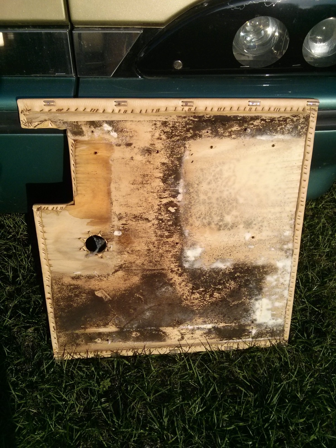

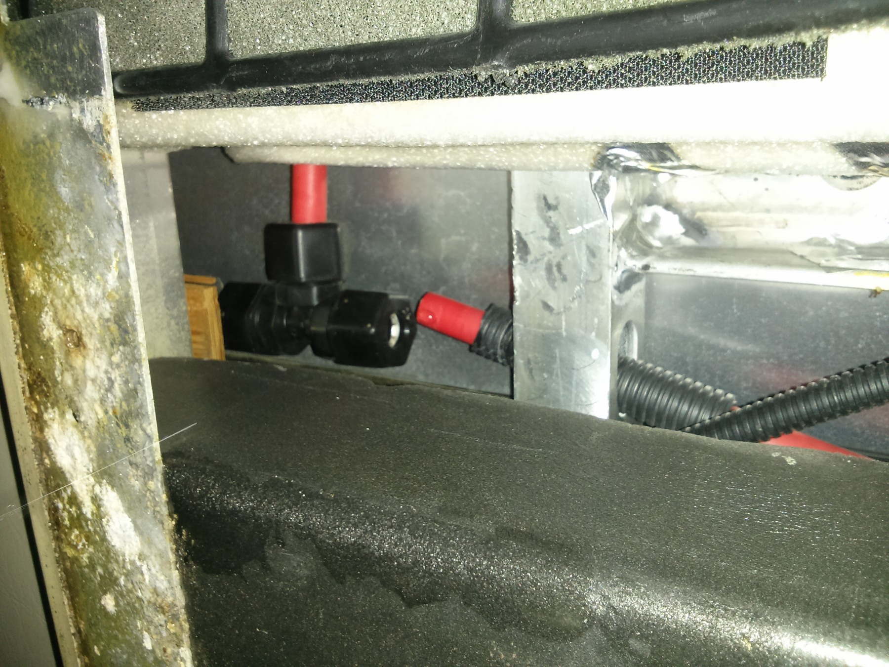

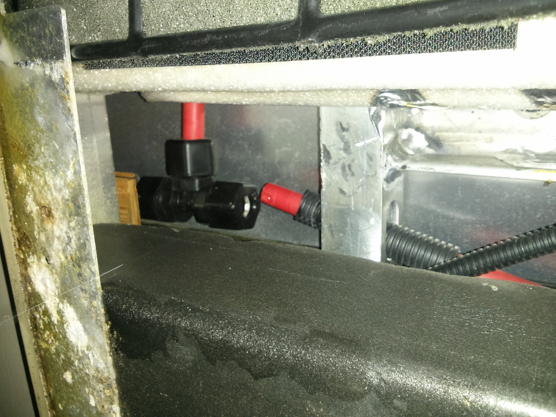

More in the never ending battle. Pic looking up near AC unit.
Remove centre ceiling panals -add section of pex pipe with union. Using a Facet wrench (ground down to be thinner) makes it possible to tighten the nuts on the Tee Clean up the mold.
Fun -- Then got to do it again for each AC. all 4 leaking
