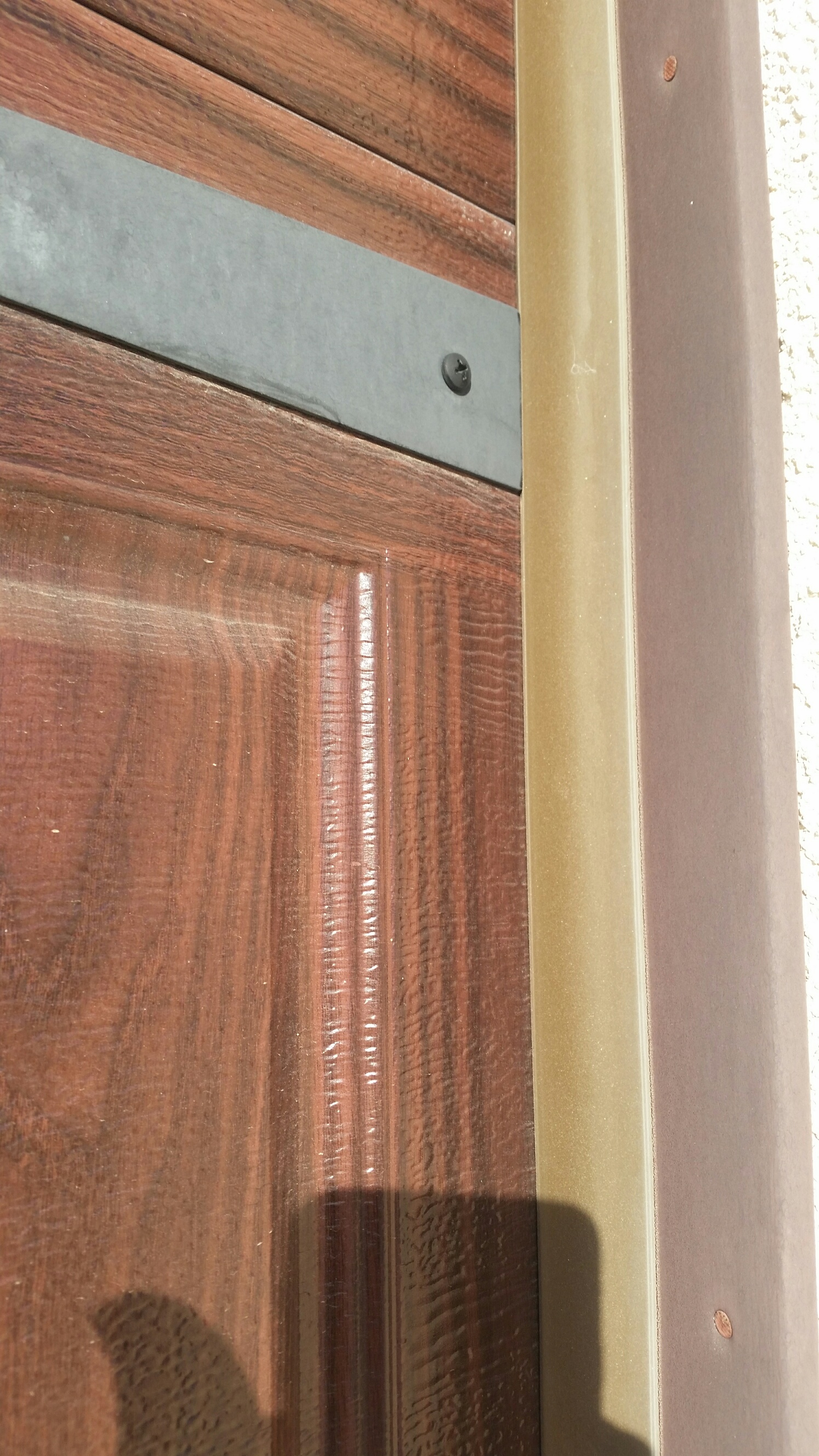

John,
We get a lot of high wind during the winter months here. We have no wind coming through around the bus door. The key is a good quality door fitted with the proper seal as you see in the pic below. ─░mage

Chuck,
That seal does look like it seals pretty well. Is that a standard for that door manufacturer or something special? And how old is that one?

John,
Those are 1-peice PVC trim/seals. They are about 3 years old.
