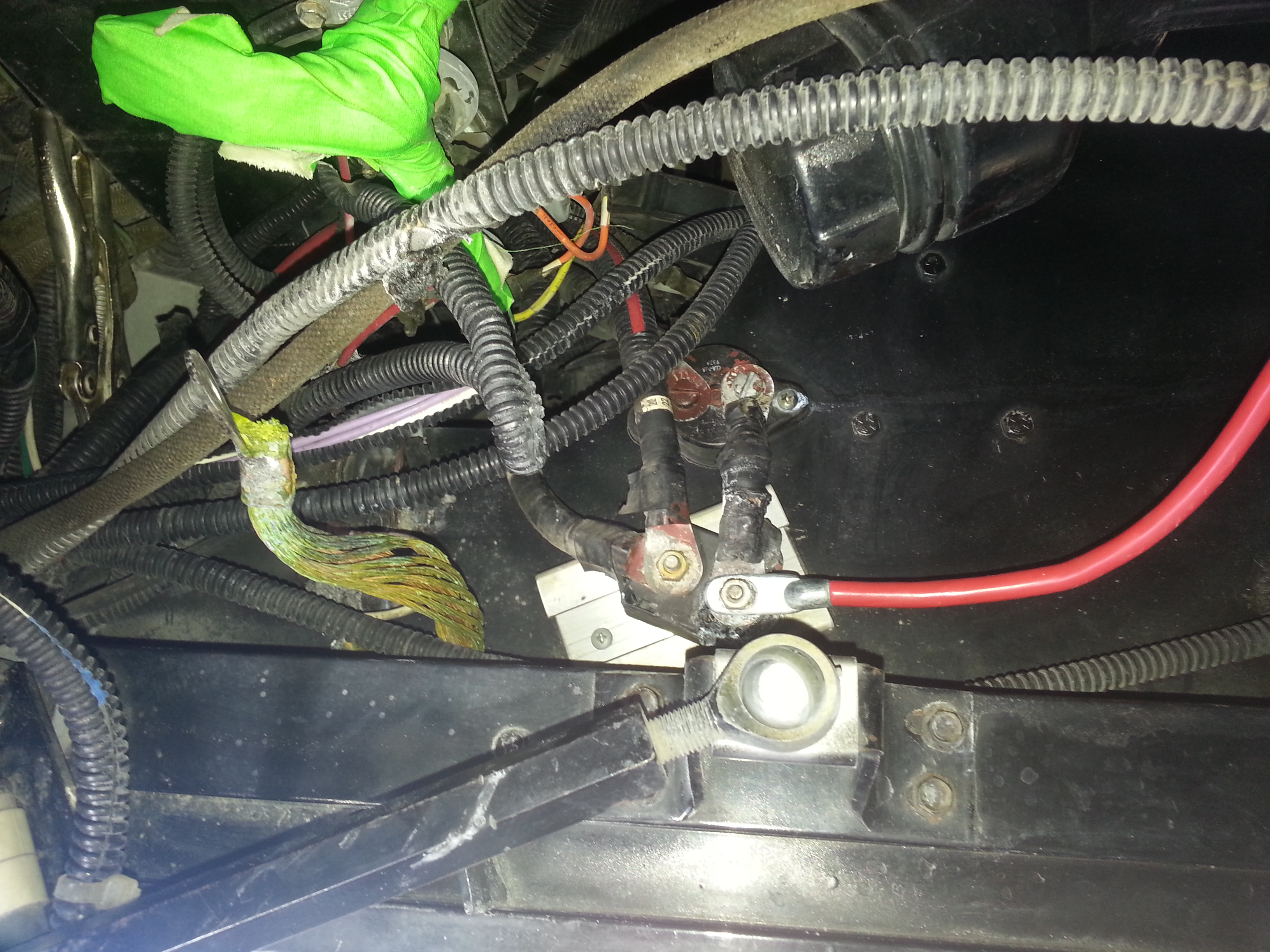

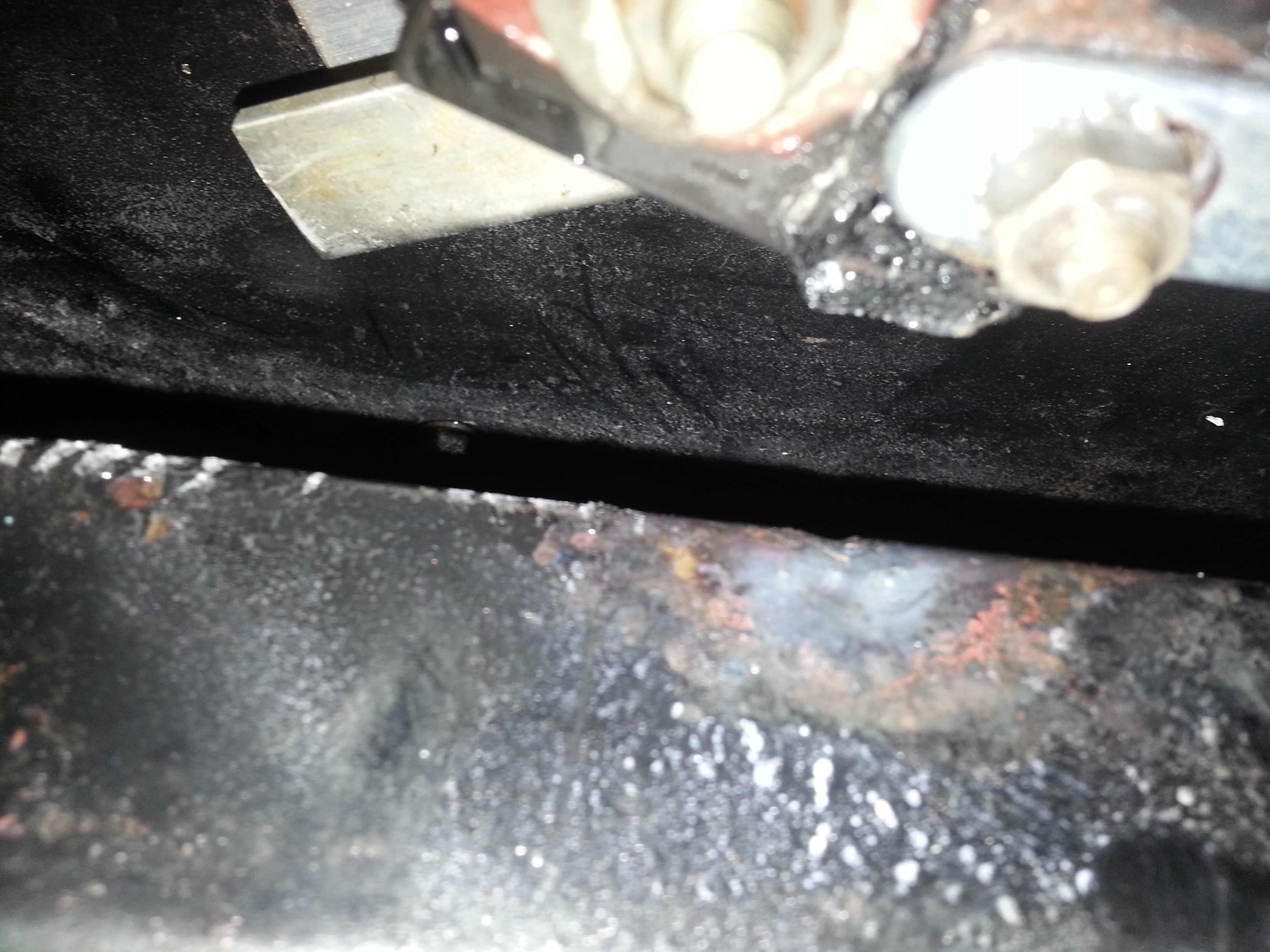

While in that radiator compartment I removed my AT relay and replaced it with a 80 amp breaker marine switch. the A.T. relay stays hot and sucks up major amps (phantom draw). there are a couple of other electrical items close to the frame of the bay door that I also replaced and updated with marine grade relay/switches. I had a electrical ground short in that area when vibration caused the frame of the bay door to contact a 100 amp lug. (the stray voltage also forced a fault light on the allison display but no code when I hit freeway bumps for months)

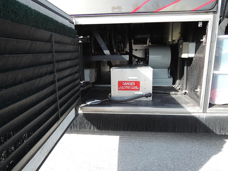

Here's what Vantare uses on the louvered compartment door that feeds air to 2 cruiseairs and the generator radiator:

here is an image of the electrical issue in the comparment. İmage the circuit breaker by the door sill (right hand) is raised on a stock of extruded alumnium to give access to a reset button under the breaker. the wire running to the a-t relay made contact and cooked the insulation then burnt up the a-t relay dropping the contact out of the bottom. I was by chance on the other side of the bus and immediately dropped both battery shut off switches and the genset. I smelled the electrical and thought it was the gen set. but it was the insulation and plastic from the relay. İmage

For the case of my Vantare, the louvered door is an air inlet. It's easy to stuff a cheap fiberglass filter between the louvers such as these sold at McMaster Carr. The air is then expelled thru exhaust vents in the basement floor. You can see that the bristled skirting along the sides of the bus also come into play preventing air recirculation. As we all know, these fiberglass filters become quite efficient as they build a static charge. Even fine dust can be caught which is important for my cruiseair condensers.
