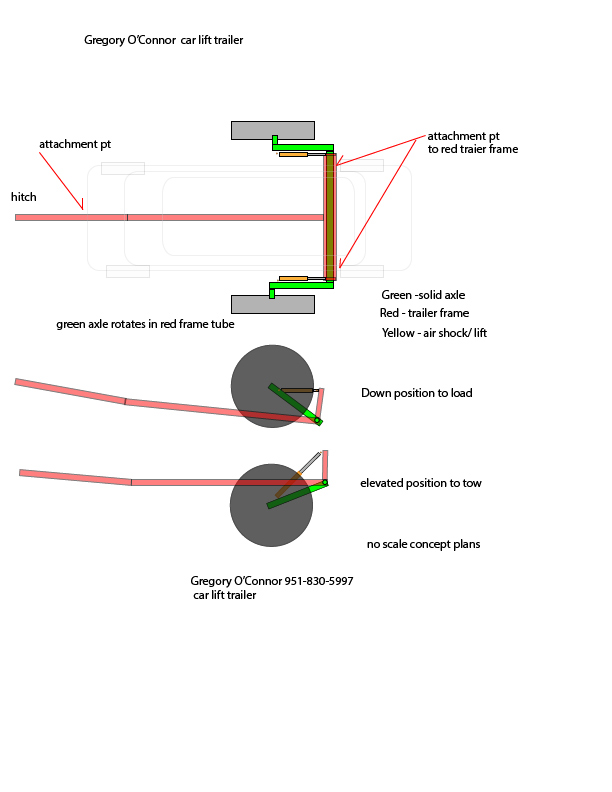

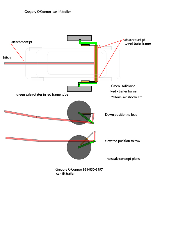

here is a bit of what I was thinking about with a lift trailer.
the red frame is on the outside of the green tube axle. the yellow air shock is also the lift. the stroke doesnt work out and nothing is calced but without the car all you have is two tires and a frame. a bunch needs to be worked out but after I finish my hummer quad rack this is next.
09-08-2014, 17:30 (This post was last modified: 09-08-2014 18:15 by travelite.)
RE: "Smart Car" carrier
