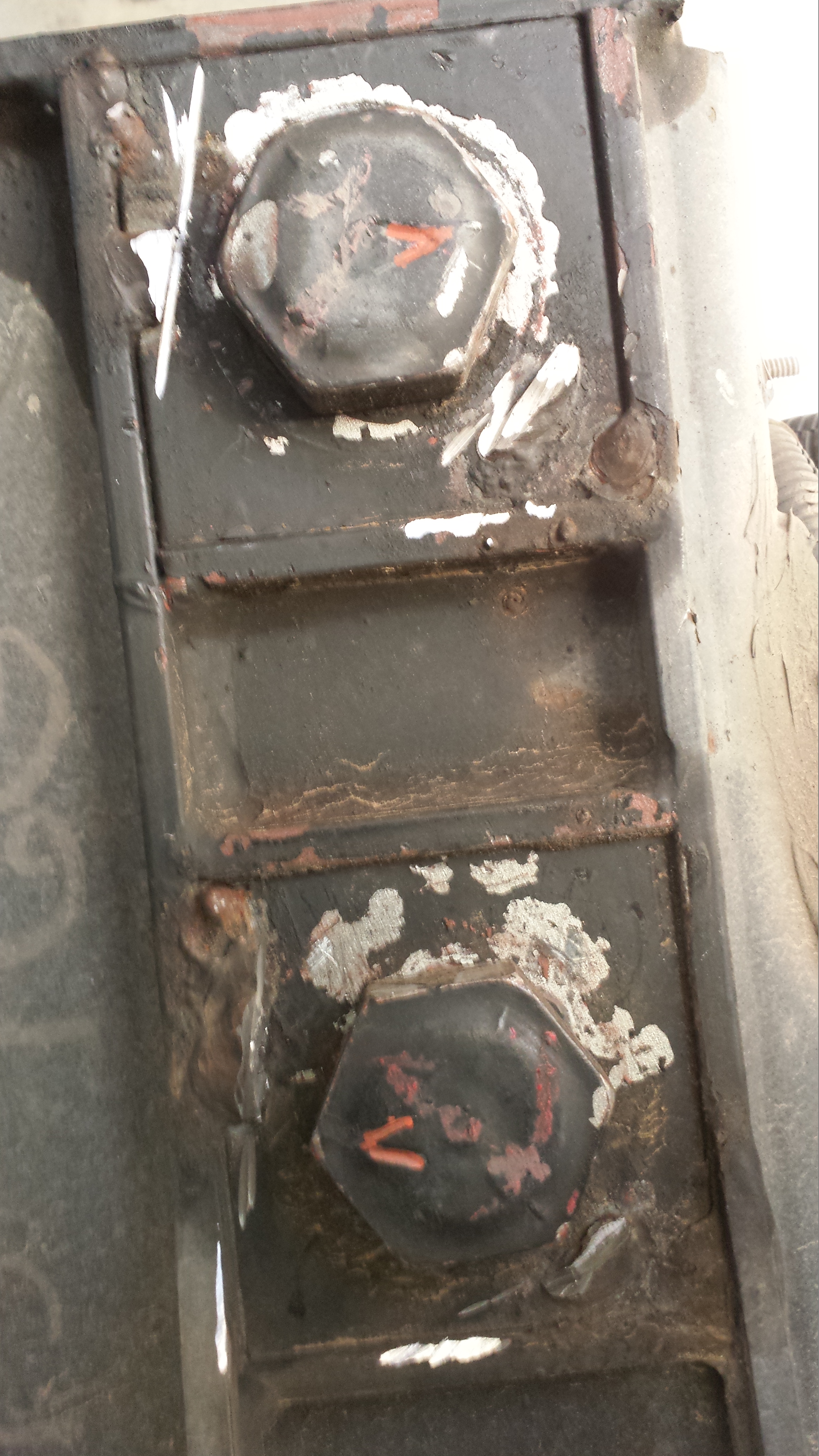

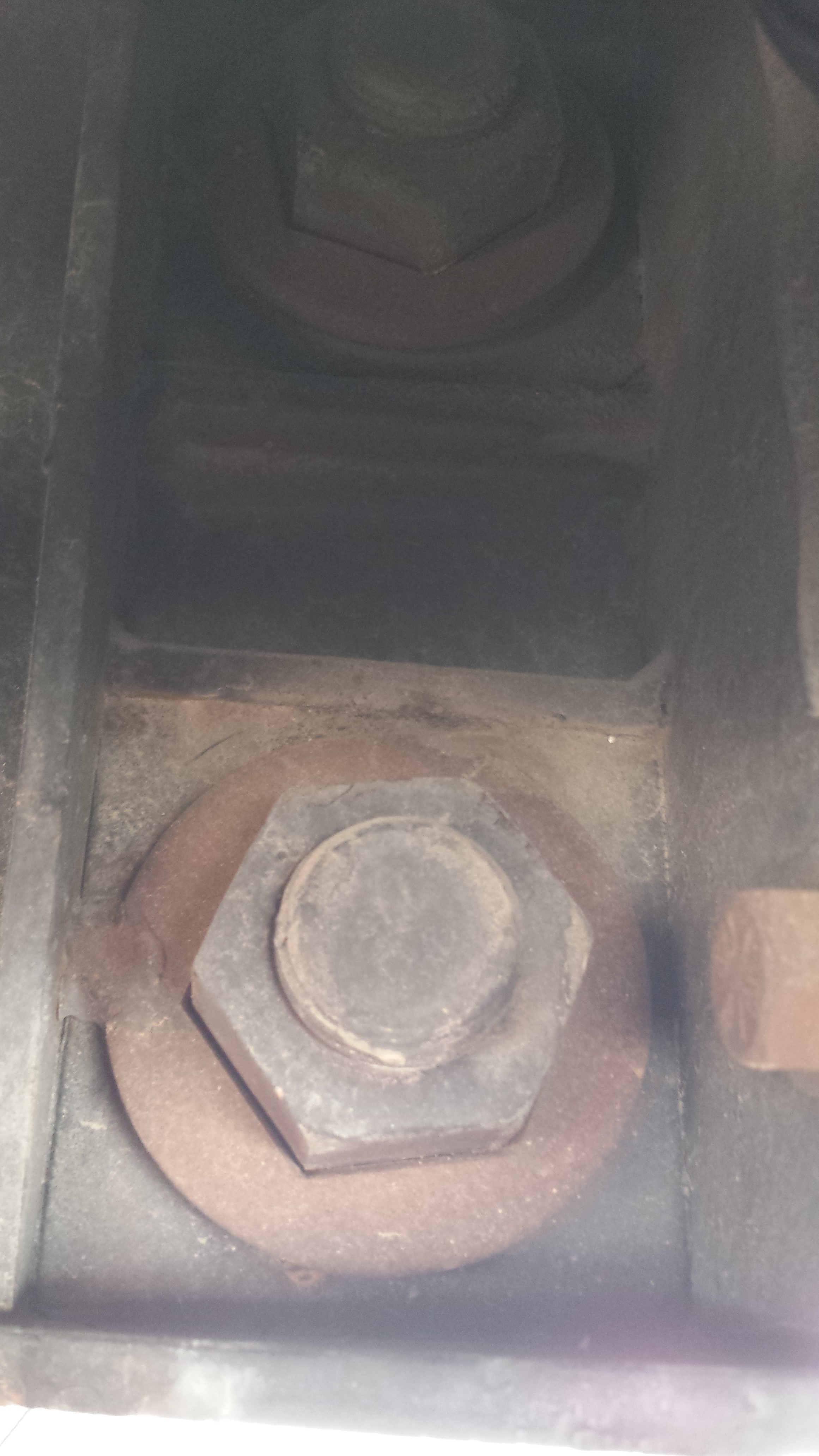

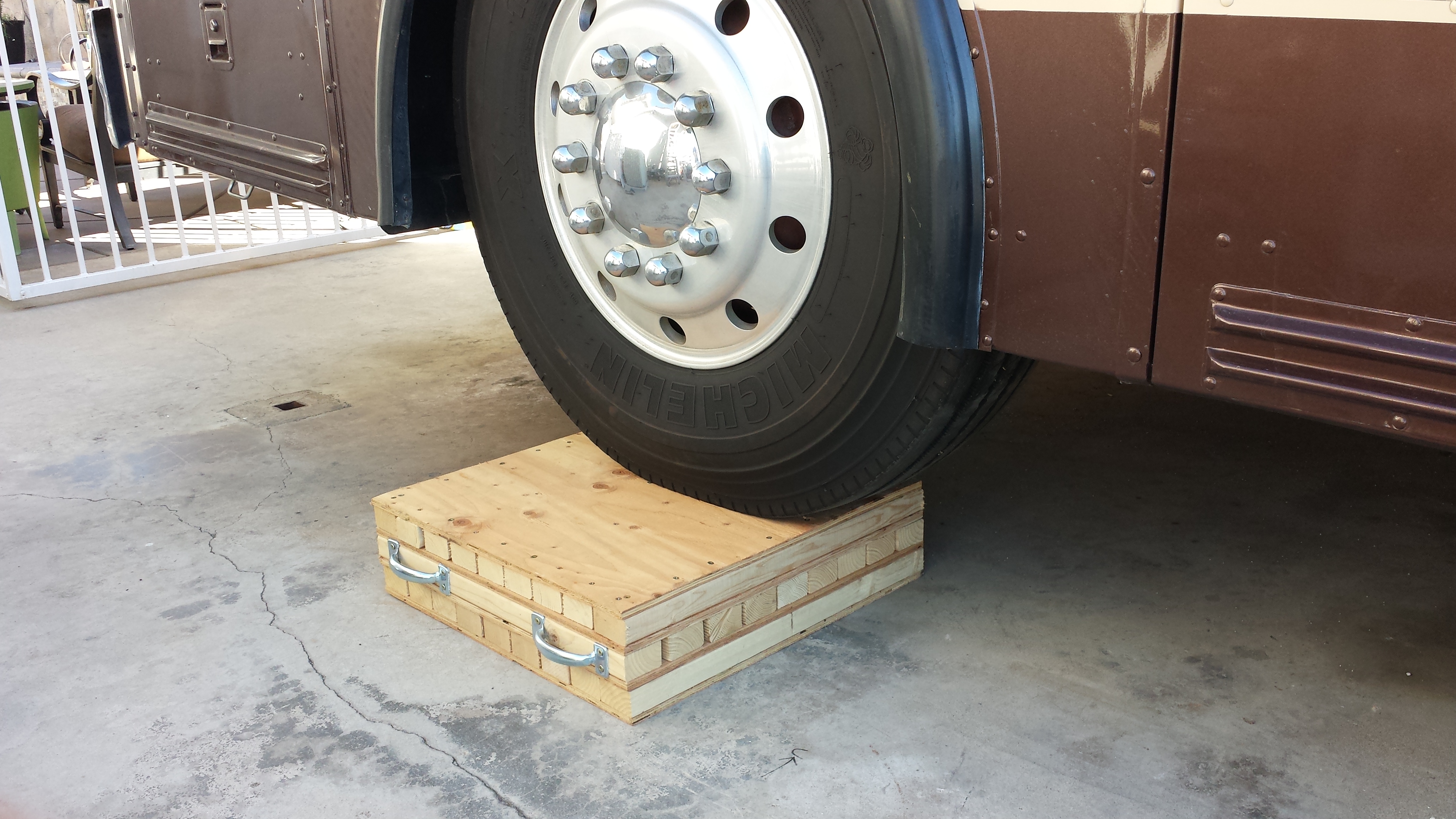

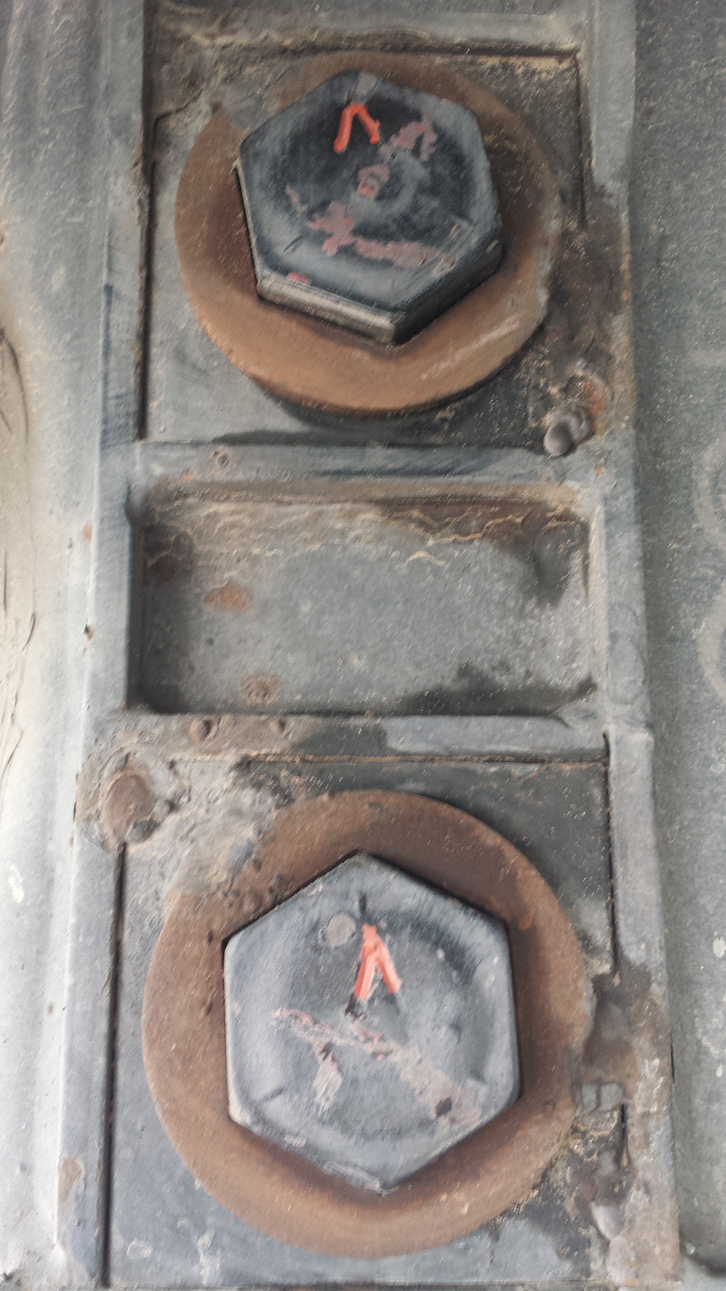

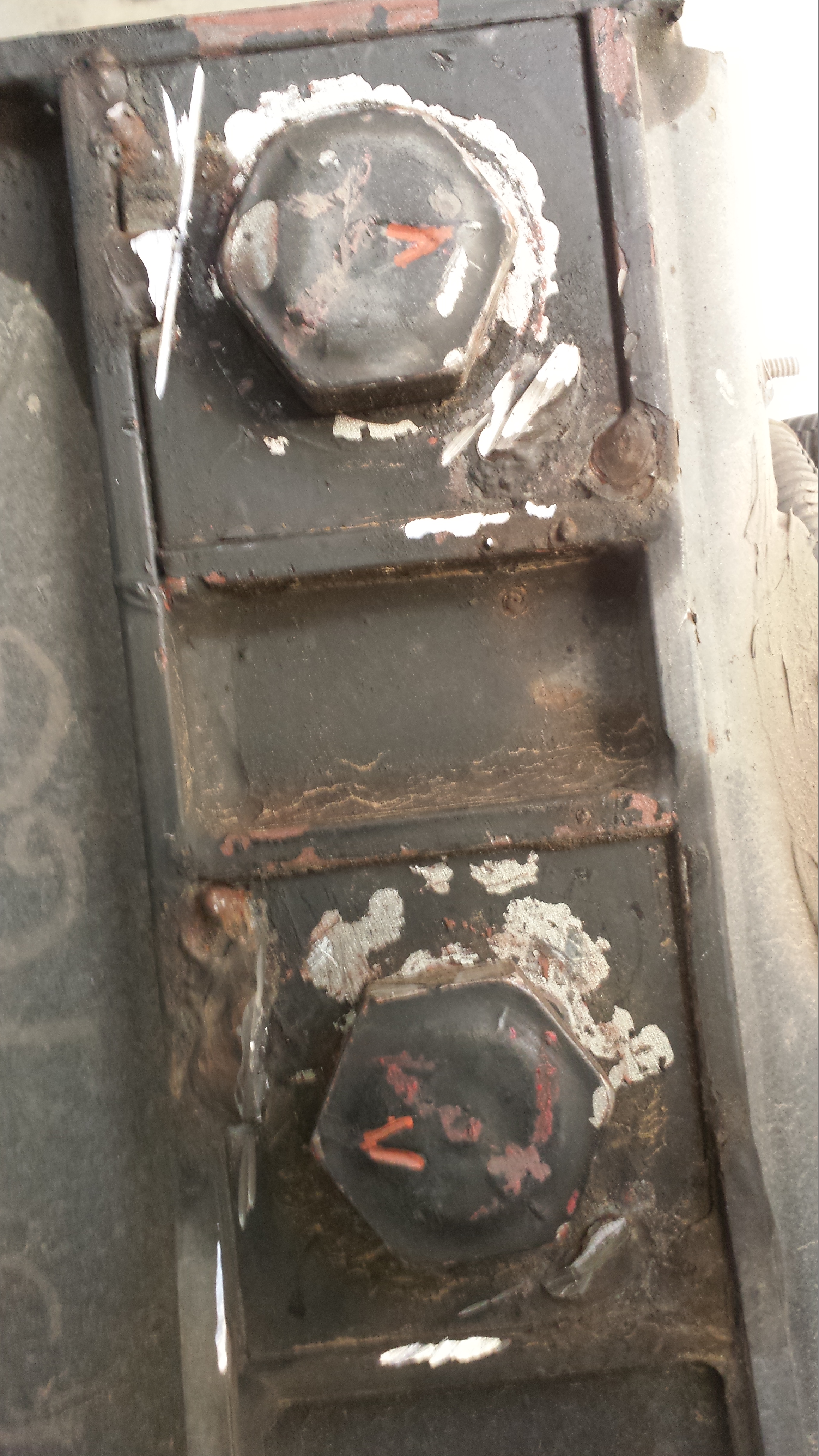

I'm about finished with the project to take some of the wandering out of going down the road. Just have the Safe-T-Plus adjustment to complete...and align the steering wheel. Review the attached to get an understanding. The write up is not complete as I need to deal with the Safe-T-Plus and align the steering wheel. Will update the write after.
(09-14-2014 12:28)csprenger Wrote:  I'm about finished with the project to take some of the wandering out of going down the road. Just have the Safe-T-Plus adjustment to complete...and align the steering wheel. Review the attached to get an understanding. The write up is not complete as I need to deal with the Safe-T-Plus and align the steering wheel. Will update the write after.
Update: Adjusted the Safe-T-Plus and took the coach out for "Take The Wander Out" Test #2. The coach goes straight down the road. No pull left or right. I'm a happy camper. Still need to align the steering wheel and install the Anti-turn washers.
Update: I've finished the Take the Wander Out procedure. See the attached write up and photos.

That's great Curt. Thanks for the write-up and pics. You mentioned that the coach goes straight and that you have the Safe-T-Plus adjusted and centered. How are the brakes? Any left or right pull during hard braking?
My method for adjusting the Safe-T-Plus was given to me by George Morris: What you do is figure out which way the bus is pulling. Stop the bus, tweak the steering wheel in the direction that you must to keep the bus going straight, crawl under the front, loosen the U-bolts and let the Safe-T-Plus center itself on the steering cross bar. The amount of movement required is tiny, something like one thousandth's of an inch is all that's necessary to cause the Safe-T-Plus to pull in a given direction. Very sensitive. I've used this manual centering technique several times with good success.
