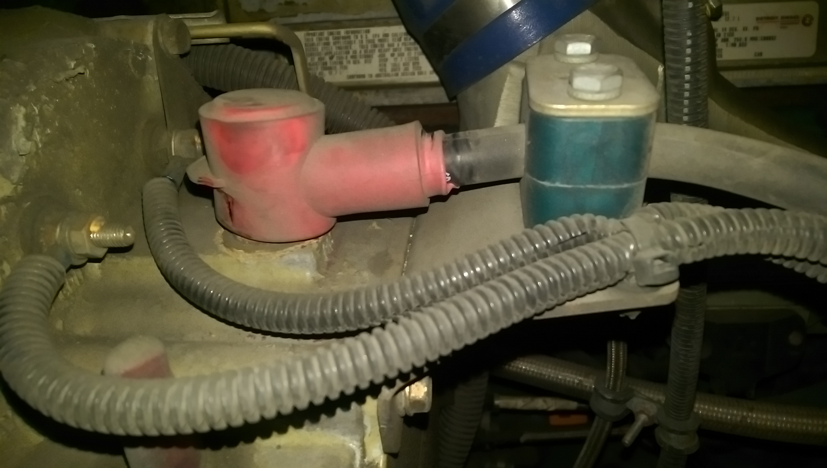

SpongeBob has one of these; it's a bracket that clamps to the 2/0 positive lead and bolts to the alternator relieving stress on the connector:

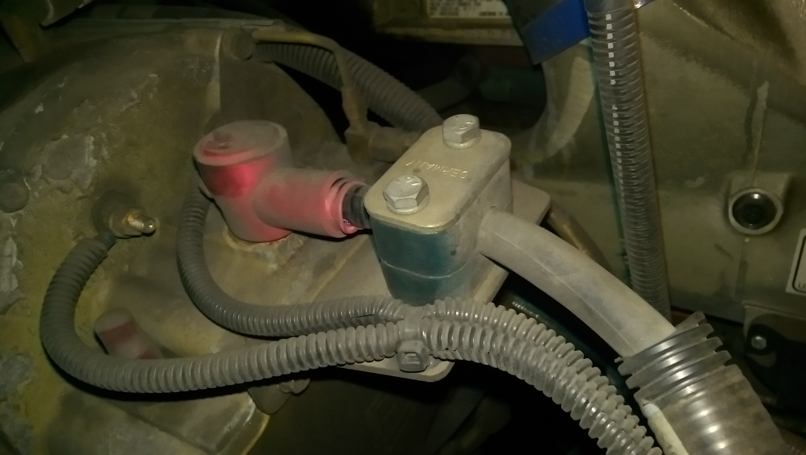

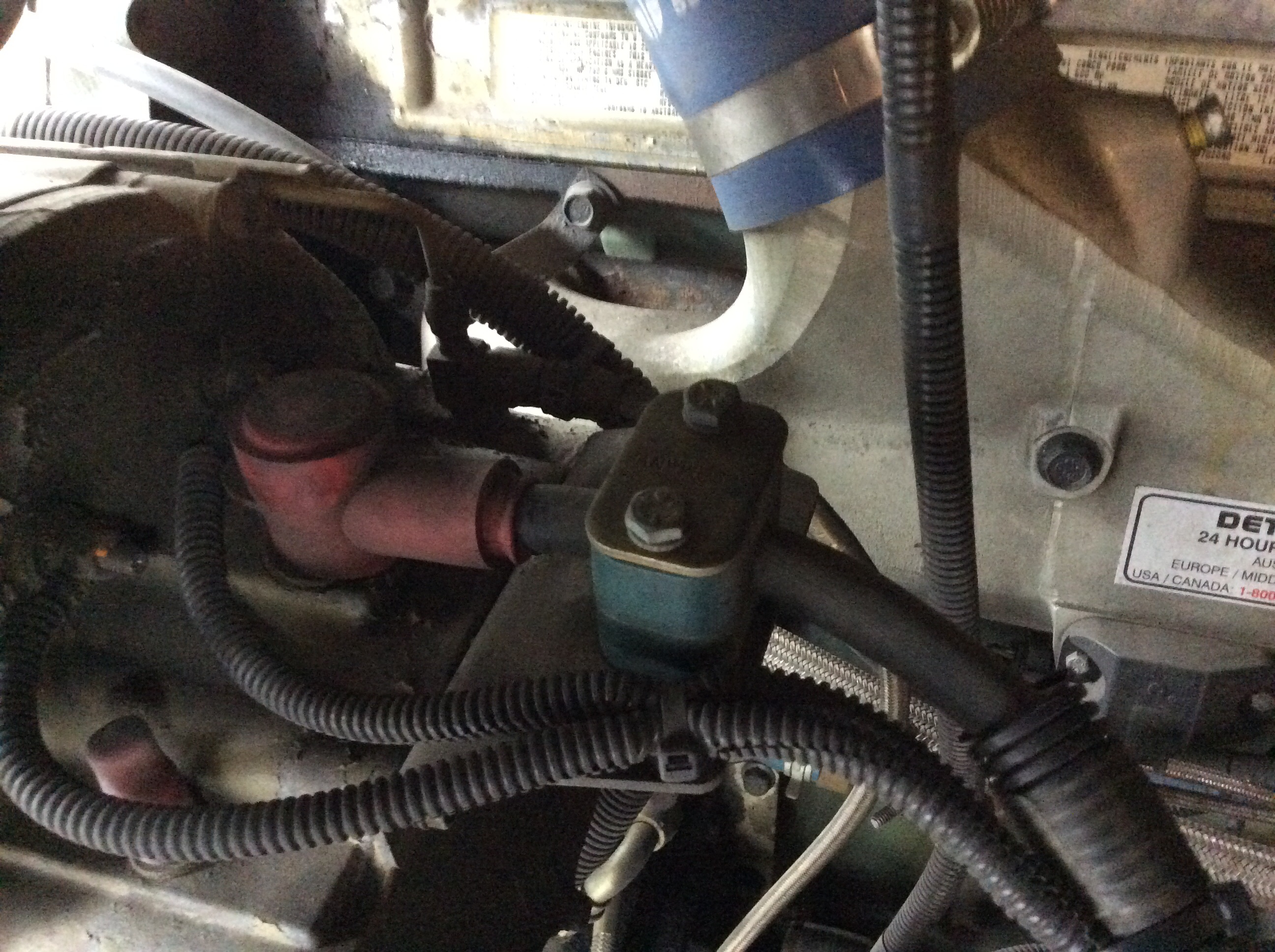

More pics:
09-27-2014, 01:31
RE: 50DN Alternator Pos Cable Bracket
also a good safety device if the terminal pulls apart. I dont think that line is fused ?
