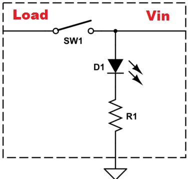

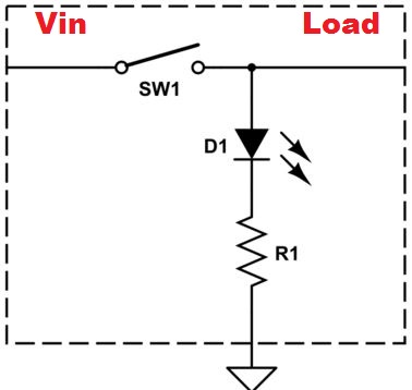

Hi Greg,
This should work:
1) LED always on: ─░mage
2) LED on when load is powered: ─░mage

(10-26-2014 14:13)davidbrady Wrote:  Hi Greg,
This should work:
1) LED always on:
David, Thanks, I was thinking one of the options to the switch was 'the light went off when the load got power'. that type of circuit would be useful for a 'refrigerator is not running' warning light. I often thought of wiring a small light to the 110 refer power some place that showed that 110 is available. My check and review method now is high calorie.
