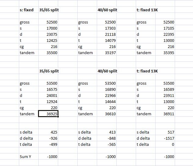

11-05-2014, 19:11 (This post was last modified: 11-05-2014 20:06 by davidbrady.)
RE: 2005 M450 on Ebay
The trick is to calculate the location of the center of gravity of the bus without the tongue weight, add the tongue weight and calculate the shift in the center of gravity, then take the sum of the moments about the steer axle assuming a 35/65 weight split on the tag/drive axles.
Assumptions:
Coach weight: 50000 lb
Wheelbase: 300"
Front overhang: 80"
Rear overhang: 100"
Tag to Drive axle spacing: 55"
Tag/Drive split: 35%/65%
Center of gravity location without tongue weight: 219" behind steer axle.
Steer: 15715 lb
Drive: 22285 lb
Tag: 12000 lb
Center of gravity with 1000lb tongue weight added: 225" behind steer axle.
Steer: 15056 lb
Drive: 23364 lb
Tag: 12580 lb
Delta off steer axle: 658.7 lb
11-05-2014, 20:34
Sorry, Didn't mean to hijack post.
Here are more accurate numbers . Pls do it again. and then using 40:60 with a tag max of 13,000.
Front axle load -- use 17,000 Gross wt 52,500.
Thx,
front overhang back overhang wheel base
Prevost H3 75 107 316
Prevost XL 68 107 314
450LXi 85 113 296

11-05-2014, 23:04 (This post was last modified: 11-05-2014 23:48 by davidbrady.)
Here you go Ross:
I have six scenarios. You can see going across the top row we have a fixed GVW of 52500. The first set of numbers fixes the steer axle at 17000 lbs. Moving to the right we see the effect on the steer axle of adjusting the tag/drive ratio to .4/.6, finally moving to the far right we see the effect on the steer axle by capping the tag to 13K.
Moving down the columns the only thing changed is the addition of 1000 lbs of tongue weight.
