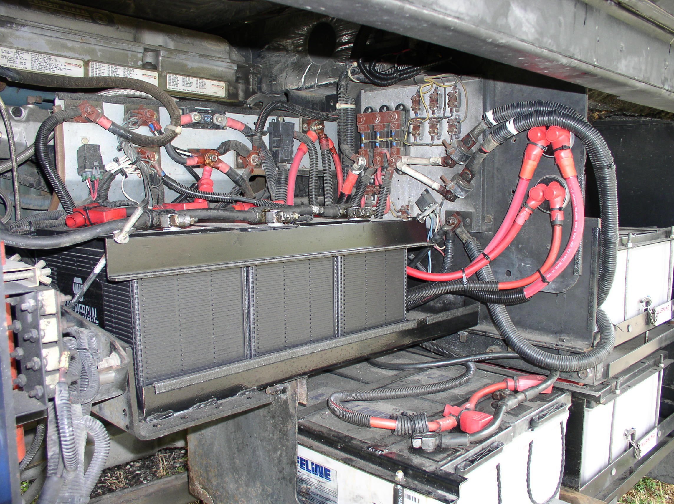

─░mage ─░mage If you are replacing a fuse, and even if you are not, add the proper fuse holder. BB used a piece of rubber and a metal clamp that is a dead short to the battery if it comes just a little loose. Pix attached.
Again, while you are at it, install a rubber cover over the back of thee hot jump terminal. It is inviting a massive spark if you happen to ground it with a wrench.

Good points, Ron. I'll have to study mine a little to see how to do that properly.
