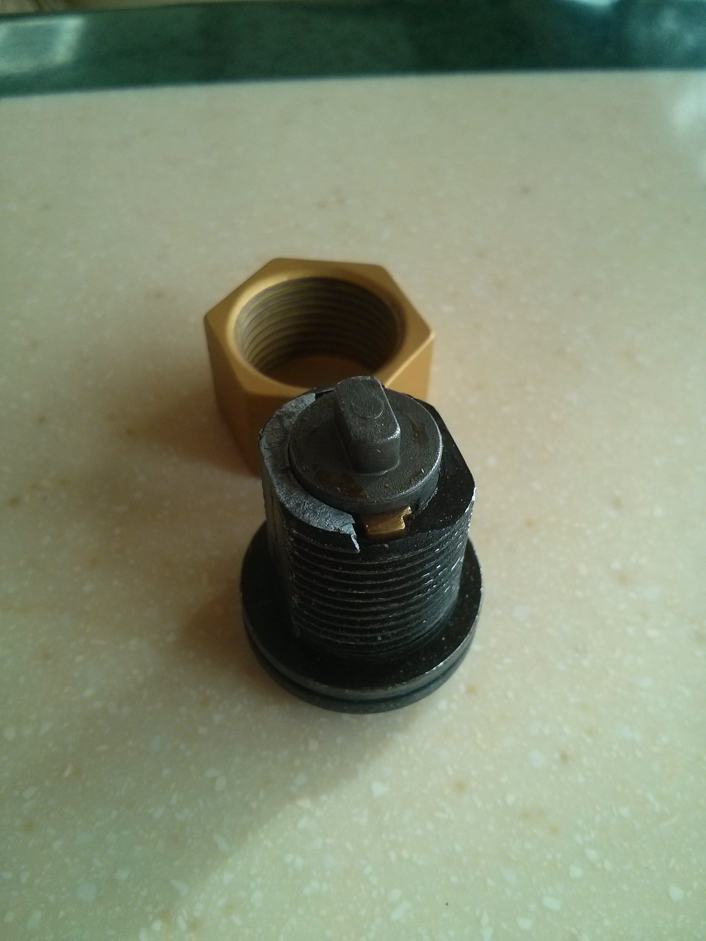

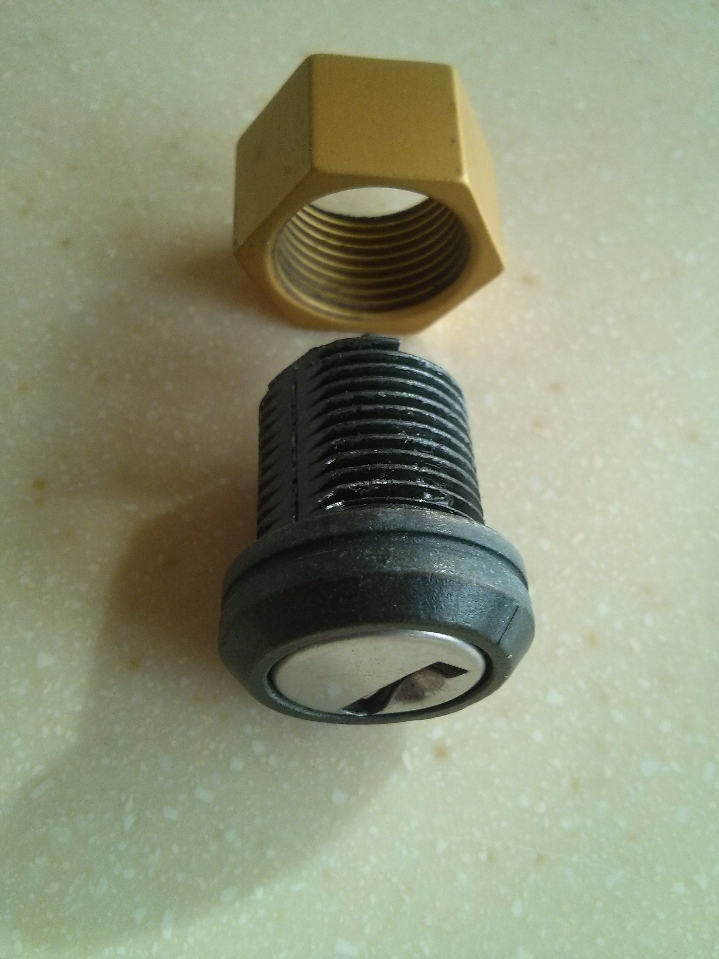

Hi
The cast metal tab that turns to hold outside door closed is broken off. (Electronic area beside driver) Idea as to replacement. ...Duct tape is not impressive !
UPDATE:
Found lots of them.. Just not the same one
They are called "Metal Wafer Cam lock" Even Home Depot has them. < $5 ( no doubt made in China )

Ross,
Often the keyed portion just pulls out of the barrel in case you haven't already found this. You could buy any of the locks, swap barrels and be good as new.

Thanks everyone,
I have a cheap Chinese version in there now but am watching for correct replacement or one that I can change the key cylinder. It is the same as the 450 fuel locks.
FYI, the electric compartment is locked by the central electric locks but the battery compartment is not. Combination there would be nice.
