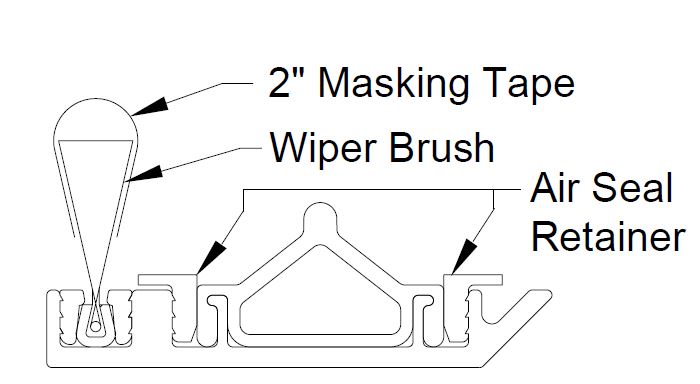

I’d be interested in a discussion on the viability (or not) of abandoning the inflatable rubber seal that surrounds the slide on my LXi. My inflatable seal is in good working order presently but I’m sure that sometime in the future it will need to be replaced. This is a fairly large and expensive job.

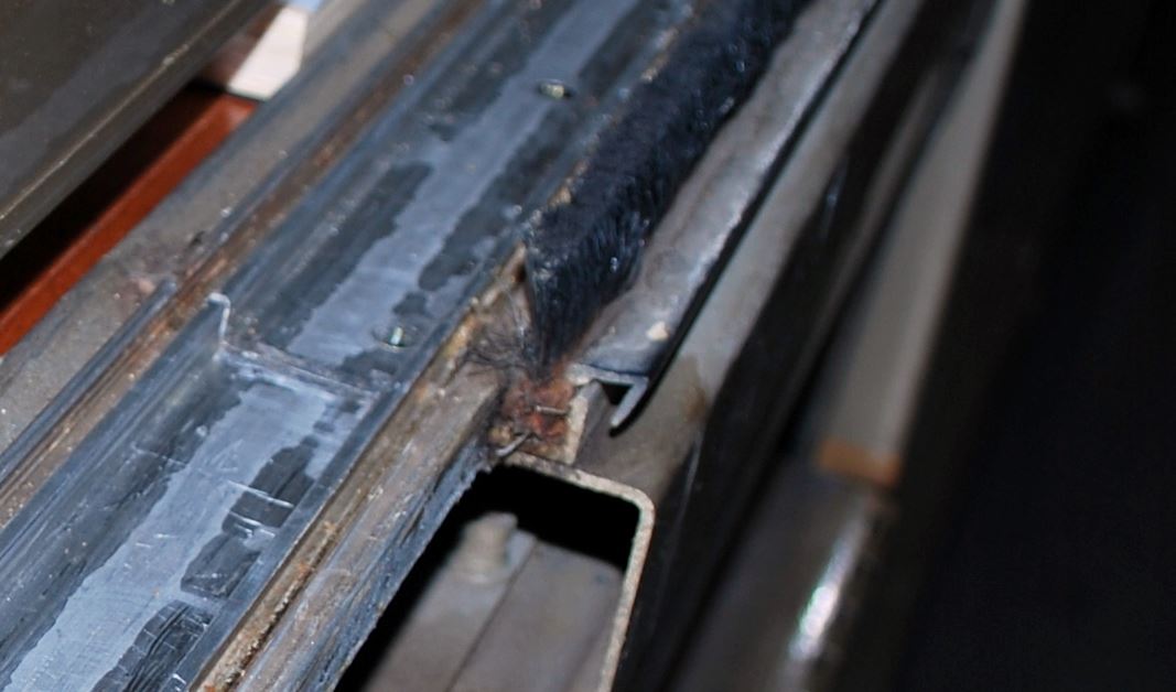

The HWH slide is fitted with a brush wiper attached to the walls of the slide opening. It is located about an inch inside the slide opening behind the corner trim piece. This brush wiper circumnavigates the slide and is designed to clear debris off the outer walls of the slide particularly during the retraction process.
There is also a hard vinyl trim piece that is fitted to the corner of the slide opening. It also circumnavigates the entire slide opening.
Since I have not had the opportunity to view these two parts without the slide being present, it’s difficult to determine if they are attached to each other, one complete piece or are two separate pieces. At any rate, why could not the brush portion be replaced with a solid silicone rubber wiper/seal? This wiper/seal would be attached in the same manner as the current brush seal and sized so the leading edge or edges would contact the slide walls and act as a seal. Made of soft silicone rubber, it shouldn’t damage the painted surface of the slide during movement.
This may not provide an absolute water seal as well as the current inflatable seal but designed correctly it should suffice to keep water out and air noise to a minimum due to it being located so close to the outside vertical sidewalls of the bus.
Comments welcome………….
03-31-2015, 16:16 (This post was last modified: 03-31-2015 17:18 by travelite.)
RE: Slide Seal Alternative
Hi Chuck,
Here's what it looks like:
I think you can get the DRI seal for around $500 or $12.50 per foot. I imagine if you shop around you can probably find a bulb-style seal for around $5 to $10 per foot depending upon the quality of the material. If it's silicon it'll probably be closer to $10 making the cost delta hard to justify. I'm also thinking that the constant abrasion will eventually do a number to your paint job. This is the case with the factory Prevost slides. Prevost uses a rubber wiper to remove debris as you describe and the slide body paint really shows it.

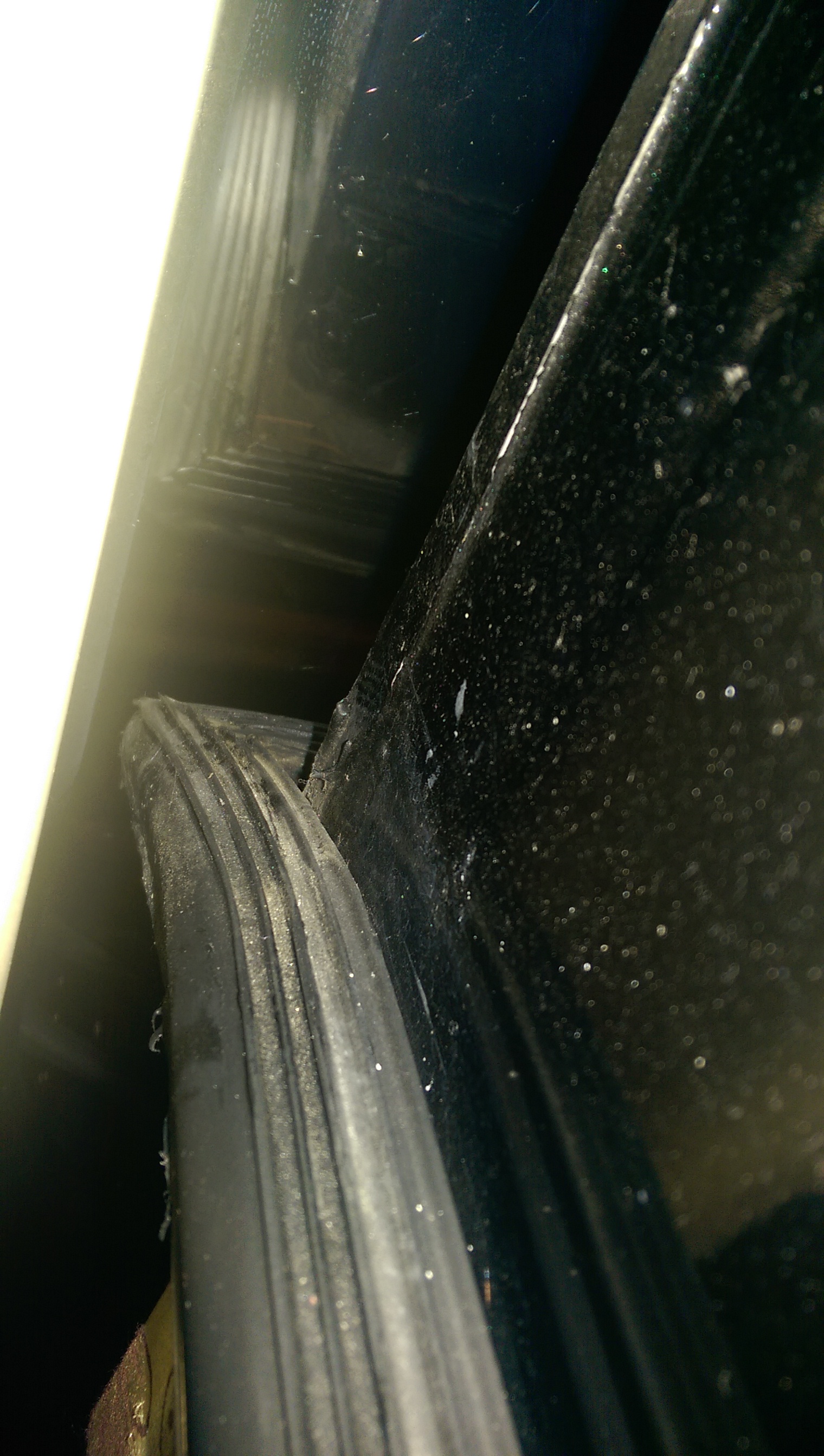

Here's the bulb seal used on my Vantare:
It's a fairly large cross-section seal, approximately 1.5"x1.5". The seal for retraction is mounted to the exterior body. The seal for extension is mounted to the interior slide flange. The pics above are the seals for extension taken from inside the coach. They don't get fully compressed. There are bump stops at the top of the slide that allow for partial compression of the seal. I think this gives a better seal and allows for a longer lifetime (no pancaking of the seal).
I agree that the flangeless slide bodies look better, but I think function overrides form here. We don't hear too much about M450 slide seal issues. Replacing a set of air seals on a factory Prevost slide is about $4K per seal. I have to confess, I'm a convert.
I like your idea. I think you'd want to simulate a flange of sorts, and few things seal better than rubber on rubber. There's actually a metal trim strip that's screwed to the outer and inner circumference of the LXi slide body. Maybe with some ingenuity it can be converted to a small flange.
