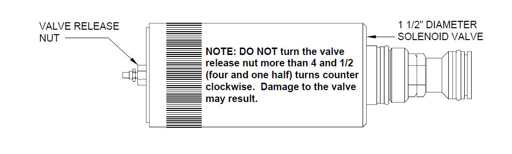

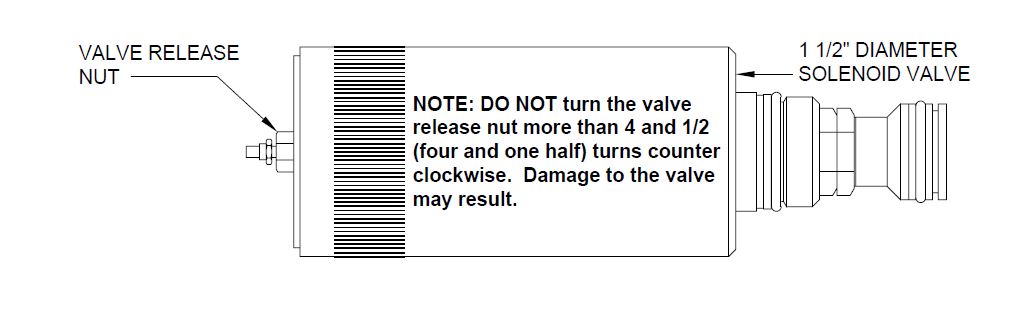

09-17-2015, 12:18
RE: HWH Jacks will not retract
Look closely at the one you think is sheared. Does it look like this?
If so, this is a different style solenoid valve which has a nut instead of the T-handler. david brady, '02 Wanderlodge LXi 'Smokey' (Sold), '04 Prevost H3 Vantare 'SpongeBob' "I don't like being wrong, but I really hate being right" |
09-17-2015, 12:22
(This post was last modified: 09-17-2015 12:23 by cruisergeek.)
No, it is definitely sheared, it has witness of an angular break, like it was struck with something, and not enough of it remains to get any sort of tool on, is is pretty much flush....is there another location i can bleed from, perhaps cracking a line loose somewhere?

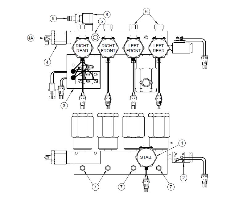

09-17-2015, 13:00
Hi Cruisergeek,
You might try this before removing lines. There's a pressure switch on the side of the HWH manifold. It's number 2 in this picture, but this pic may not be representative of what's on your LXi. Find the pigtail and disconnect it from the pressure switch and try again. david brady, '02 Wanderlodge LXi 'Smokey' (Sold), '04 Prevost H3 Vantare 'SpongeBob' "I don't like being wrong, but I really hate being right" |
