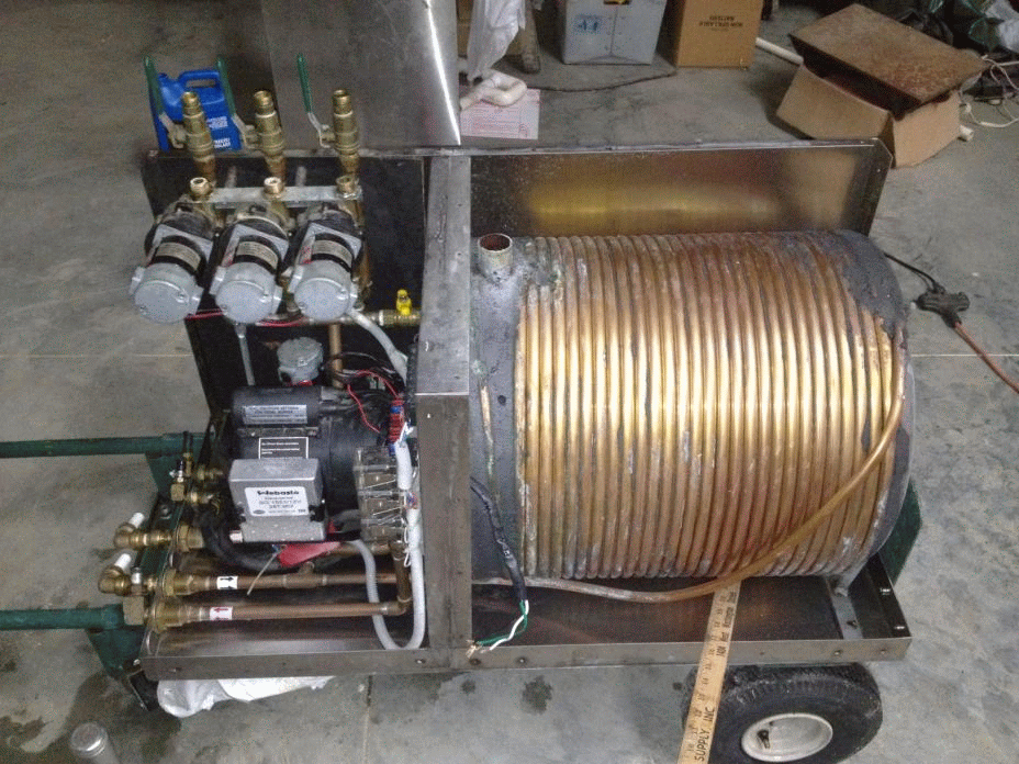

I agree Al, the domestic water loop is the crucial component as shown here:
I don't know of any easy way to be able to test for integrity unless there's an outright failure, in which case there will be a large puddle of water under the bus! However, faced with a loop failure I'd definitely re-loop it! It's been done before with success. The other common failure point, but much easier to fix, is a leak at the filler neck at the top of the tank. Tank leaks are easily found using a radiator pressurization pump which can be rented from Autozone or any of the other automotive supply store chains. I talked about my filler neck repair in this thread: http://www.wanderlodgegurus.com/showthread.php?tid=201 david brady, '02 Wanderlodge LXi 'Smokey' (Sold), '04 Prevost H3 Vantare 'SpongeBob' "I don't like being wrong, but I really hate being right" |

Great Pic David, the next issue would be the insulation jacket around the coil , has that been found ? I would also think that 20 years in a AH , one should be thinking about the coli; replacement

Al, I'd use a closed cell melamine and I'd just wrap blankets of the stuff around the tank. Other's have used other materials and have had good success. I think the important thing is that it not become water logged. Melamine is what I used in my engine compartment on my LXi. It stands up to the weather and it doesn't ignite. I took a propane torch to a sample and I couldn't ignite it.

Sorry Al, that's not my AH. That's a stock pic I had lying around. For the insulation I'd wrap the boiler loosely and tape it off; for the copper domestic loop I'm sure we could find some conductive paste somewhere. Wrapping a new loop could be fun. Maybe fashion up a roundabout or carousel, attach the boiler to the center, have some friends spin it while a couple more feed in the copper tubing. Serve plenty of beer and wine!
