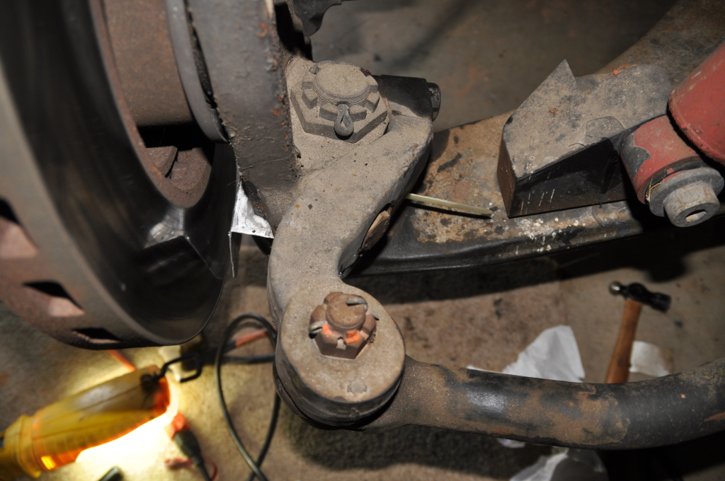

FYI,
If you install a new boot consider a heat shield. A few suspensions had a heat shield for the boot. Ed and I made one up from aluminum. Glued it to the A frame. Not fancy , but still there after 2 years. Sorry, poor pix. Looking for a better one and a sketch. Ross MacKillop Wiarton Ontario 2006 450 Lxi |
