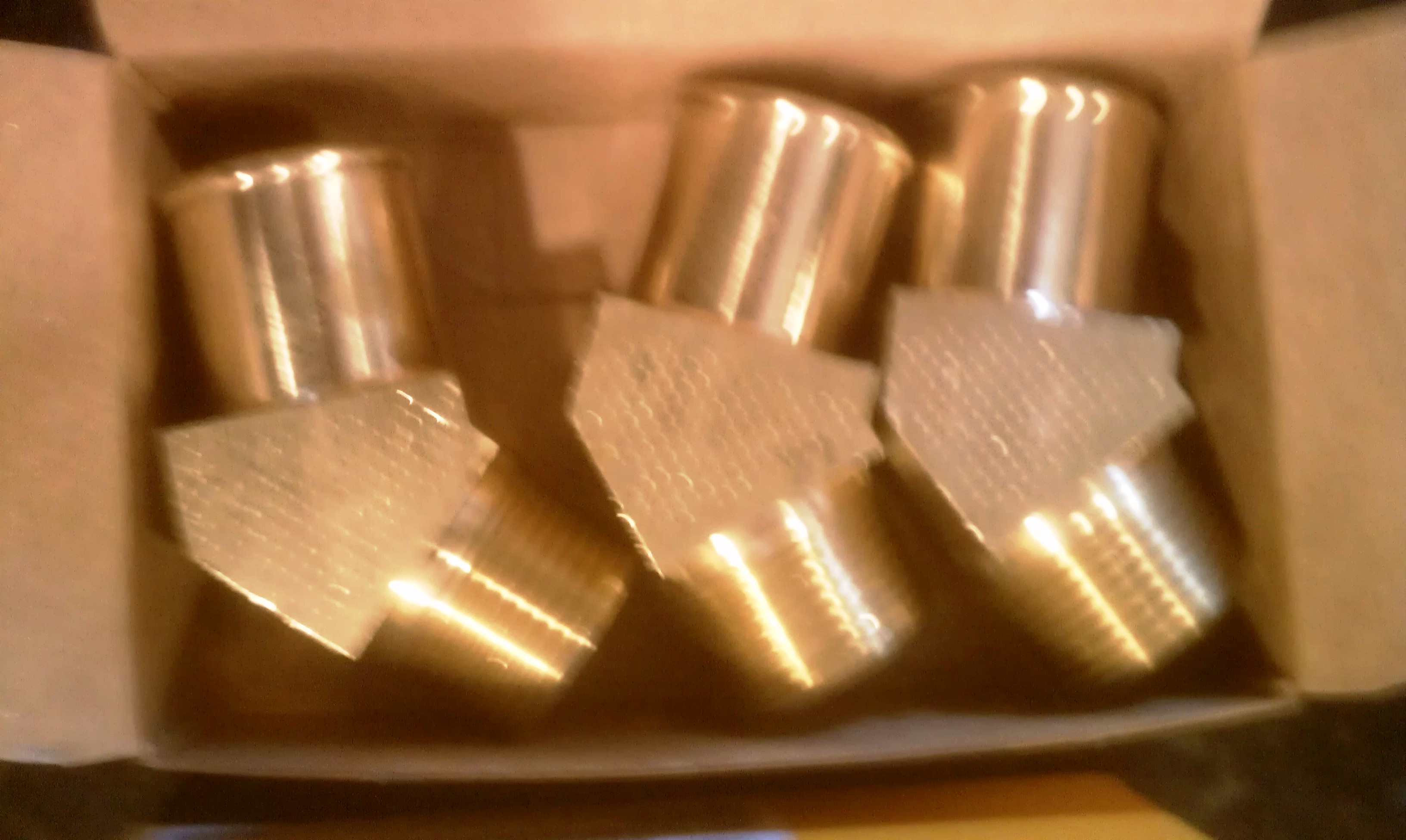

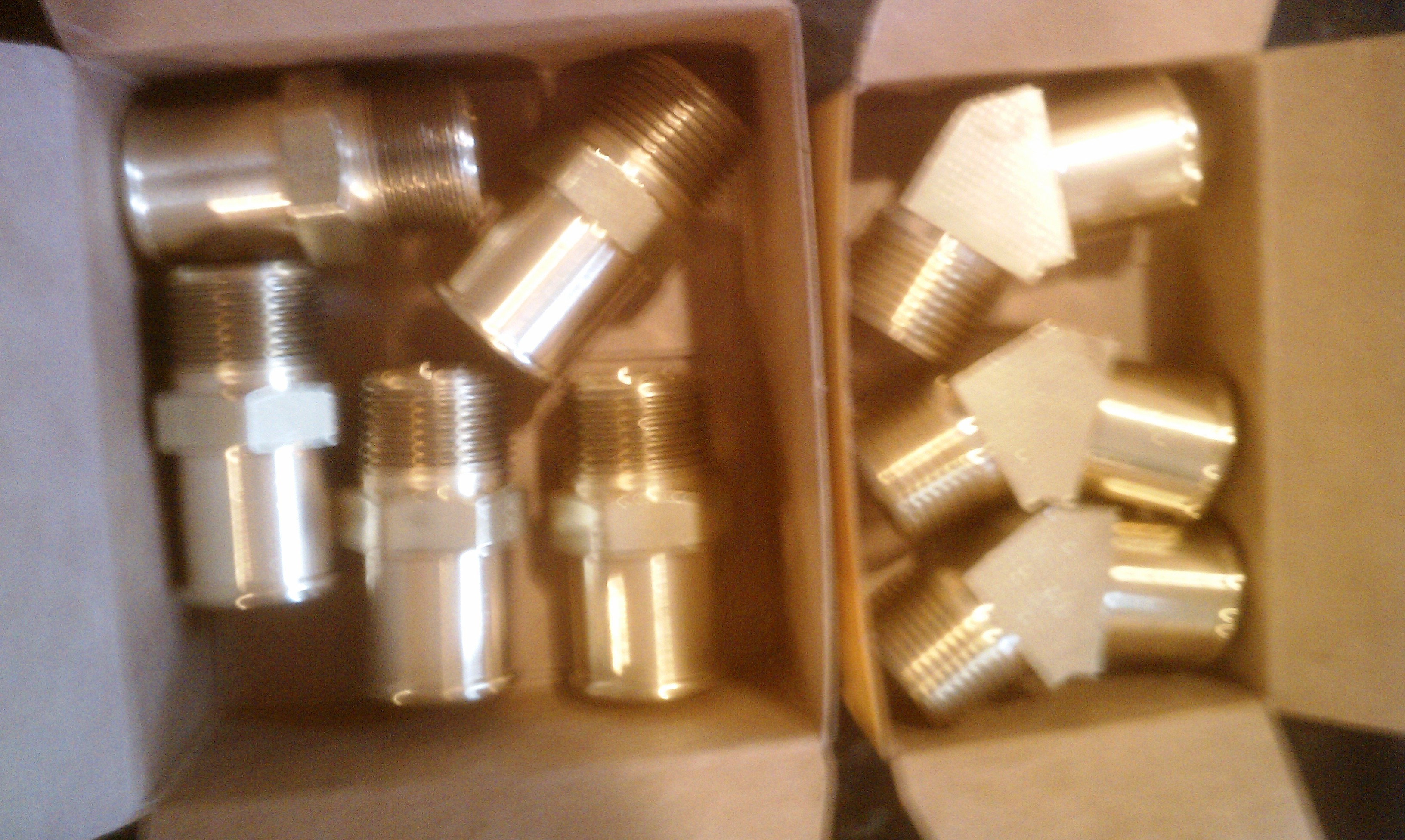

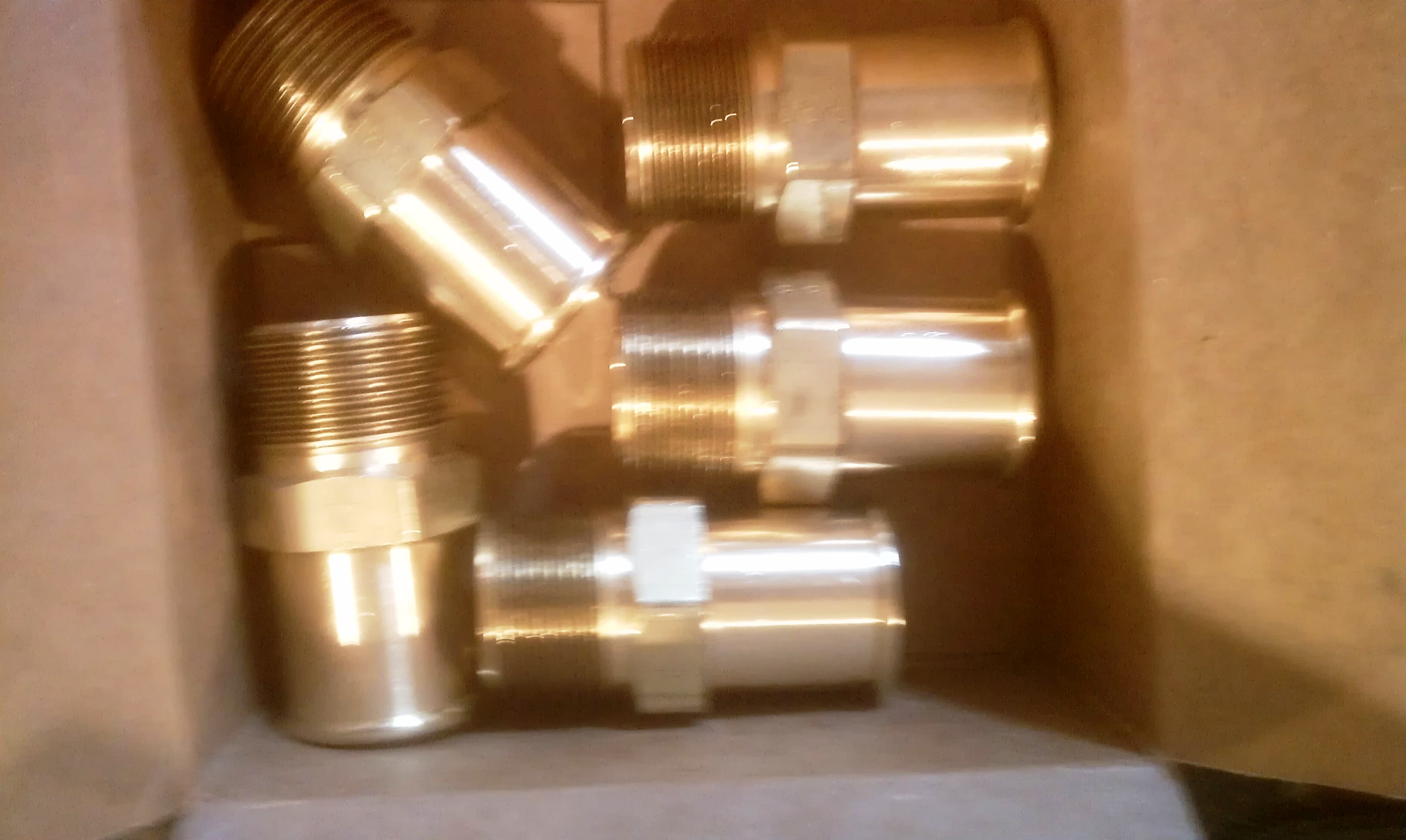

Back on track here, politics aside.....I decided how I'm replacing the stock "piping". I got Parker brass ball valves, as well as Parker brass water nipples, both in straight and 45 degree setup (see pictures). Then for the 90 degree elbows I will use cast iron for strength purposes. Mostly out of the block into the ball valves. Some of the ball valves are male threaded on one side and female threaded on the other side. That will save yet another connection (close nipple). The less connections I figured, the fewer leak points. I bought the Parker products online at http://www.mrostop.com. Arrived promptly.

03-01-2013, 17:40 (This post was last modified: 03-01-2013 17:43 by davidbrady.)
RE: chassis heater plumbing in engine bay
That's pretty stuff Markus - way to go! Thanks for the tip on the vendor and the pics! Smile
